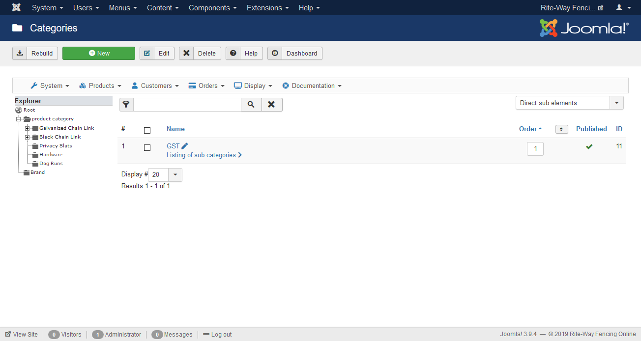

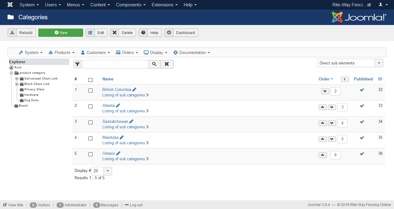

I'm trying to set up taxes for five different provinces in Canada, but I can't seem to figure out the way taxes work.
I've set up the zones for taxes, and I've created the taxes as sub items of the default tax. But I can't assign more than one type of tax per product (they all need to be able to be taxed at the rate of the province they are purchased in), and when I test the check out process, I get the default tax rate.
What, step by step, do I need to do to ensure that taxes for all products are calculated based on the billing address?

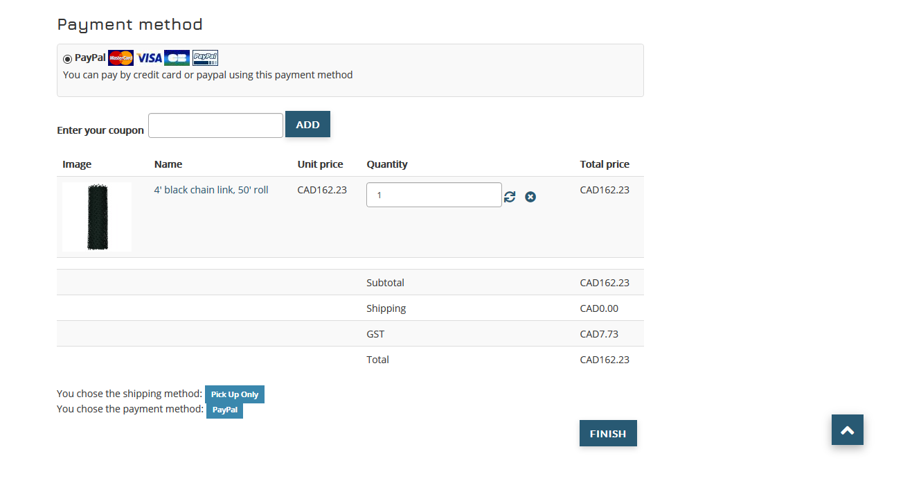

Thanks for the reply, BUT it's already set up that way, and it's still only adding GST to all sales, even in BC, where the tax rate is 5% GST, and 7% PST. So that's not working.
Also, more worryingly, the tax calculation seems to be wrong. A product costing 162.23 has GST (which is set at 5%) as 7.73. That's not five percent.

Also, the tax amount is correct. So I don't know how you make your calculations but it's your calculations that are wrong.
If the total with taxes is 162.23 and you have a 5% tax rate, it means that the amount without taxes is 154.50. 154.50*5% = 7.23 which is what the amount it on your screenshot.

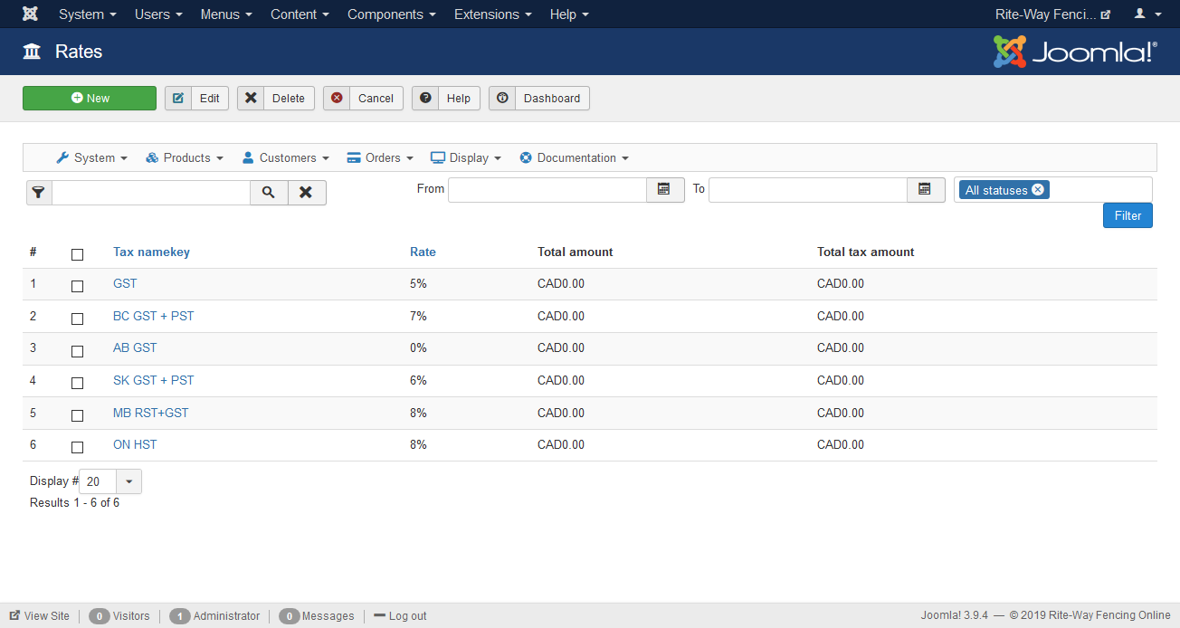

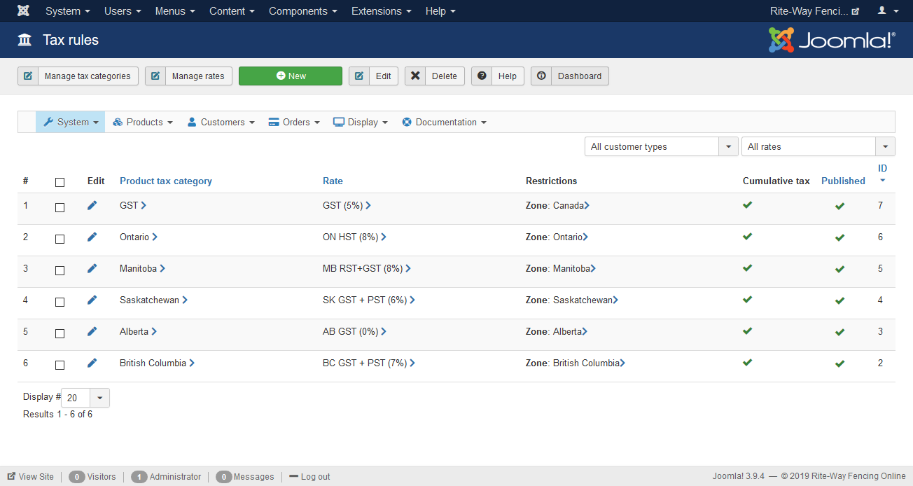

Here are the screenshots.
I'm not certain if these are the only ones related to tax, since I don't understand how your system works. So feel free to mention other settings, and I'll tell you if they are configured, and how.

You need to have one tax category, select it in your product and then create several tax rules for that tax category.
However, in your screenshots, I can see that your tax rules are assigned to different tax categories. So since your product it assigned to only one tax category, only one tax rule can apply to it.
You need to modify your tax rules so that they all use the same tax category which is selected in the product.
Then, you'll see that several tax rules can apply to the same product at the same time.
The rest of your taxes setup is correct.
