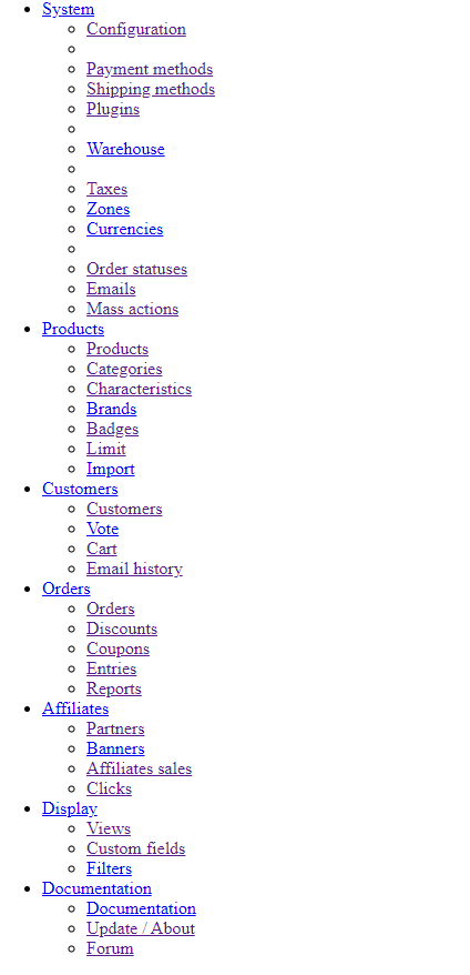

When editing tax rate I get strange admin and cant edit tax rate (manage rates). I need urgent tax change on 1.1.2020.

First, your strange backend screen means you have an error somewhere, in order to get where is this issue, can you :
1. Go in your System dropdown => Global Configuration
2. Then in System tab, switch on Yes the Debug System
3. And in the Server tab, define the Error Reporting on Development.
For the other part of your message, we can't recommend you to modify some value directly in the database because it can leads to multiple and collateral effects unfortunately...

Fatal error: Allowed memory size of 33554432 bytes exhausted (tried to allocate 20480 bytes) in /home/xy/public_html/administrator/components/com_hikashop/helpers/helper.php on line 1637
