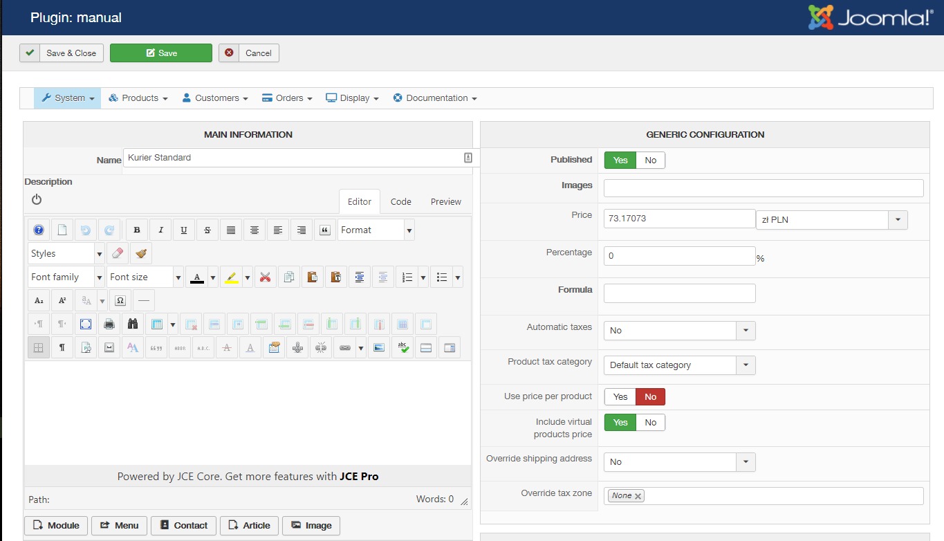

Now total VAT shown is 46 euro, and we want to have 69 euro. Is it possible without much coding? I attach my setting for this shipment.

5 years 9 months ago #327612
In real store I have set net shipping price 73,17 (as on previous attachment), the tax is 23%, which make the gross price 90.
In the frontend the client sees 90, which is correct. So it tells that my taxes are correctly configured.
I just would like to have the VAT (16,83) to be added to total VAT on PDF invoice. And show the net shipping price there (without tax). Is it possible? I will send you access via private message, as Phillip in other forum thread has just asked for it, maybe you could take a look.

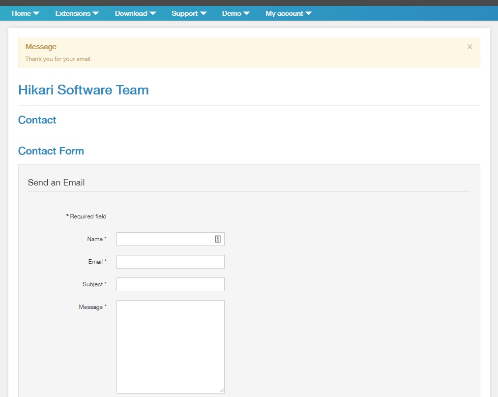

5 years 9 months ago #327649
OK, I just sent the access once again, can you see if you received it? I attach a small confirmation
