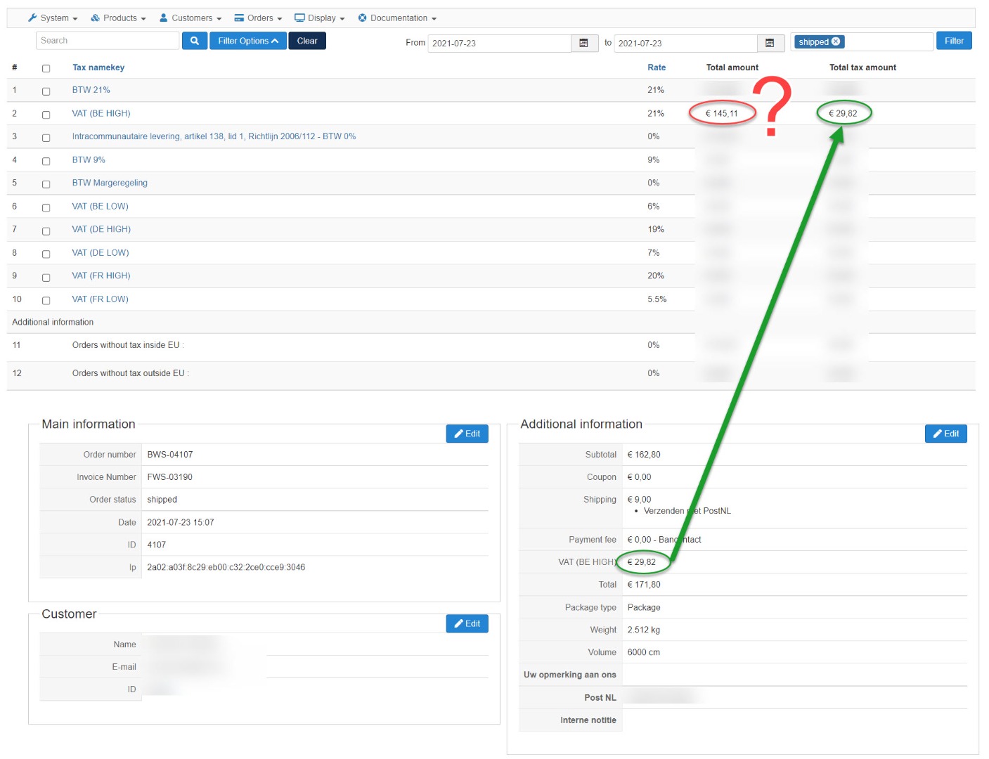

5 years 2 months ago - 5 years 1 month ago #335400 by Lumiga
-- Joomla version -- : 3.10.1
-- PHP version -- : 7.x
Hi Support,
See the TAX rates overview for July, there is only one order with 9% VAT.
But when you look at the order you see difference in the order and in the TAX rates overview.
Is this a bug?
We have this same issue with all 21% VAT rates.
Screenshot
Hope you can take a look
UPDATE: 21-10-2021 Please fix this issue!

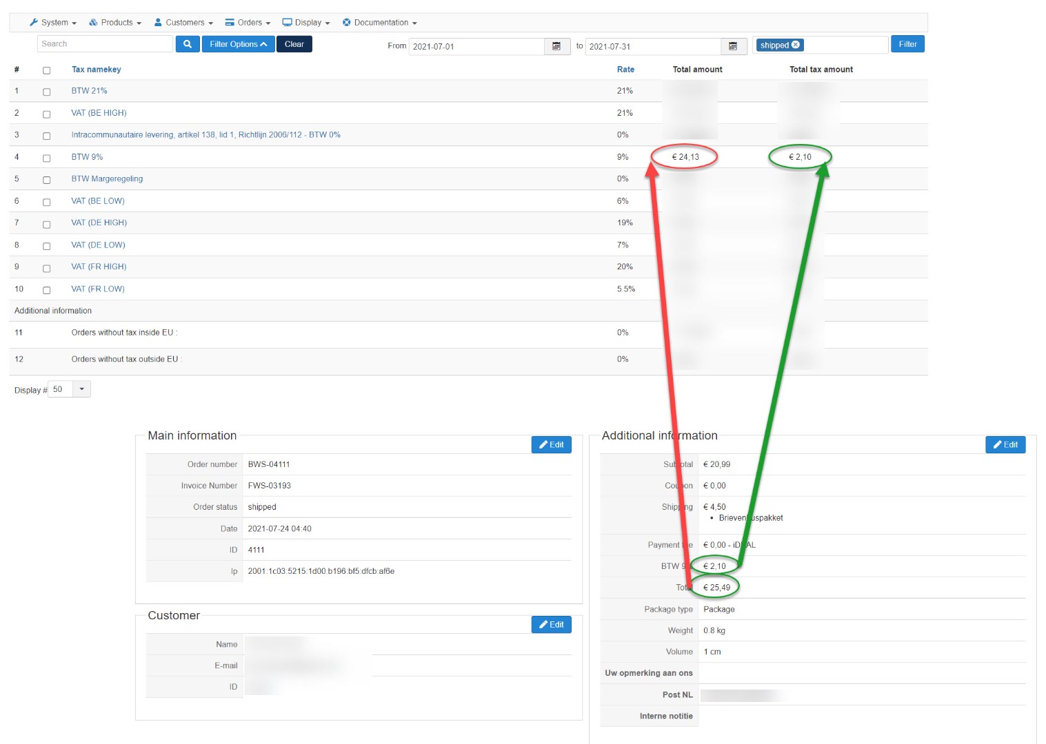

5 years 2 months ago #335407 by Lumiga
Same issue with 21%
Kind regards,
Lumiga

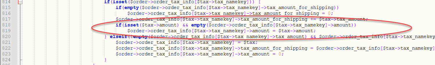

5 years 2 months ago #335869 by nicolas
Sorry for the delay.
I've looked at the issue.
I think that this is a side effect of the code modification I made to better handle orders with 0% taxes.
One of the changes I had made for that was to add the code:
Code:
if(isset($tax->amount)) $order->order_tax_info[$tax->tax_namekey]->amount += $tax->amount;
in the file administrator/components/com_hikashop/classes/order.php
This lead to the tax amount containing twice the shipping fee when the order didn't had a 0% tax.
I propose to change that code to:
Code:
if(isset($tax->amount) && empty($order->order_tax_info[$tax->tax_namekey]->amount)) $order->order_tax_info[$tax->tax_namekey]->amount = $tax->amount;
That way, it will only set the amount from the shipping if there isn't already an amount. That should hopefully fix the issue for newer orders going forward.
Could you try this out ?
