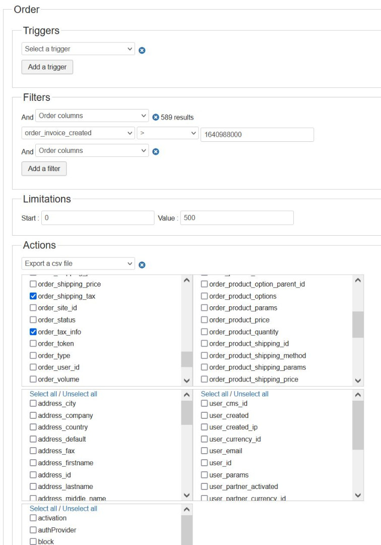

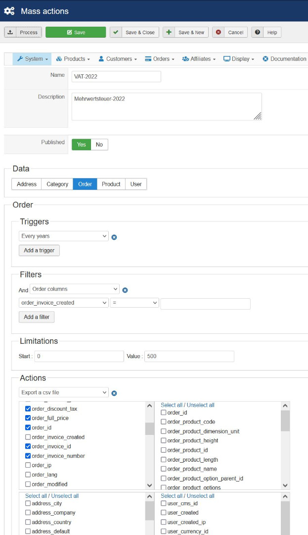

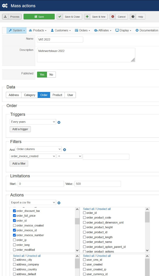

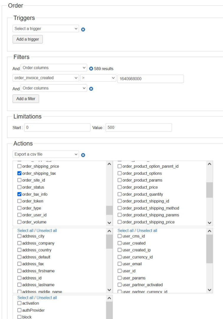

If you want the orders data, you'll want to have several filters in your mass action:
- on the order_status column in REGEX mode with something like (confirmed|shipped) as value
- on the order_invoice_created with a >= and the value being the timestamp of the 1st of january at 00h00:00 : www.unixtimestamp.com/
- on the order_invoice_created with a <= and the value being the timestamp of the 31st of December at 23h59:59

"- on the order_status column in REGEX mode with something like (confirmed|shipped) as value
- on the order_invoice_created with a <= and the value being the timestamp of the 31st of December at 23h59:59"
I was too stupid to parameterize. I cannot define the end date, no values to chose from ...
Sorry for stupid questions.

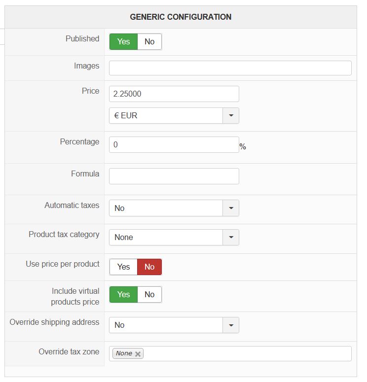

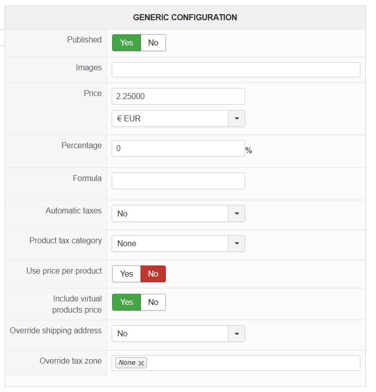

For your first point :
"...The Total amount is not exactly corresponding with the Tax amount. I.e. it looks like the "Total amount" is the total amount of the invoices and seems to contain transport cost which is free of VAT. Could this be the case?"
This will depend from your different settings around taxes but one important things if all your shipping method are free (and not free of VAT) then there are no impact on your VAT calculation.
Now, if your shipping method aren't free AND all your Shipping method is set like on my screenshot :
In your shipping method form => GENERIC CONFIGURATION part
image missing https://i.ibb.co/jHFPz7z/screenshot.png
=> There are no reason that it impact the VAT total.
Can you investigate more in order to maybe find a good reason for your results, settings & re-check your VAT calculation.
Awaiting your results.

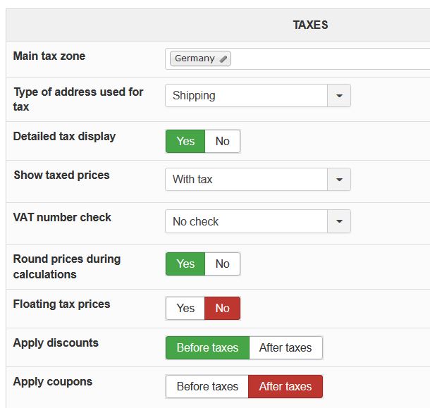

3 years 6 months ago - 3 years 6 months ago #351190
by Philip
Replied by Philip on topic How to extract VAT receivec from the Shop Data?
Sorry for this return but in this post ( here ) we show that you have to check in your Shipping method configuration, but what you show us and your taxes part configuration in the main part of the HikaShop configuration.
Can you check all your shipping method, from System dropdown => Shipping Method
Last edit: 3 years 6 months ago by Philip.

3 years 6 months ago #351245
by nicolas
Replied by nicolas on topic How to extract VAT receivec from the Shop Data?
Then the total amount shouldn't take into account the shipping costs.
Supposing that the tax information of the orders are correctly filled when the orders are created, the system will only use the amount that was taxed for the total amount, and thus it won't include the shipping costs.
