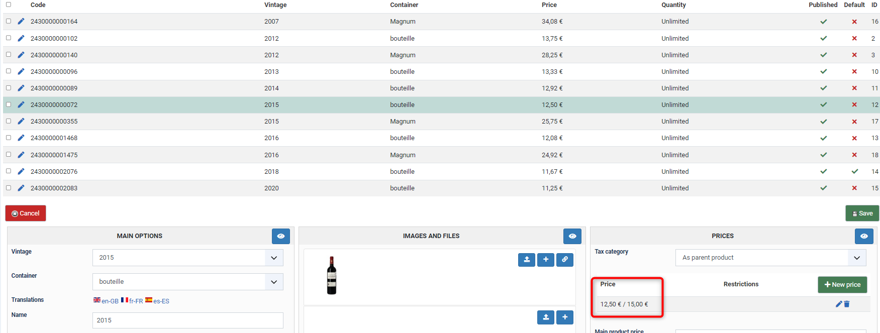

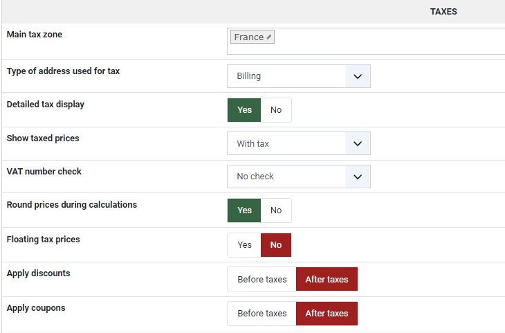

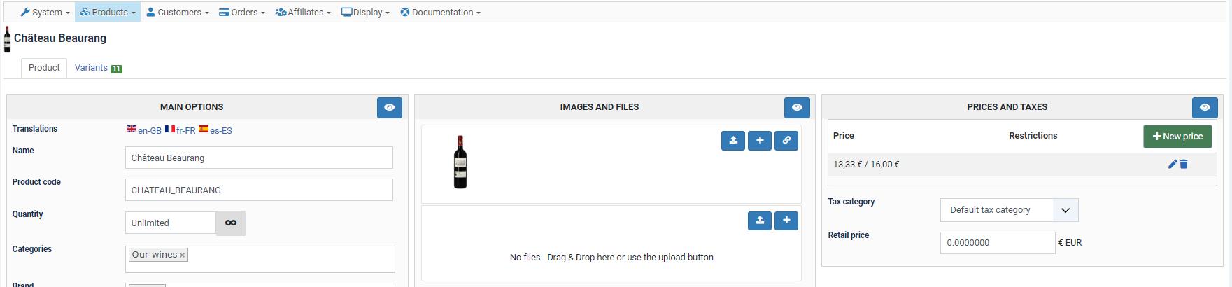

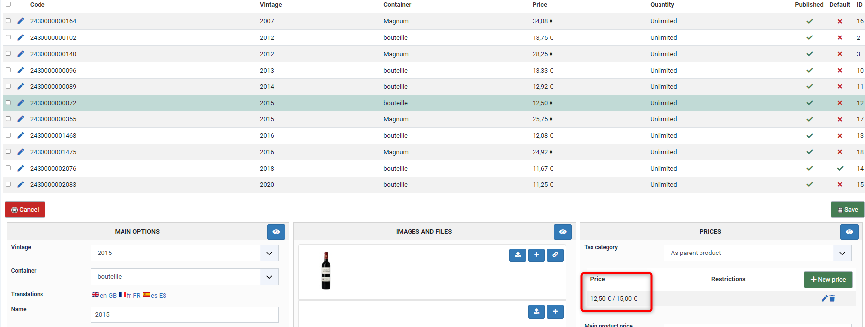

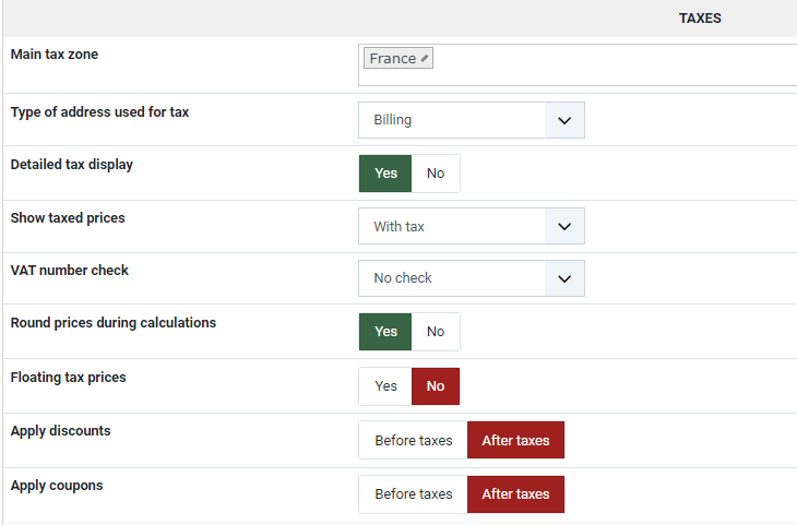

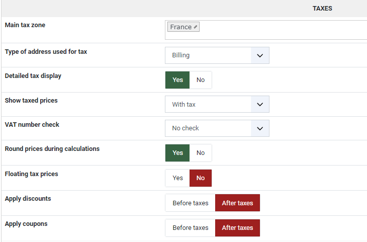

When a customer buys a product on this site, he is not subject to VAT if his address is outside France. I've checked all the settings in the general configuration, see below

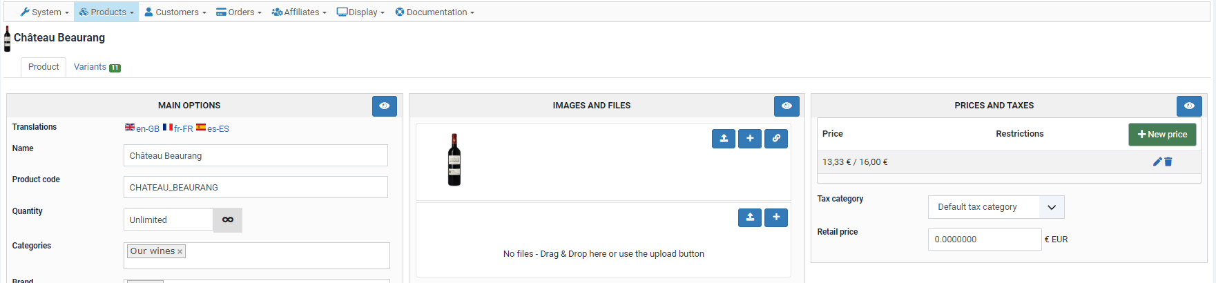

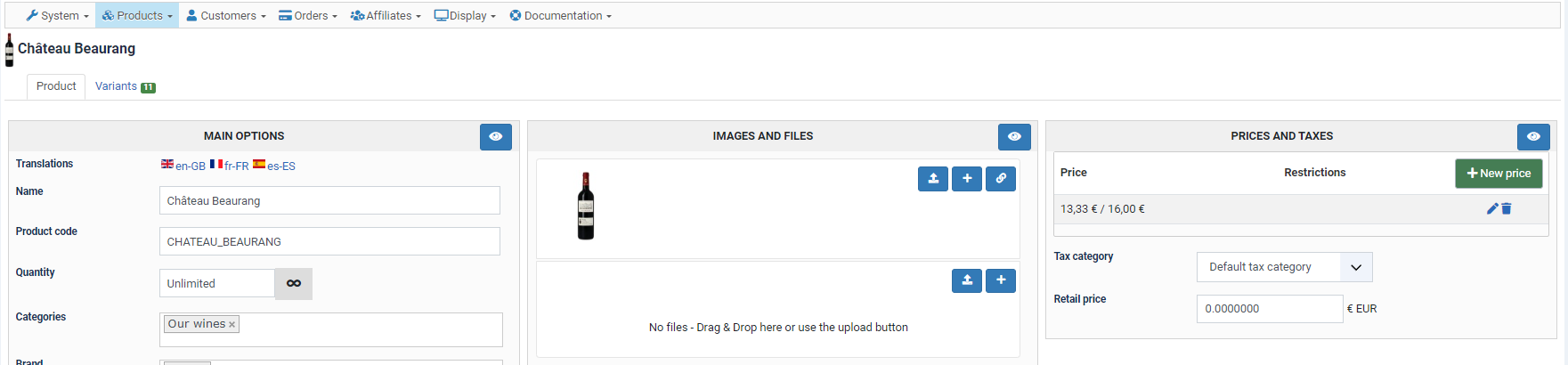

On the product, see below
and on variant, see below

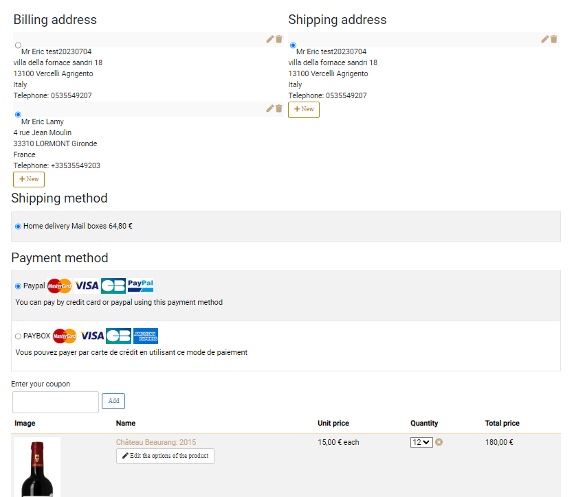

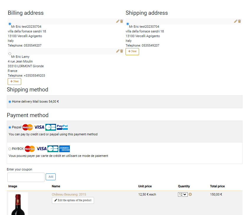

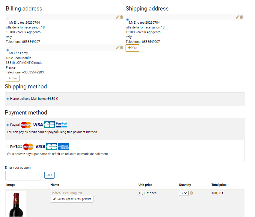

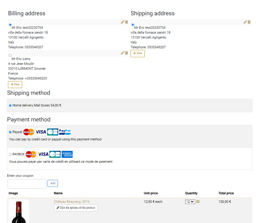

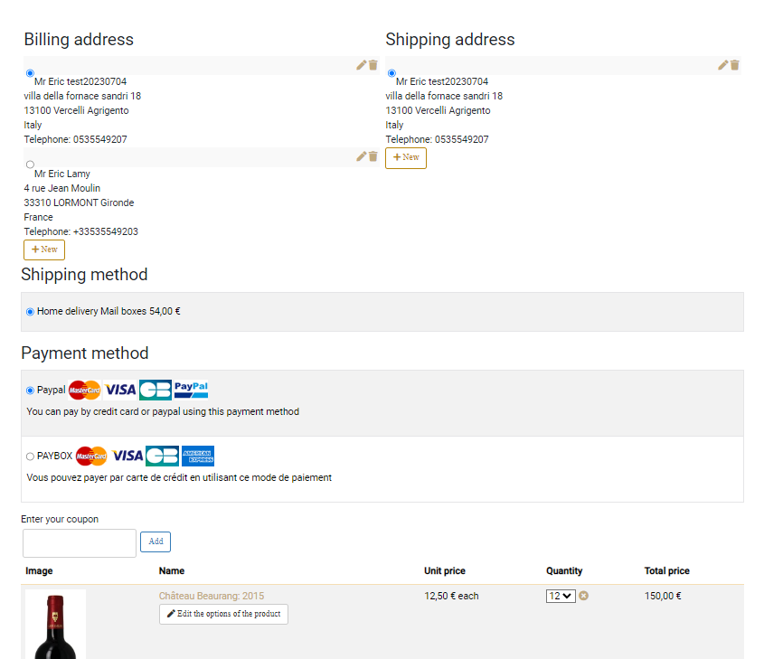

But if i go on front end and I want to make te checkout, is it without VAT for an italian address, see below

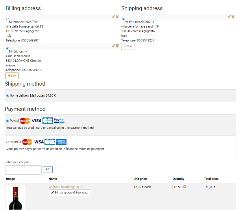

And with VAT for a french address, see below

You need to check your tax rules in the menu System>Taxes of HikaShop. There, you must have a tax rule configured with France selected in the "zone" setting of the tax rule, which limits the tax to only users located in France. If you want the tax to be included regardless of the address of the customer, you want to leave the zone setting of your tax rule empty.
I would recommend you to check with your accountant on what tax should be taken for which country. Based on where the products are shipped, and what type of products they are, it could change a lot...
For example, on our website, the tax rate is different for each country in the European Union, and users outside the EU are not taxed.
