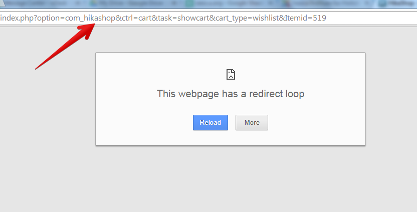

  • Posts: 162
11 years 10 months ago #173072
I've changed the code and now when I try to load the wishlist page I get a redirect loop.
Please see screenshot.
thanks!
11 years 10 months ago #173085
Yes indeed that's not correct, after verification the code you found is in the wrong function and for the wrong thing.
Thanks to add:
