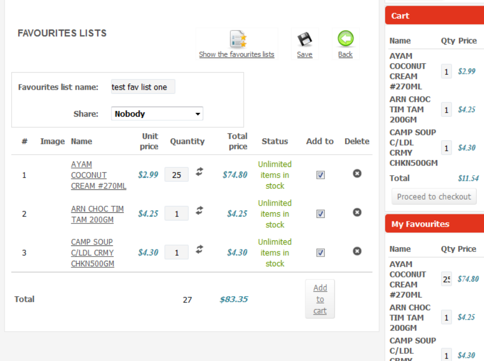

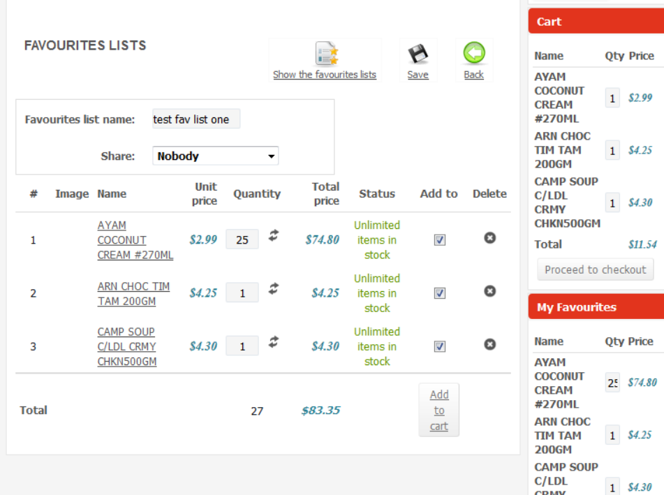

-- HikaShop version -- : Business: 2.3.5
When a customer views a wishlist and ticks the check box then adds it to cart. The quantity of each item added to the cart is 1 for every item and not the quantity for each product as listed in the wish list. How can that be changed so the quantity added to the cart is the same as listed in the wishlist.

  • Posts: 18
11 years 7 months ago #186786
Not I did not edit the view and get the same problem.The only thing edited for this view is language files.
What I actually want to do is replace the tick boxes with a button to add the quantity to cart for each item the same as when browsing categories. Can that be done? This would be a good admin option to switch between multiple product add to cart or single product add to cart in wishlist view.

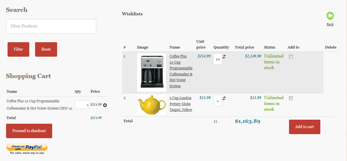

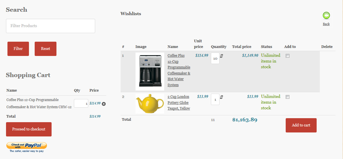

I have the same issue where the wishlist only adds 1 item at a time to cart.
On the demo it appears that you can update quanitity that you want to add to cart.
For example, the user is not able to choose 2 or 10 of coffee pot?. See attached.
I posted here because I noticed you fixed code for someone who had an over-ride on "cart / showcart". So, before I posted I deleted my over-ride and re-installed hikashop. That did not change anything.
Thank you for your time
