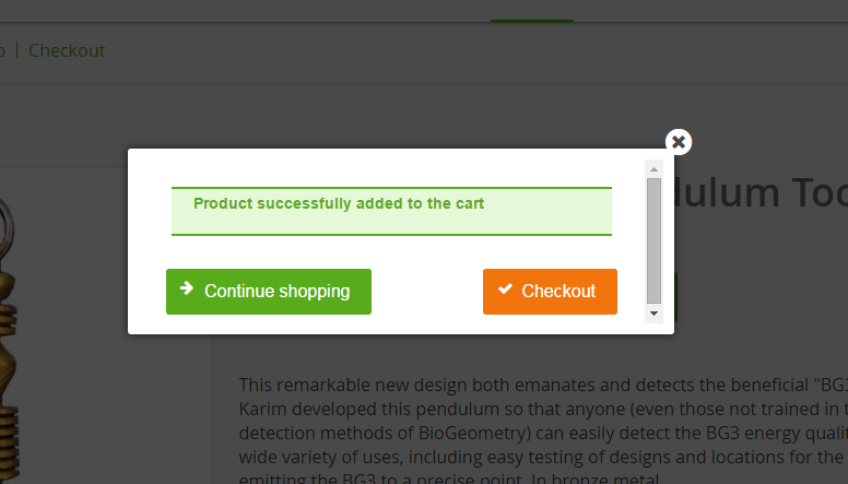

I've disabled Joomla cache. There's no other caching method on the website and the wishlist is working now, but with the same bug mentioned above: If I have a product in the cart and I add another one to the wishlist the product in the cart is removed.
I also get "the product was added to the cart" pop-up like in the screenshot. How can I change it for the wishlist to say: "The product was added to the wishlist"?

11 years 4 months ago #199613
Problem solved, we indeed had an issue in our code.
You seem to have a specific configuration, that's why we didn't had this report yet and in some rare cases the issue can be present.
Thanks for the report.

We have a new problem now, after the fix, the pop-up window doesn't work correctly for "Add to cart" button, sometimes it displays and sometimes doesn't display at all . When it displays is displaying instead of "Product successfully added to cart", "Product successfully added to the wishlist". It only works for "Add to wishlist" button. On IE doesn't work at all for any of the 2 buttons "Add to cart" or "Add to Wishlist".
All cache is disabled. There's no caching at all.
thanks for helping us!
11 years 4 months ago #199826
Problem solved too ;)
We will improve the code on our end too thanks to this fix.
