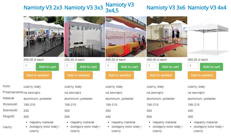

In the comparison page I see Add to wishlist buttons altough Wishlist option is globally disabled in Configuration->Functions->Main

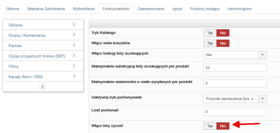

8 years 11 months ago #278696
Yes, it's disabled, I attach the screen from my options.

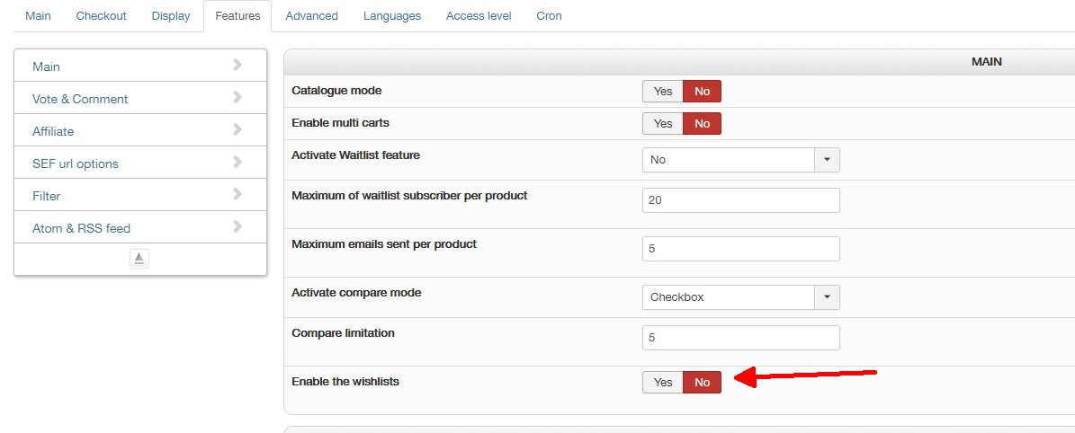

8 years 11 months ago #278822
OK, I attach the screenshot in english. I will send you right now the link via PM.

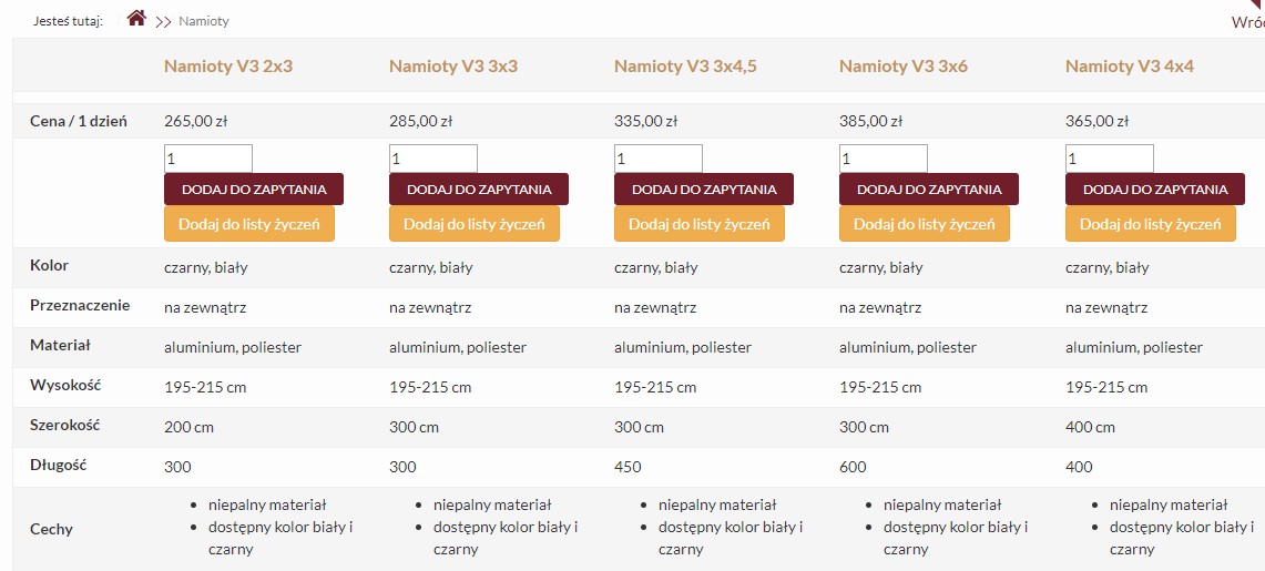

8 years 11 months ago #278905
I switched to protostar and the button is still there. Prostar has no overrides for Hikashop, so the bug really exists. I attach the screen.

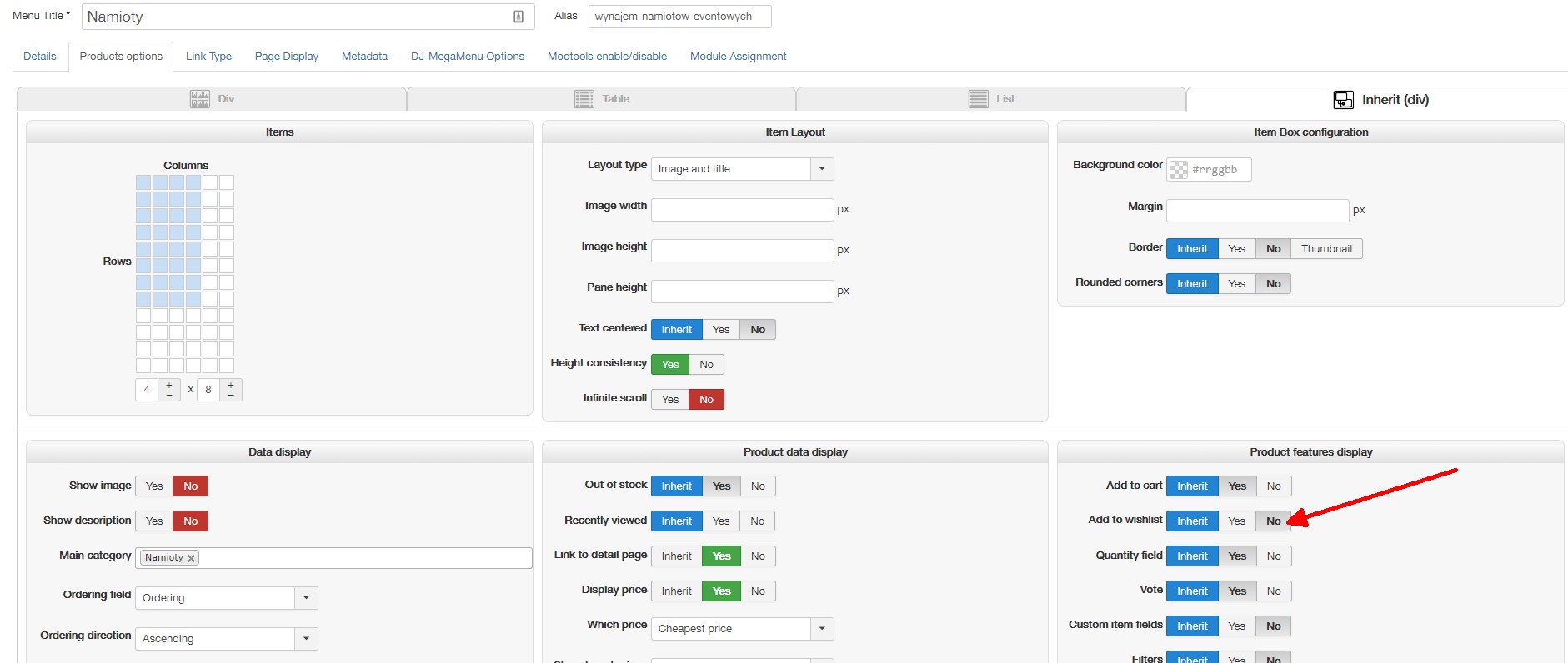

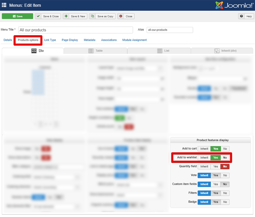

I see from your screenshot that your view is an Item menu (or a module ?) did you check its specific configuration, see my screenshot :
In Menus => Main Menu OR Extensions => Modules, go to Products options tab
Here, the general is set like you to No, but I'm able to display the button on the whishlist thanks to this option in needed Item menu.
Hope this will help you.
