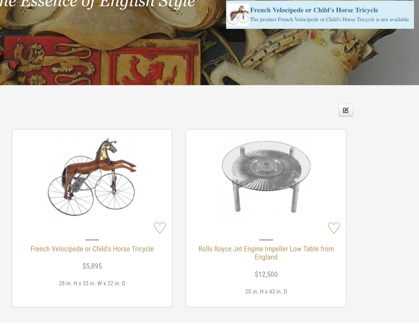

I'm workin in catalog mode for a site and the wishlist does not seem to work as expected.
As a logged in user, when I try to add a product to the wishlist it says that product is not available.
I have customized a bit the add to wishlist button to use this code in product view:
Which looks ok to me as far as I can see in your Demo.
I have checked that the products have stock and even setting stock to "Unlimited", they cannot be added.
Can you please let me know where I should look next? I cannot find why the products are not being added to the wishlist.
Thanks!!

9 years 5 days ago #282516
by nicolas
Replied by nicolas on topic Wishlist not adding products
It would be great if you could provide a test user account in such cases so that we can directly analyze the situation.
Right now, I can only provide some vague guidance. If you activate the display of the add to wishlist button (so that HikaShop displays its own button) do you see the button and does it work ?
Also, you're using the variable $this->element, but on a products listing, the data of the product is available in $this->row and not $this->element. Maybe that would explain why you get that error as the id you give is not the correct one ?

8 years 11 months ago - 8 years 11 months ago #282938
by karendunne
Replied by karendunne on topic Wishlist not adding products
thank you very much for your reply!
I'm afraid it didn't help that much:
No, it has exactly the same behaviour.
No, I'm using the code shown for Product View, for Product DETAIL view

8 years 11 months ago #282978
by nicolas
From hat I can see, the issue is that you've deactivated the "Display 'add to cart' button for free products" setting in the HikaShop configuration, and that you didn't configure any price in the prices listing of the product (which you've actually removed from the product edition screen).
If I turn on that option, then it works fine.
