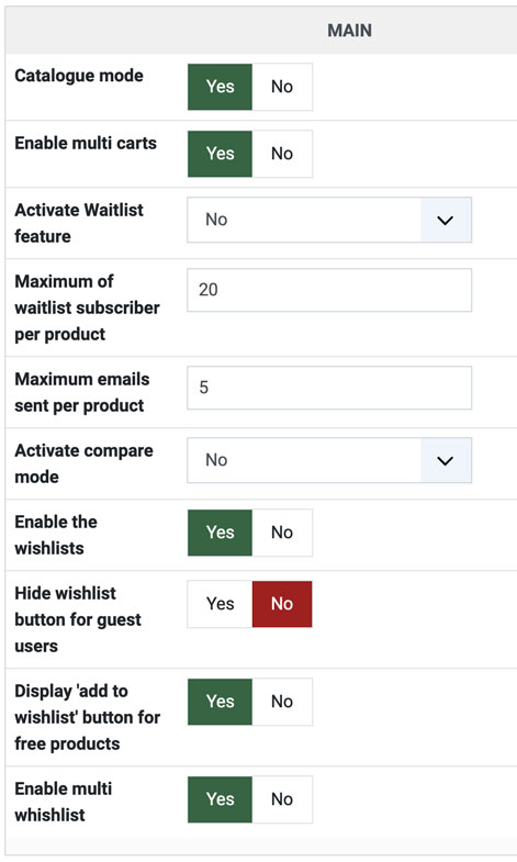

If you have the enable multiple cart or the enable multiple wishlist settings turned off, then these menu items will direct to the control panel instead. So I suppose that it's what's going on here.
4 years 6 months ago - 4 years 6 months ago #341968 by lousyfool
nicolas wrote: If you have the enable multiple cart or the enable multiple wishlist settings turned off, then these menu items will direct to the control panel instead. So I suppose that it's what's going on here.
As I said in my initial post, all the time I had and have "Enable the wishlists", "Enable multi whishlist" and "Display 'add to wishlist' button for free products"turned on. But not the "Enable multi carts", because I sure hadn't guessed that this is necessary, too, though I know that technically wishlists are also carts.
[strike]You said, "enable multiple cart or the enable multiple wishlist", but just by chance I figured it must be "and":[/strike] EDIT: Correction -- reading your sentence again, I now understand: only when turning on both "Enable multi carts" and "Enable multi whishlist" as well, something other than the cPanel appears. Not very intuitive and AFAIK nowhere explained, but now I do know, haha.

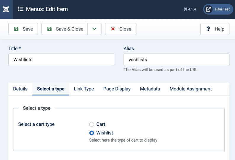

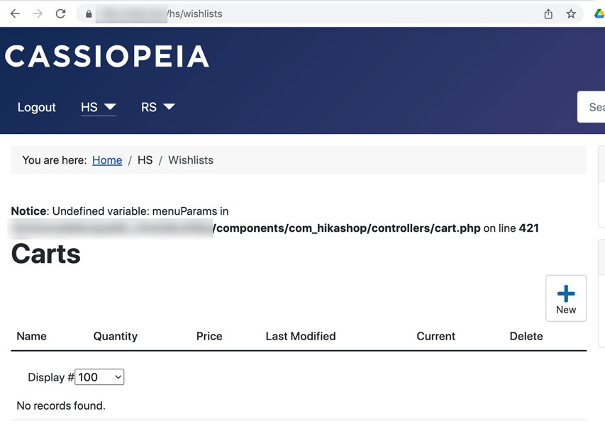

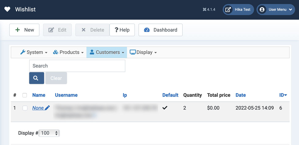

However, there's still an issue -- sorry. The "cart listing" menu item's setting for "cart" or "wishlist" does not matter, the page only shows the same "carts" listing. In my case now & here there is no cart, while a wishlist does exist. Plus there's "Notice: Undefined variable: menuParams in XYZ/components/com_hikashop/controllers/cart.php on line 421" -- the line number appearing to be in the region of the new code you had provided earlier.
Various screenshots attached.

4 years 6 months ago #341982 by nicolas
Replied by nicolas on topic "Add to wishlist" problems
The code was still wrong in www.hikashop.com/forum/wishlist/904468-a...problems.html#341941
I've modified there. Please try that new version of the code and it should take the type into account properly.
The following user(s) said Thank You: lousyfool
4 years 6 months ago #341983 by lousyfool
YESSSSS, now working!
