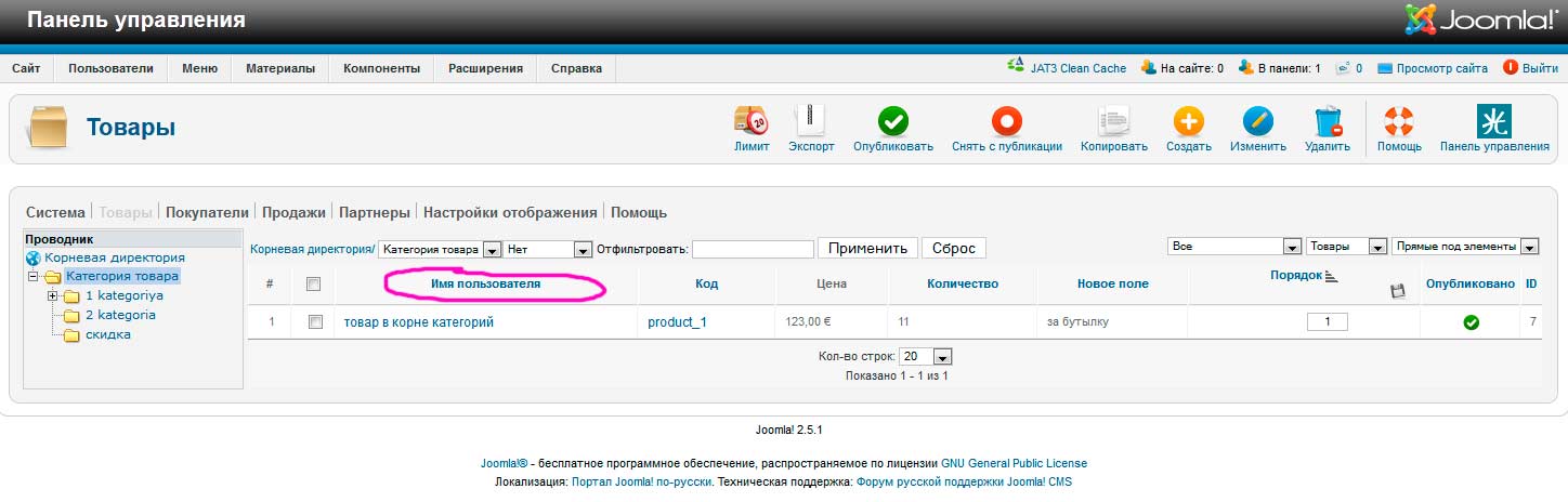

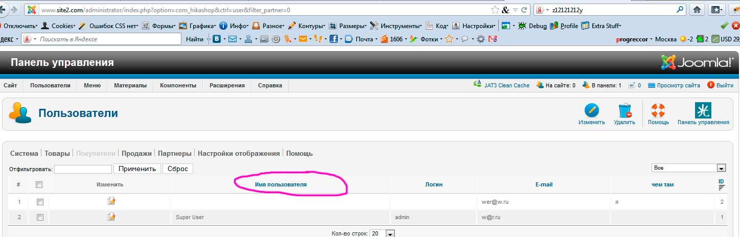

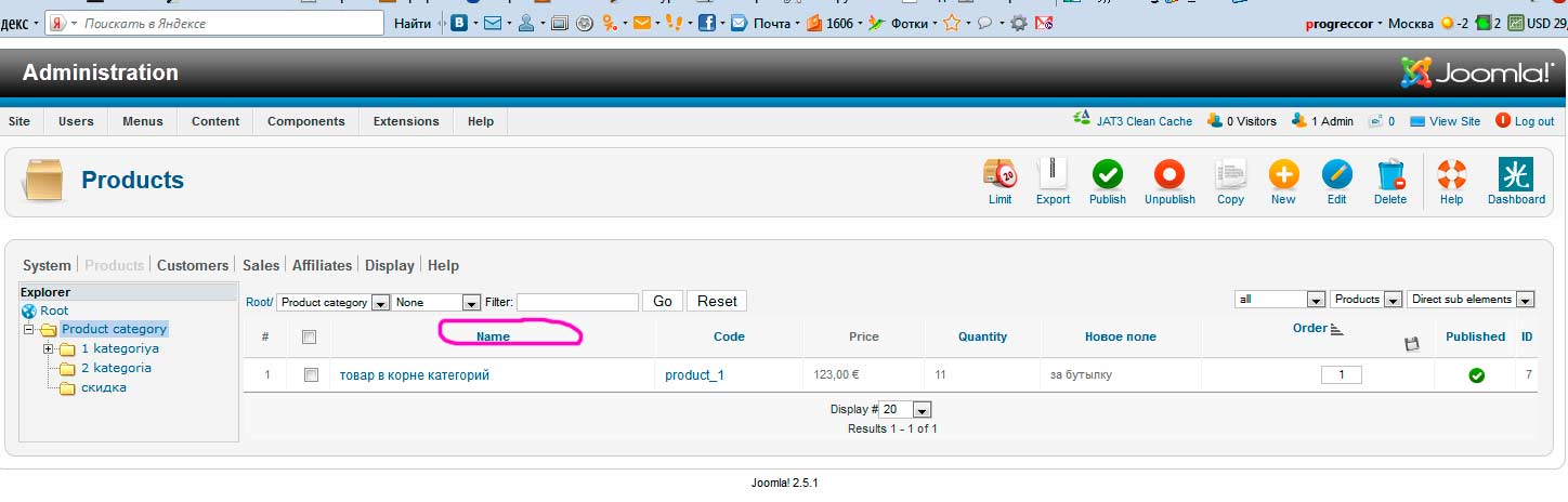

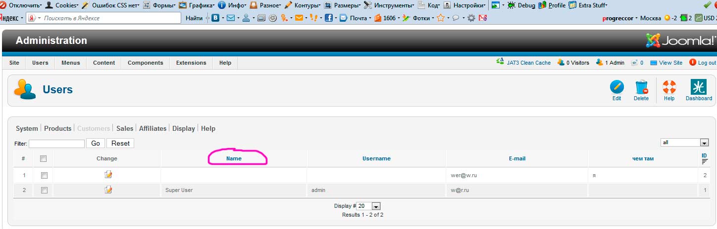

Here is the problem.
In Russian language (and I think in other languages too) there is different words for the name of the user (man's name) and the name of the thing (good, bottle and so on).
in Hikashop there is the same thing. The same string is used for the name of man and the name of the thing.
here is two screenshots:
we need two different strings. There is very confusion for us.

We didn't think of that one as it works in english french and japanese :)
We'll change the translation strings for the user name to HIKA_USER_NAME instead of HIKA_NAME in next release so that you can get two different translations.

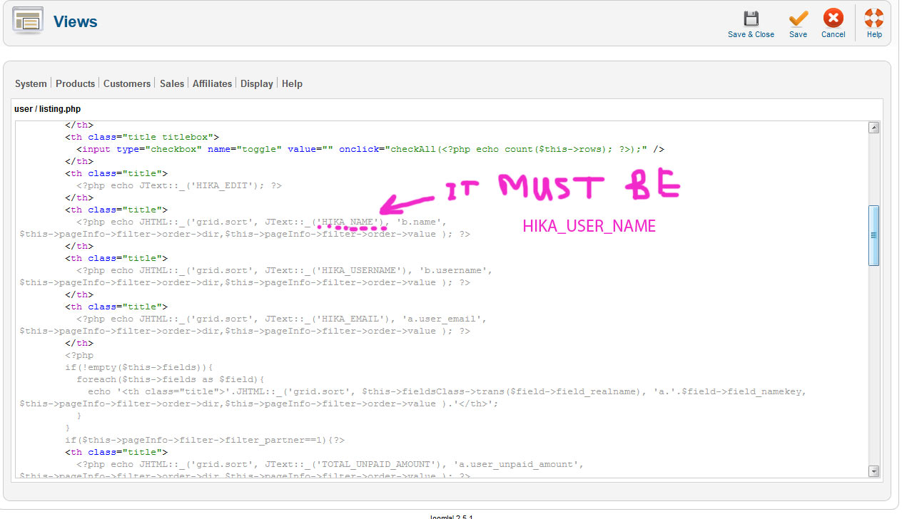

Now please change this lines in new translation file so that it will be more correct:
HIKA_NAME="Название"
HIKA_USER_NAME="Имя пользователя"
And please correct another string that you forgot to fix in user view:
Я здесь добровольно!

14 years 4 months ago #43565
Thanks. We updated that on our end.

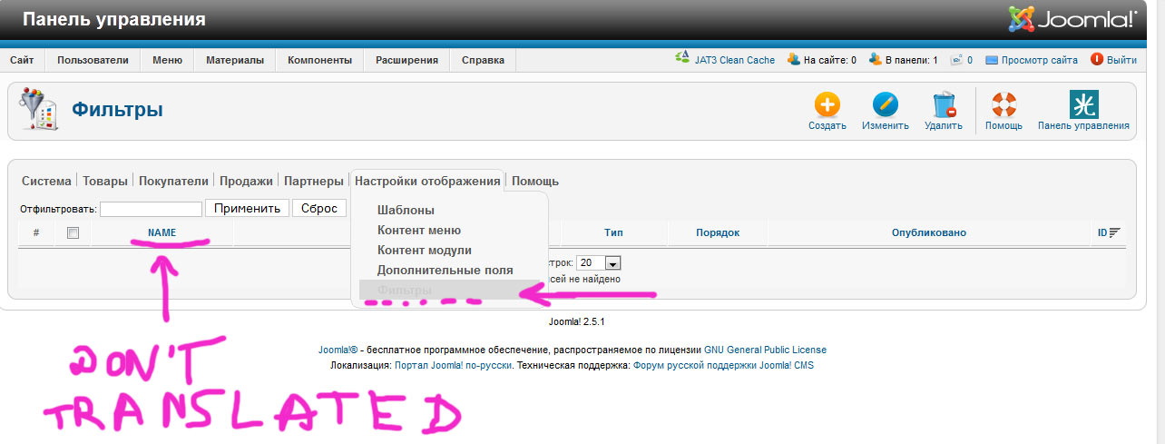

also I have noticed that another field in the filters table don't translated:
  • Posts: 86028
  • Thank you received: 14172
14 years 4 months ago #43577
Thanks for the feedback. We changed that.
