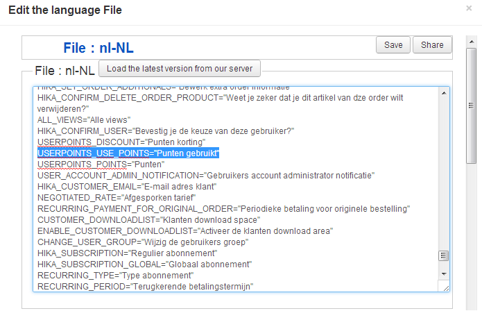

Dear Hikashop,
Yesterday I purchased the business edition of Hikashop.
After the easy installation I tried to install the dutch language on the ways described on this forum and documentation.

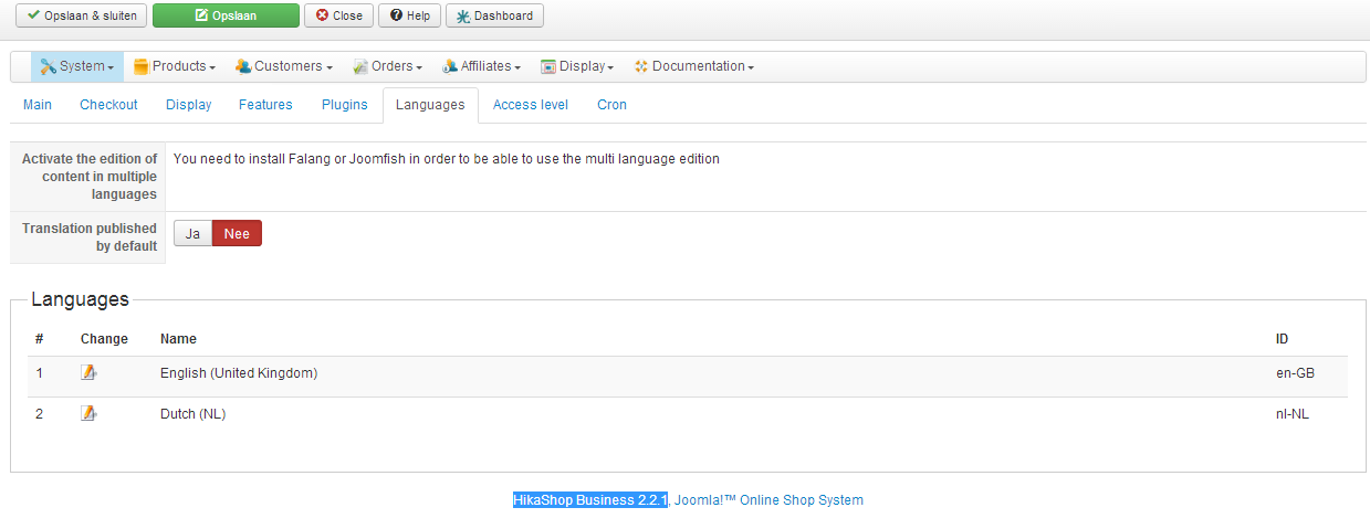

In de configuration/language section I see the dutch language, but somehow it is not working.

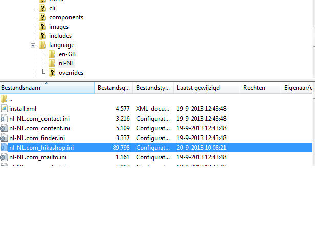

Language file: nl-NL.com_hikashop.ini is put in to the map language/nl-NL
I also upload the file in the language section and of hikashop and save it.
The website frontend and backend is set to nl-NL and is working for joomla.
Please kindly advise how to solve this matter.

12 years 10 months ago #124378
I see that there is an error is the NL language file.
We will see to update it as soon as possible.
You can edit the file directly and replace the line
USERPOINTS_USE_POINTS="Punten gebruikt
With
USERPOINTS_USE_POINTS="Punten gebruikt"
The missing quote at the end of the line generate an error for Joomla which will not load the file.

12 years 10 months ago #124421
We found another issue with the line:
AFTER_A_CATEGORY_IS_CREATED="Nadat een categorie is aangemaakt""
which should actually be:
We've updated the language file again on our end with that new fix.
