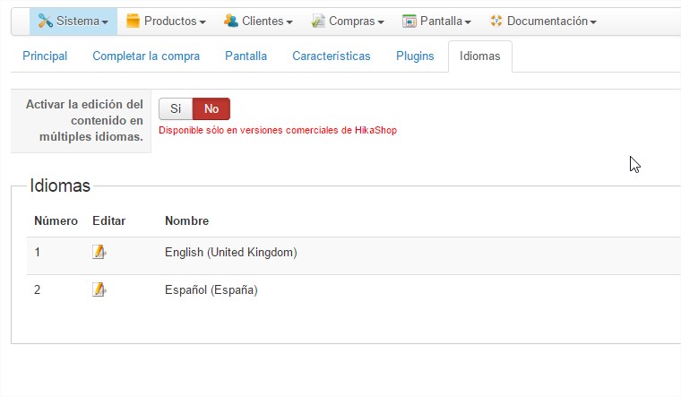

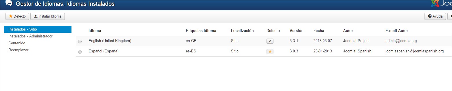

  • Posts: 1
11 years 4 months ago #196733

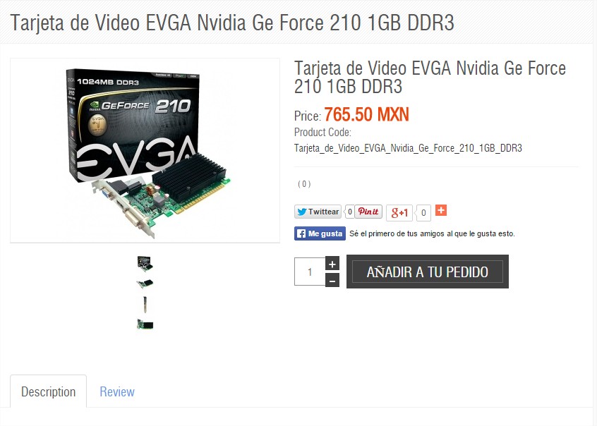

En hikashop tengo 2 idiomas, y en joomla le puse que sea en español, pero me aparece en inglés, cómo hacer que para poner como determinado un lenguaje en hikashop??
In HikaShop I have 2 languages, joomla and I put it in Spanish, but it is in English, how to have to put as determined in HikaShop language ??
Last edit: 11 years 4 months ago by mmedellin.
  • Posts: 26380
11 years 4 months ago #196867
Please be sure that your HikaShop Spanish is right up to date and contains all required translations.
You can also activate the Joomla language debug mode in order to see if you had some issues with the language files.
As you can see, some elements are translated, like the "add to cart" text.
HikaShop does not load the language files, Joomla does.
So there is nothing special to do in HikaShop because Joomla will load the spanish language file if the current language is the spanish one.
