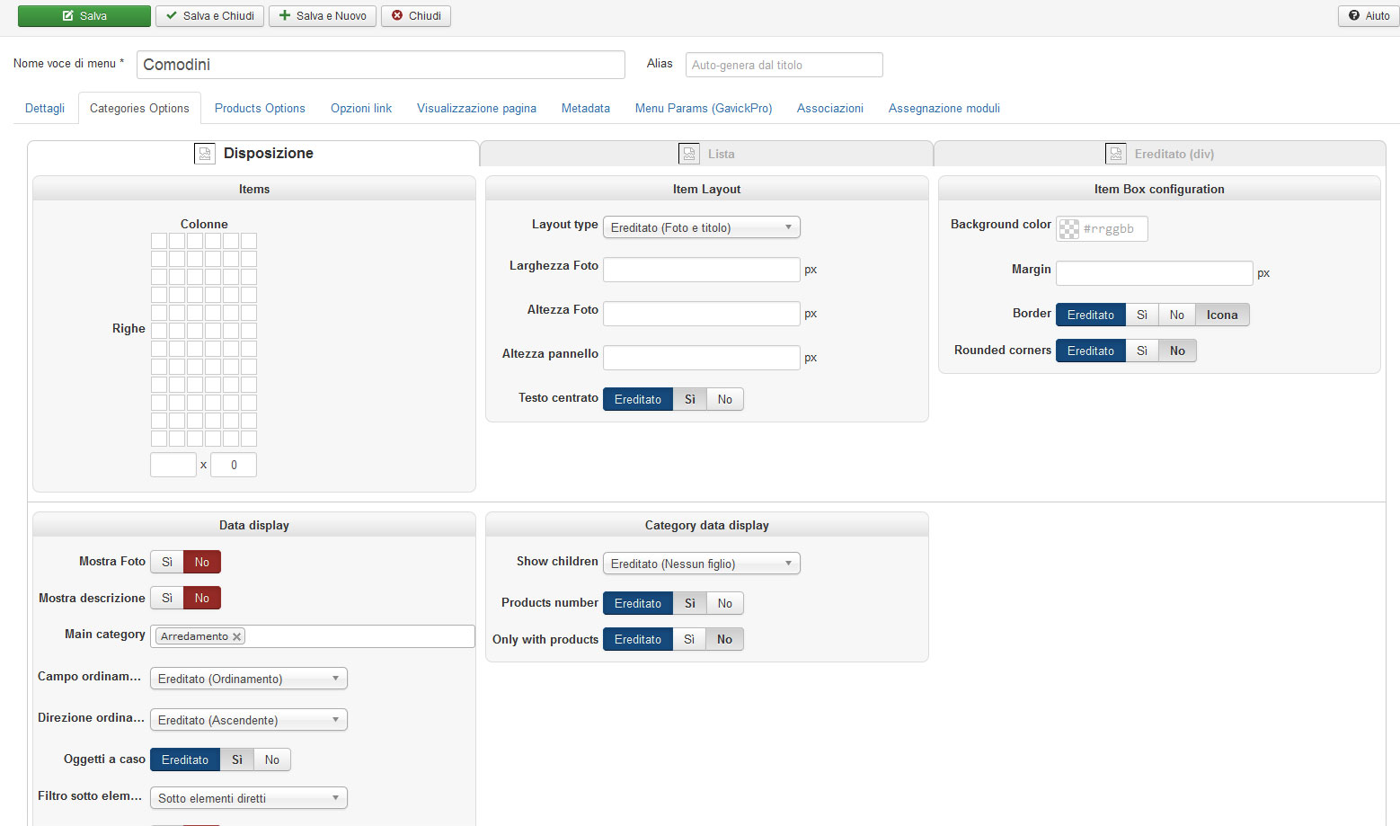

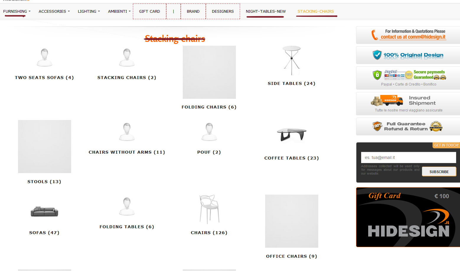

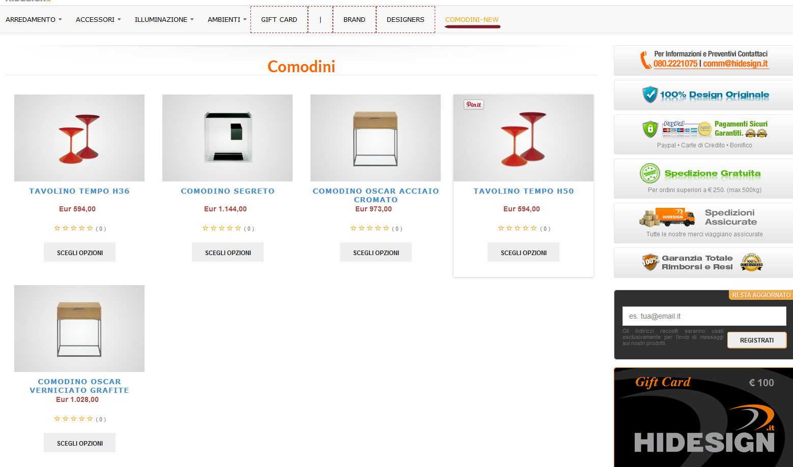

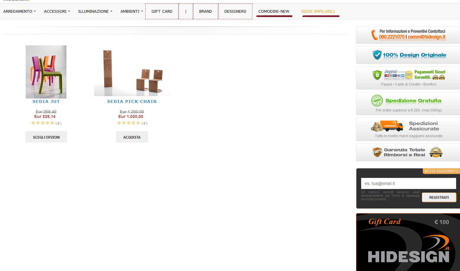

10 years 10 months ago #216146
Ok, I try to explain better with images.
As you can see in images 1 and 2, i'm not sure that for the new item all default settings are loaded correctly. For example, as default I have 4 rows x 100 products, but saving this new item without this setting, the system sets it to 3 rows x 7 products.
In third image you can see the new item category listing "comodini-new" that works fine in italian language.
But in the image 4 below you can see in english language it loads the category "furnishing" (that is the default category).

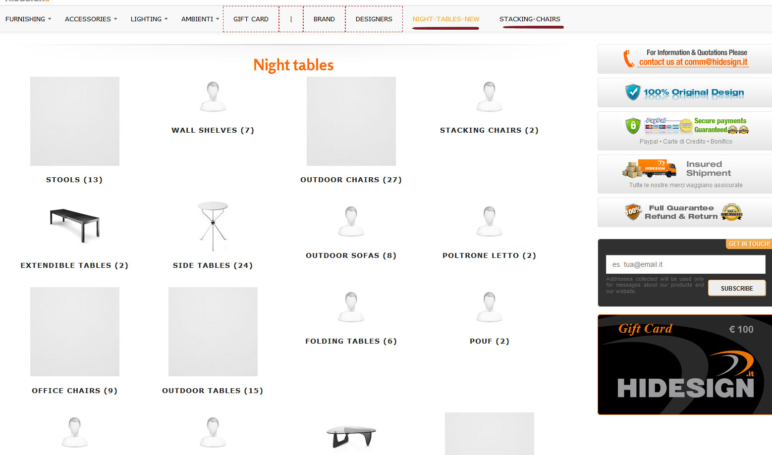

So I try to create a totally new item and category as you can see in the images below. The same thing.
In italian language (image 5) it loads correct "sedie impilabili".
In the english language it loads again the the category "furnishing" (that is the default category).

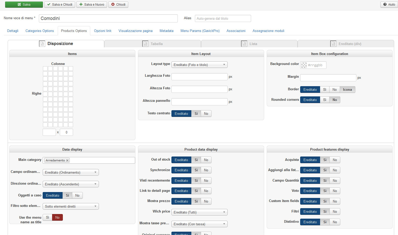

But, I uploaded the original files "hikashopmodule.php" and "selectoptions.php" again, and i noted that the first time I access to the item's translation I see the new category and product options. I can do my settings and then click to "Save & Close". If I click on this button the system saves the new settings. In fact the new items I had created work fine.
Instead if I click on the button "Save" i get the same errore and any settings are not saved. Moreover I can't access items more then one times.

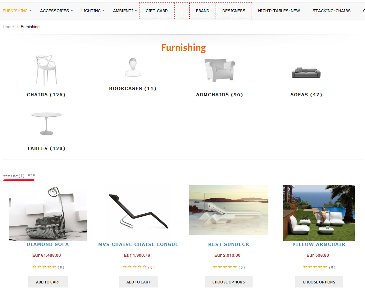

10 years 10 months ago #216342
I'm sorry but I have another problem after the last update. There is a string like "string(1) "4"" on the product listing page.

ps: sorry for the "string(1) "4"" it was some code added for the debug. removed !
