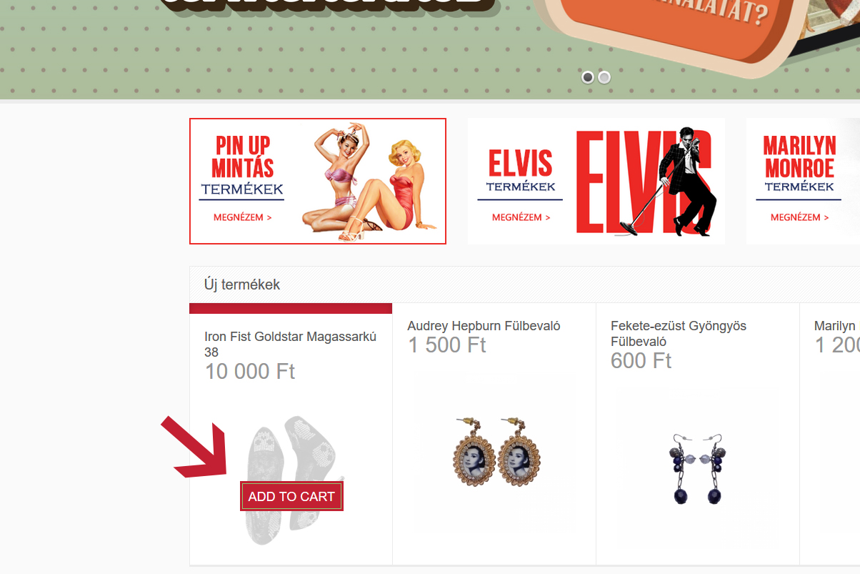

Hi!
I transleted to hungarian all the things successfully on my webpage, except this "Add to cart" button.
I searched everywhere, where can I modify this, but didn't find it.
Can you help me?
Bests,

If the rest of the text of the interface translates correctly, then that probably means that this text doesn't come from HikaShop but from your Joomla template.
Try switching your template to the default one of Joomla and see if the add to cart button text translates fine. If yes, I guess you'll have to check with your template provider on how to best translate that text.

I am also having the sam problem, and yes: the text on the button is staying in English when i switch tot the default Protostar template.

As Nicolas previously wrote : It means that it is coming from a customization in your template.
You have to edit it or contact your template provider so they will modify their view overrides to use the Joomla translation system like we do in our views.

it appears to be a template issue indeed. Went through the code of the template and there i found the string "Confirm your order" and "Add to cart". Translated it and there you go.
However, what i still don't understand is that those strings were also visible in the standard Joomla template Protostar.
Anyway, thanks for the help.

Sometimes it can be related to some cache issue.
Or maybe you also have some override for the other template.
Like that it's hard to tell.
