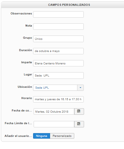

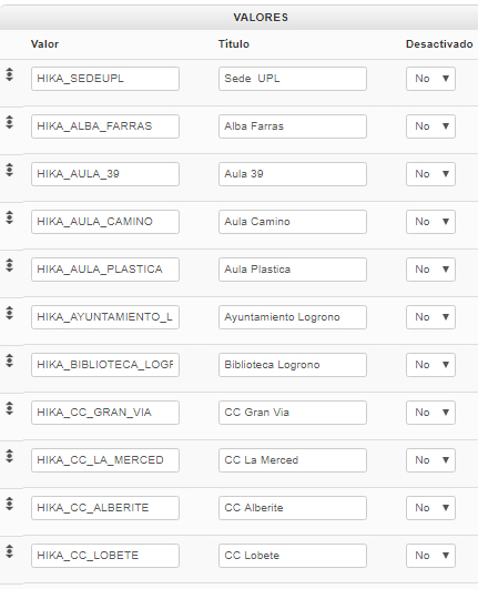

I have made a custom field, simple drop-down. With the values shown in the following image:

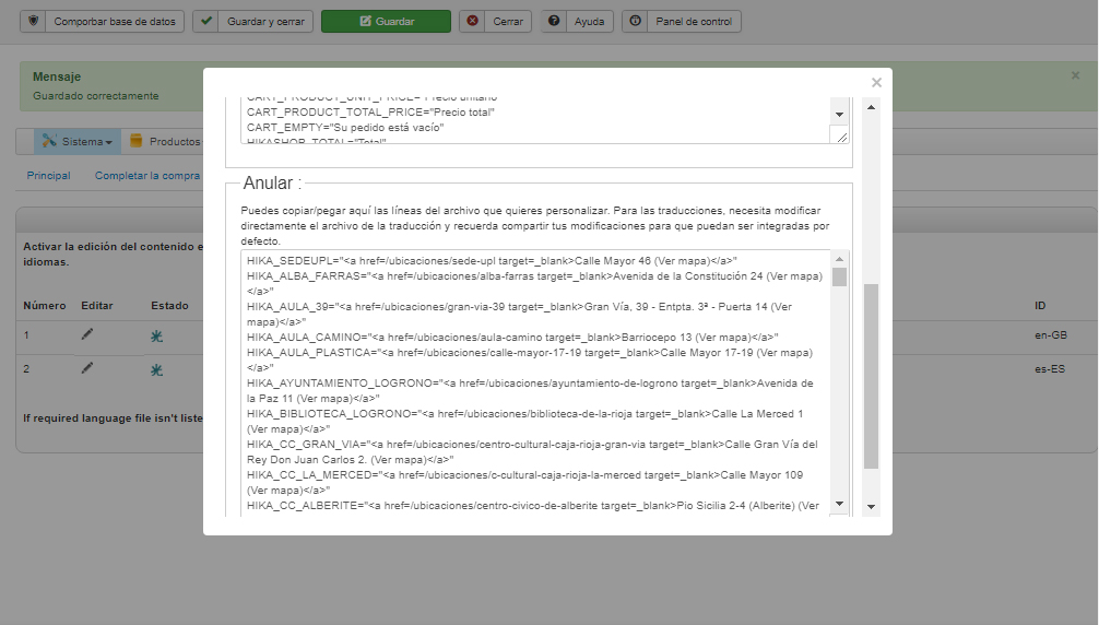

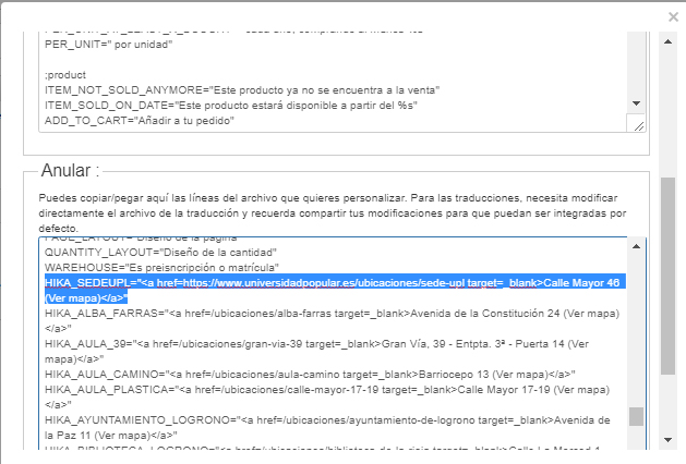

I added the corresponding tag in the language, for example in the first case the tag is
HIKA_SEDEUPL="<a href=https://www.universidadpopular.es/ubicaciones/sede-upl target=_blank>Calle Mayor 46 (Ver mapa)</a>"
As you can see in the following image

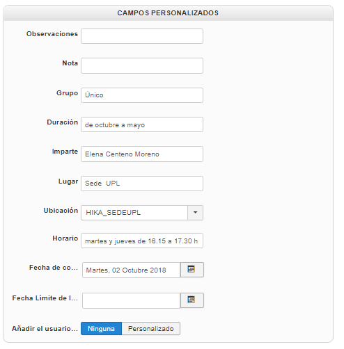

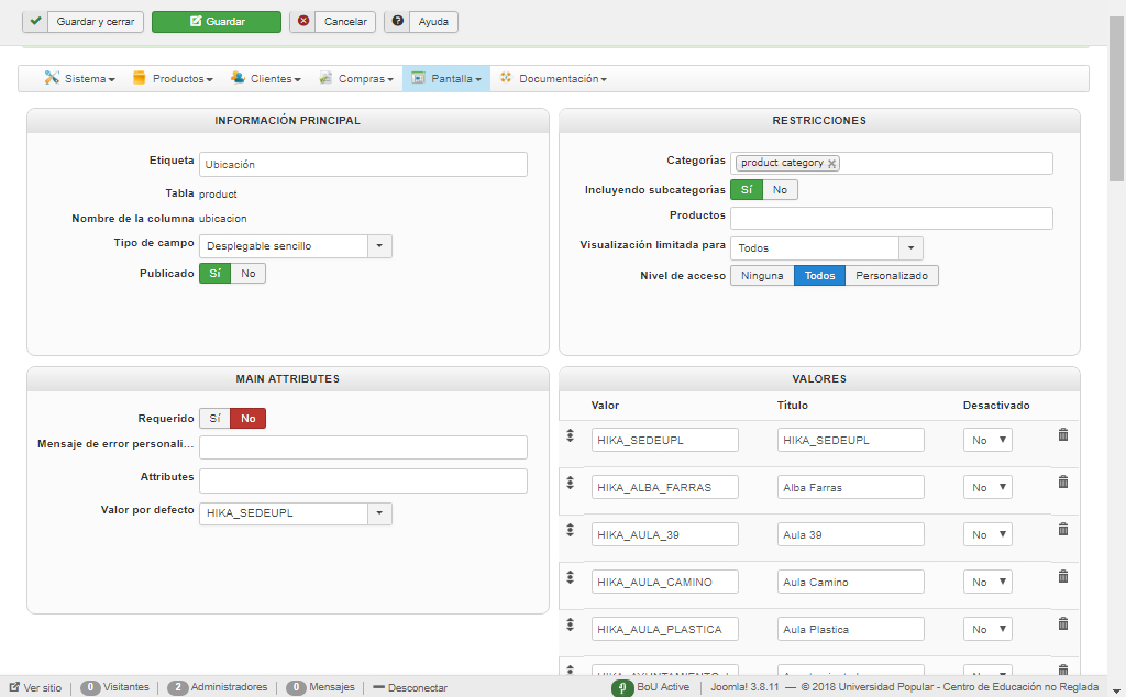

In the configuration of the product I made the selection, in the following way:

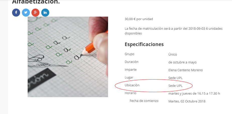

The result I get is the following:
I can not find the solution, a few days ago it worked correctly

You need to set the translation key in the "title" column, not in the "value" column (you can also put it in the value column, but what is displayed on the frontend is what you have in the title column or it's translation if its a key).

Following your steps, I changed the values, putting the translation key in the 'title' column.

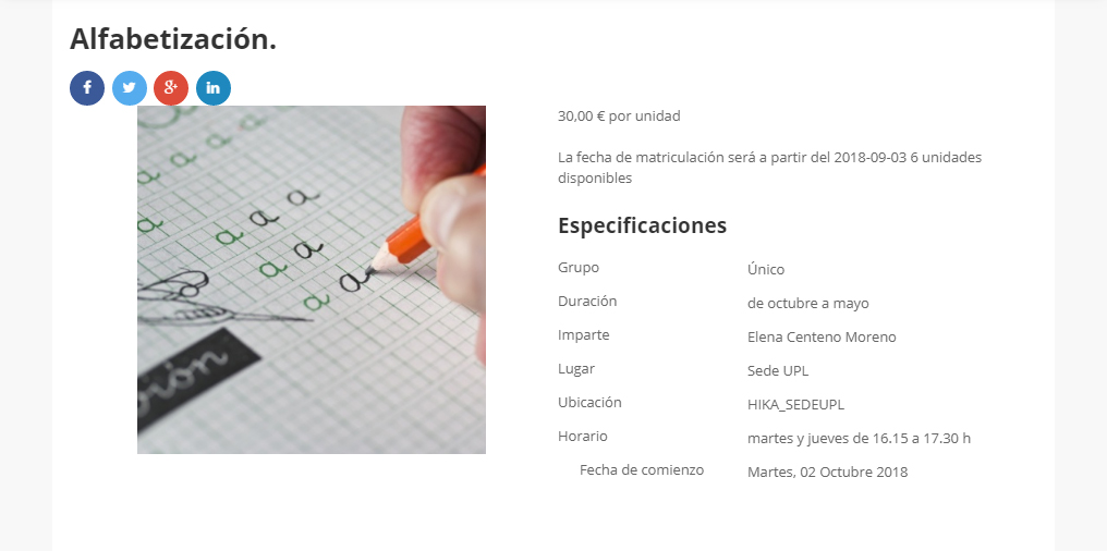

With the following translation key
Selected in the product
Being the result:
  • Posts: 85796
  • Thank you received: 14090
7 years 10 months ago #296311
Then, it means that you have an error in your translation file override.
Because of that, Joomla is not able to load the translations in the override file and skips the translations you've added, and in that case, HikaShop will display the translation key.
Try removing all the other lines in your translation override to check on that.
Also, you can activate the "debug" and "debug language" settings of the Joomla configuration. Att he bottom of the page, it should then tell you which line is the problem in your translation override file.
