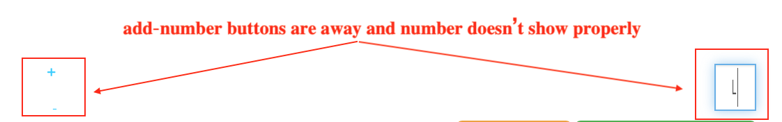

But another problem seems to exists:
The quantity field is very small for the numbers and plus-minus buttons are flying away in RTL mode.

For your specific quantity filed issue can you provide an Url link because on my side I have this, so basically nothing seems wrong on my localhost.

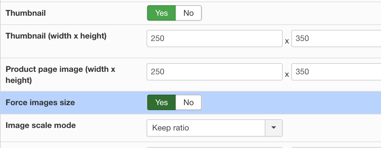

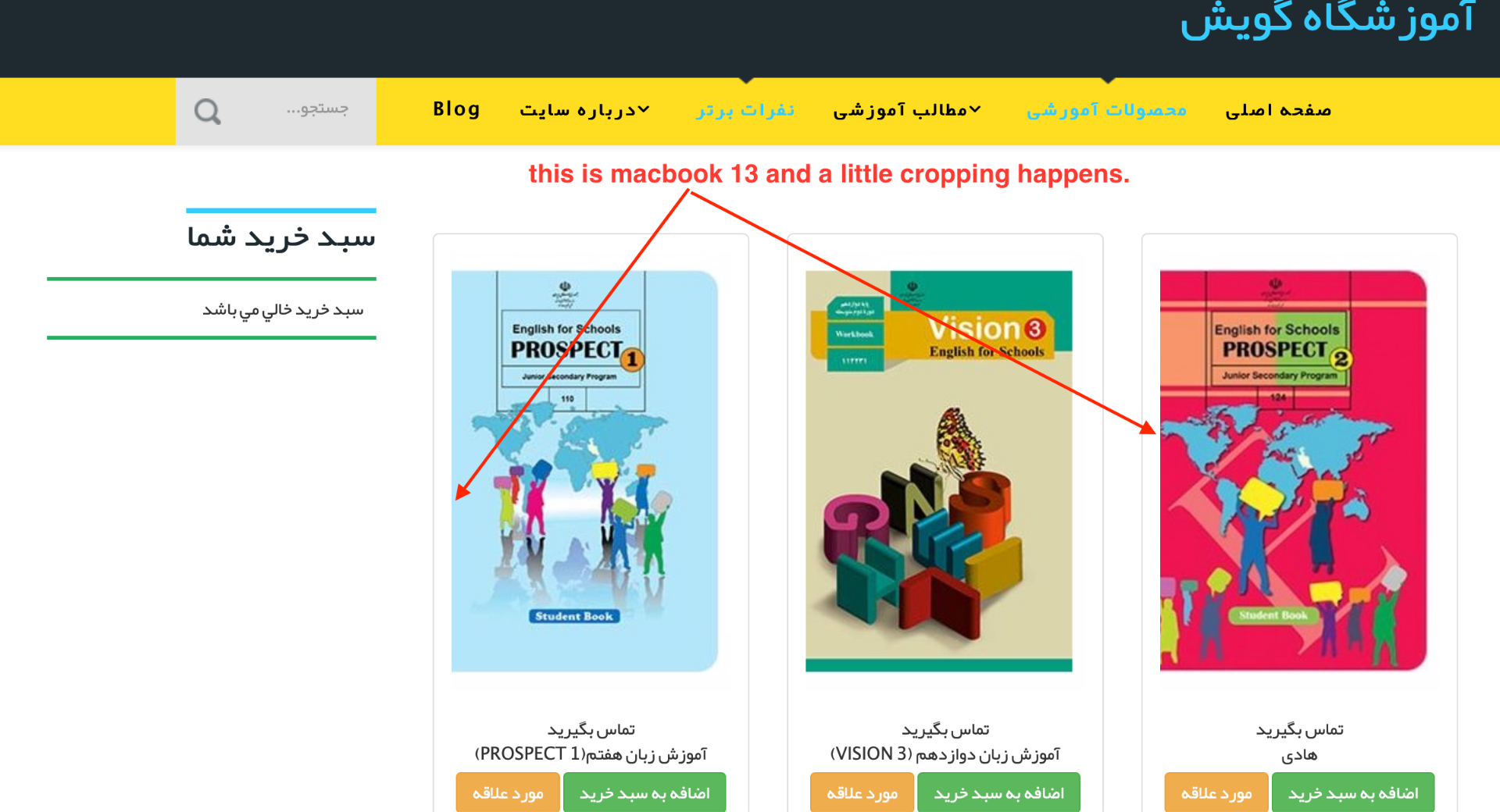

another case (as you will see in the url) is that in small desktops and tablets, instead of resizing the images, it crops some of my pictures.
I don't know if I have to resize all of my images?!
this is the sizes advised by my theme provider:
kind regards.

"another case (as you will see in the url) is that in small desktops and tablets, instead of resizing the images, it crops some of my pictures.
You don't have to resize yourself, but I use your Url link and wasn't able to see your cropped image issue, can you precise a precise example in order to better understand the context.

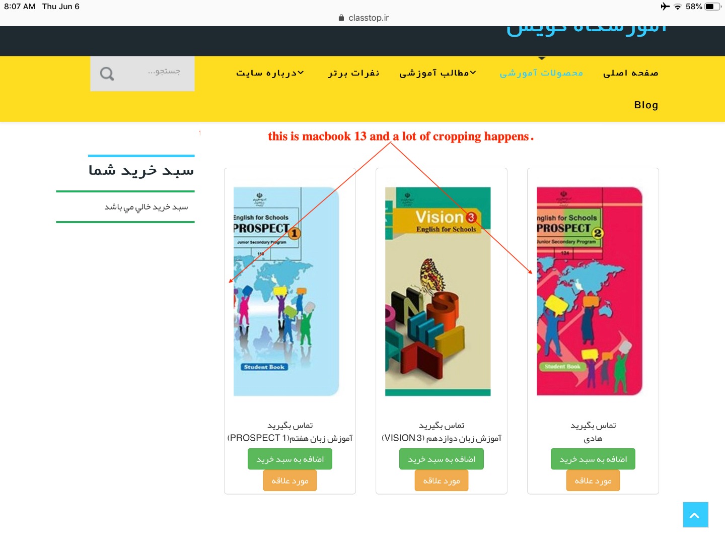

for the image issue, as I told you, it ONLY happens on small desktops (macbook 13" or Ipad 10" and other 10 inch tablets ONLY landscape mode).
on other devices it works perfect.
Kind regards
Yousef.
7 years 2 months ago #307339
It seems that you have a Css command, that won't allow the HikaShop css to work, see my screenshot
By removing this specific Css command from your template everything works as expected.
Last edit: 7 years 2 months ago by Philip.
The following user(s) said Thank You: usyuse
