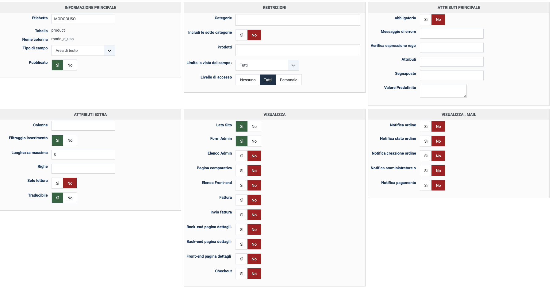

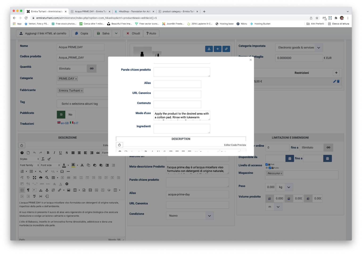

  • Posts: 75
  • Thank you received: 6
4 years 8 months ago #337709
I've attached the field configuration and the page of the product with the "Modo d'uso" translation.
You can see the product here:
www.ermiraturhani.com/en/shop-on-line/prod/acqua-prime-day
The main description and the field title are correctly translated but the "Modo d'uso" ("How to use") content is not translated
Thank U
