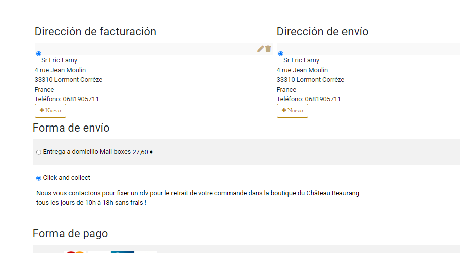

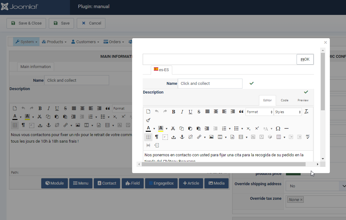

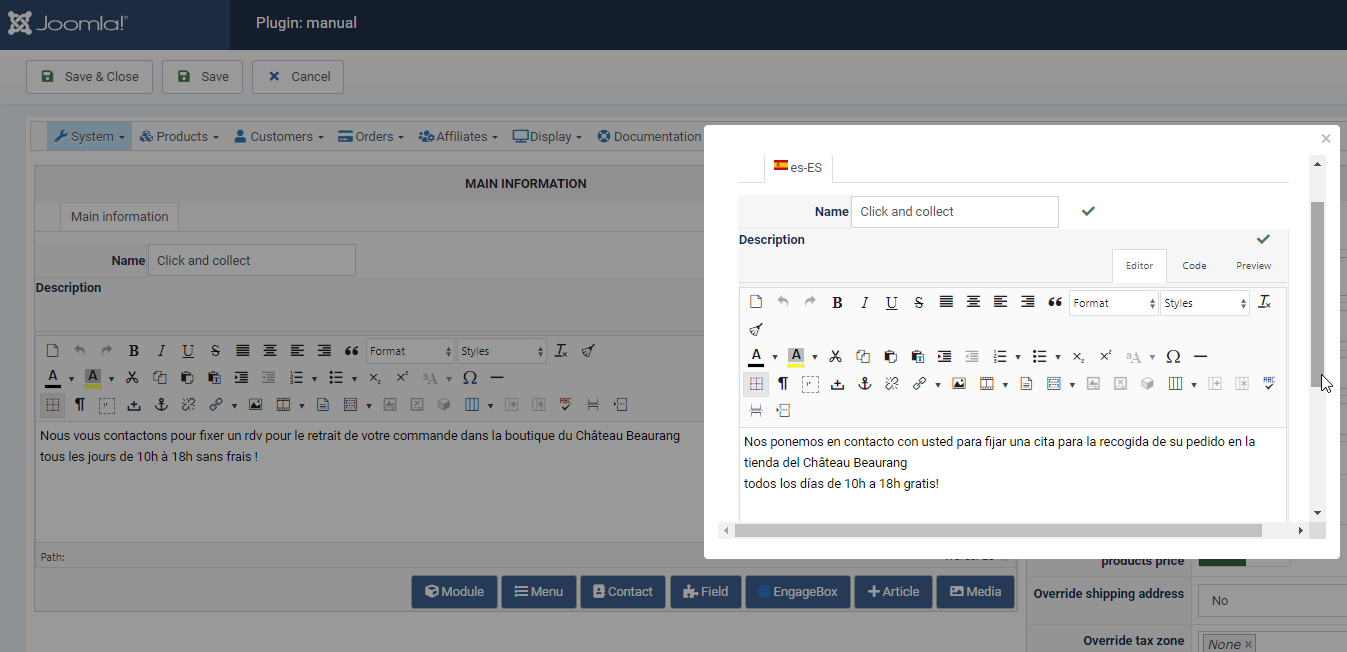

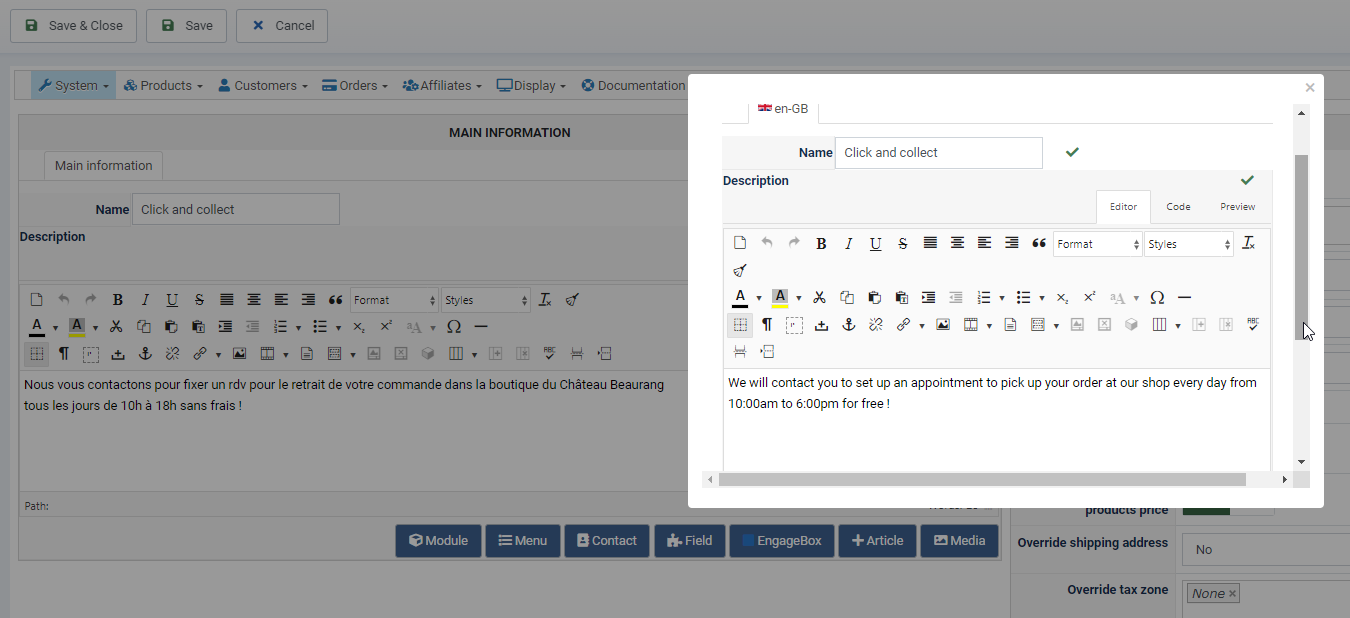

I translated the description of a shiiping plugin in french, english and spanish via the language tab but on front-end just the french language is displayed.
Can you please tell me why?

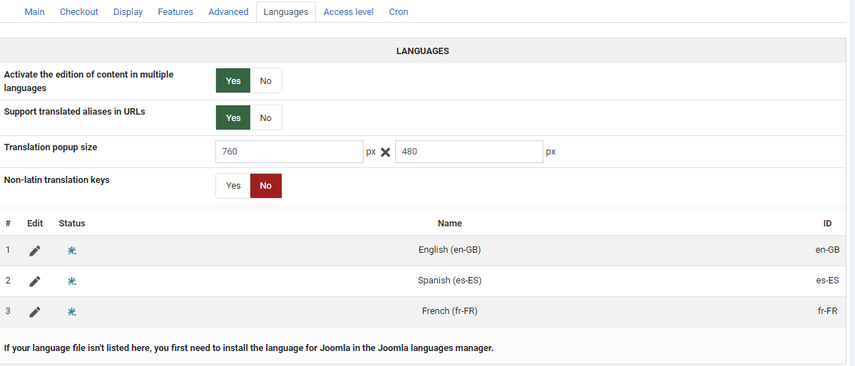

How are the options configured under the Languages tab of the HikaShop configuration ? Could you provide a screenshot ?

Here is the screenshot you asked for :
Also, could you provide a copy of the language override file where the translations are stored for one of the languages ?
It is not an override, I write the translation directly in the plugin description, see attached below or in my first message in this thread
