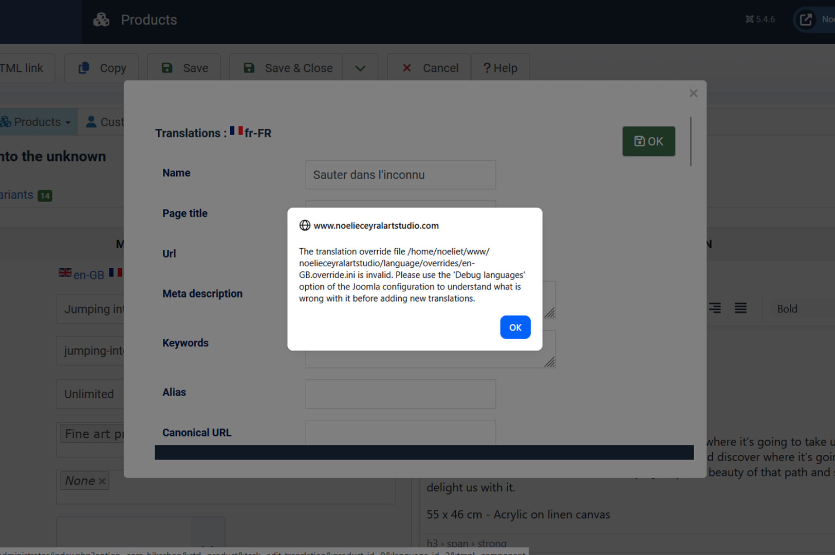

I was trying to add a salemethod entry for one of my page, and there was a problem while trying to save the translation. Now, my whole french website has lost all the translation and is in English (for the hikashop pages: oeuvres originales, tirages d'art, cartes cadeaux, évènements).
When I go to the products, the french translation is missing and some of the buttons for which I had changed the text is now only showing the translation key rather than the translation:
www.noelieceyralartstudio.com/index.php/...ose-the-exact-amount
www.noelieceyralartstudio.com/index.php/fr/noelie/evenements
Do you know what might have happened and if there may be a way to get the translation back? or do I need to use a backup to do that?
I am attaching an image of the message I'm getting when i'm trying to enter a translation
When I do language debug I get 5 errors with the /language/overrides/fr-FR.override.ini but I'm not sure what this is due to... Thank you![attachment=63399]

I'm actually still having an issue with the salemethod fields in custom fields. I had created different fields to allow me to change the text from "each" to something else, but now it's showing "each"/ "l'unité" everywhere, even on the products where I had specified something else. I have tried to change the translation with the english or french flag, but it gives me the same message as in my previous message (the screen capture) . Do you know what can be done about it?

Thank you for coming back with what you did to recover, it explains the shape of the problem.
Translations are stored as Joomla language override files, and those are ini files. If a single line in one of them cannot be read by PHP, the whole file is rejected, not just that line, so every translation it holds stops being applied at once. That is why your site went back to English in one go rather than losing a single string, and why removing the line you had just added brought everything back.
Your en-GB override file is still in that state, which is why you keep getting the message when you save a translation. To find the line: set Error Reporting to Development and activate the Debug language setting in the Joomla global configuration, then trigger the message again. PHP will name the line number of the file it cannot read. Also, at the bottom of pages, the debug system should provide information about problems in language files. Remove the line(s) with issues and saving translations should work again. Everything else in the file can stay, and nothing has to be translated again.
