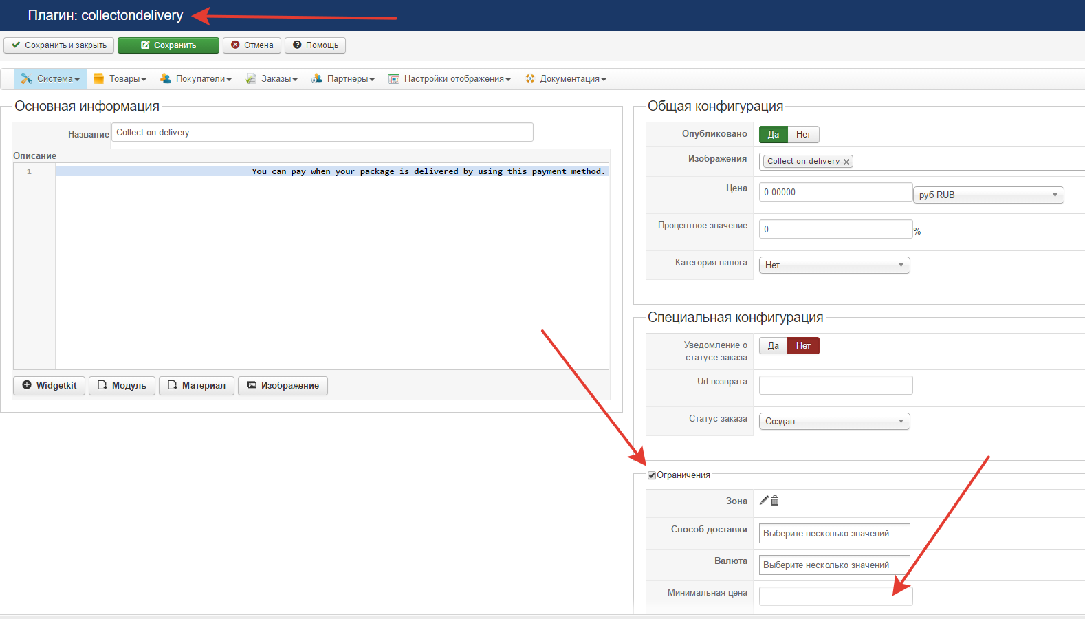

  • Posts: 2293
  • Thank you received: 315
10 years 2 months ago #243456
что то типа этого: (выбран плагин оплаты при доставке)
Я здесь добровольно!

  • Posts: 86104
  • Thank you received: 14203
10 years 2 months ago #243452
You could create several shipping methods, or several payment methods with these price restrictions using the "minimum price" and "maximum price" fields and set the corresponding percentage (positive or negative) that you want for each.
That way, the system would automatically display the relevant shipping/payment method on the checkout based on the total amount of the cart and apply the percentage you configured for it.
