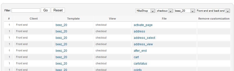

  • Posts: 26381
12 years 2 months ago #156623
I means that :
Or in the demo website: click here

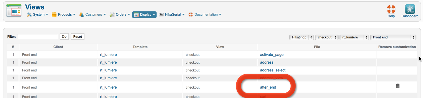

  • Posts: 10
12 years 2 months ago #156993
Hi Jerone
I'm sure i'm editing the right file, pls see picture below:
And didn't get any thing printed from the var_dump, it feels that the after_end file is not executed.
