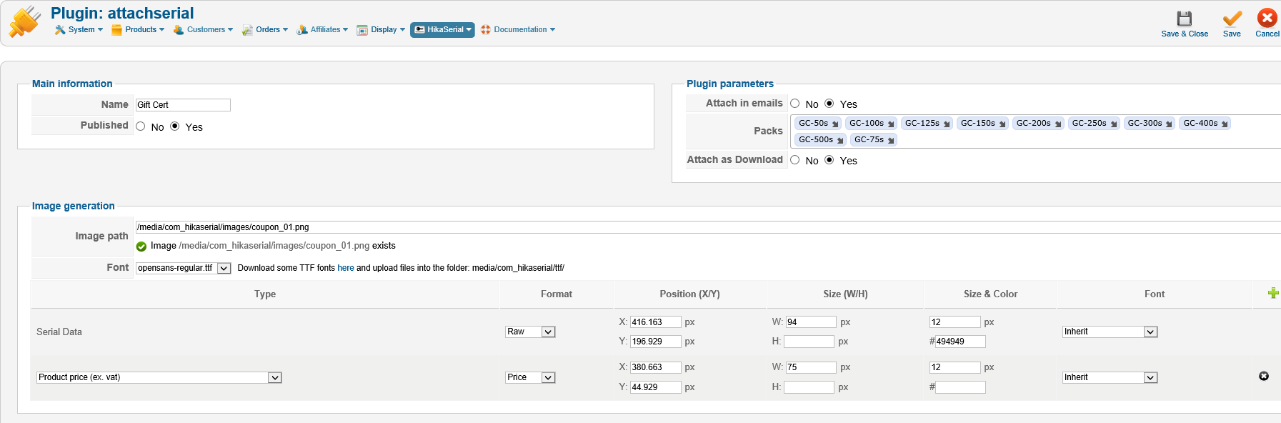

6. In Attach Serial plugin, created a graphic template for the gift certificate (Gift Cert, ID #1) - see attached file "attachserial1.png" for example - I just replaced your sample "coupon_01". I have tried embedding it in the email, and I have tried setting it up as a dynamic download, but this is where I'm getting stuck. Neither one works.

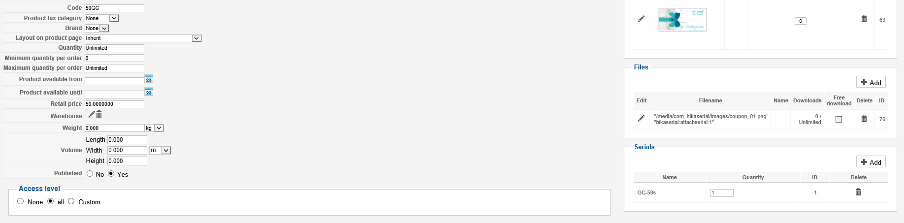

I have tried putting every possible configuration of "#hikaserial:attachserial:X" in the product file (see attachment "attachserial2":)
  • /media/com_hikaserial/images/coupon_01.png#hikaserial:attachserial:1
  • "/media/com_hikaserial/images/coupon_01.png" "hikaserial:attachserial:1"
  • "#hikaserial:attachserial:1"
  • #hikaserial:attachserial:1

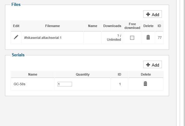

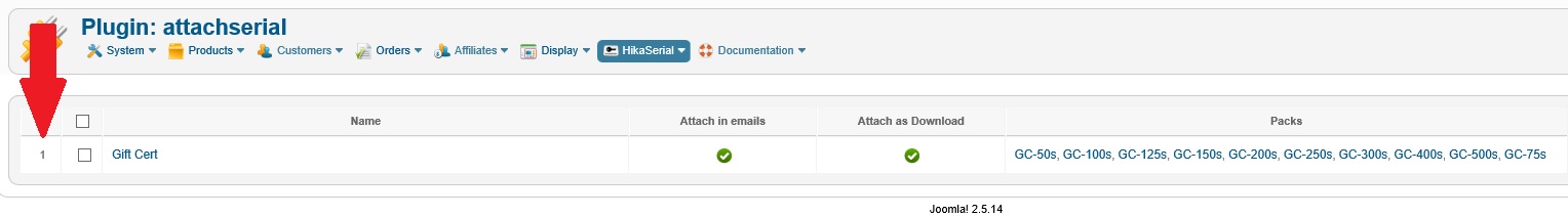

1. The Configuration for the Attach Serial is ID 1 (see attachment "Serial1.jpg")
2. The product file link is #hikaserial:attachserial:1 (see attachment "serial2.jpg")
3. The order is "confirmed" (attachment "serial3.jpg")

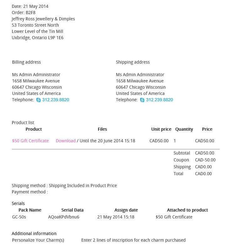

4. The serial data shows on the order data in the customer file (attachment "serial4.jpg")

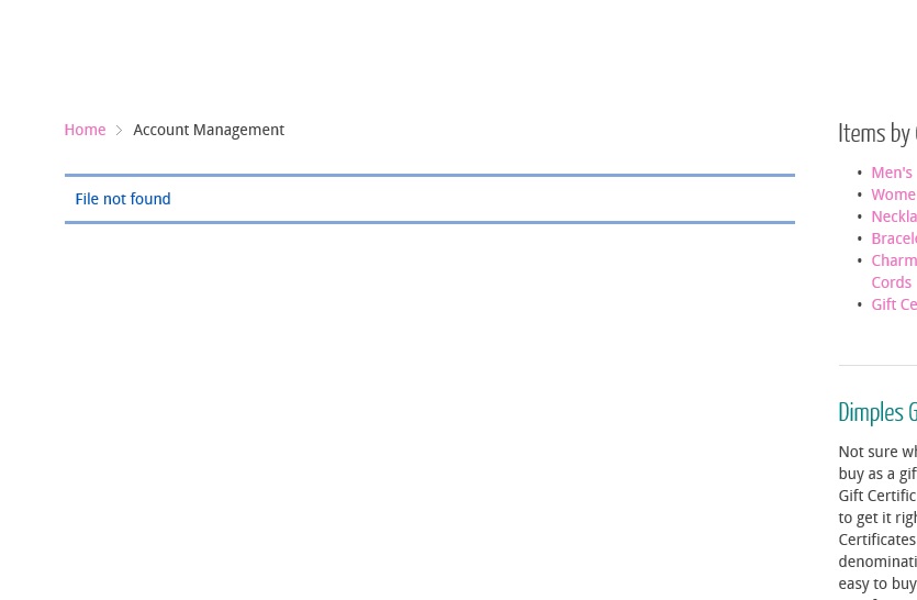

5. When I click the download link on the backend order view or the link in the confirmed order email, I still get "file not found." (attach "Serial 5 - click download.jpg")
This is very similar to a problem I am having with a different site. Could I be doing something wrong upstream that is leading to this?

Unfortunately, the plugin id is not display in the listing.
The number displayed in your first screenshot is the counter.
To get the plugin_id, you have to click on the "Gift cert" and read the parameter "plugin_id=" in the URL.
