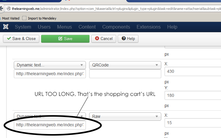

The URL I used in "Attach Serial" is super long. Too long to display within coupon_01.png. I know how to extend the graphic but would prefer a way to break the URL into 2-3 lines. I am unsure if the window displaying coupon_01.png will auto extend if I make the png longer? Alternatively, is there a shorter URL. I'm referring to the shopping cart's URL. I got the URL from the product page "HTML LInk"

2. You can choose what you want to put into the QRCode, if you want a short url, you can create a short url.

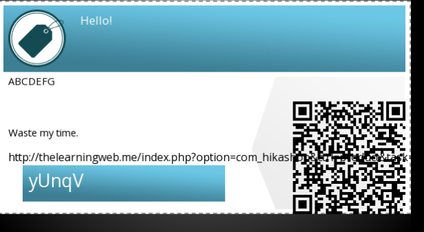

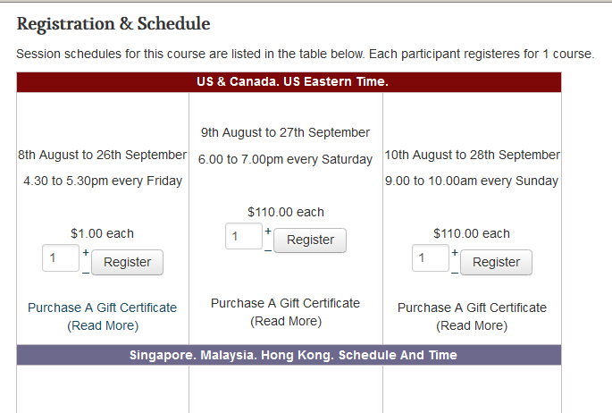

12 years 2 months ago #159346
Thanks Jerome for answering questions on a weekend. No need to answer me on the weekend. Is there step by step tutorial file on how to use the Hikaserial plugin "Product-Add Consumer"? I assume it's the plug in that you mentioned "addproduct". I activated the plugin but don't know how to use it.
Here's a screen shot of my problem of the long URL.
This is what happens
Here's a screen shot of my webpage. I made 2 carts for each product, one normal cart without gift certificate and another for the gift certificate. I'm simple minded. This method seems to work for me although it is not efficient. Too many shopping carts.
My users are not tech savvy, they may or may not know how to use a QRCODE. They will likely need to consume the coupon some other way, manually. Am I right to assume that the code that is generated (10 characters) can be manually entered through the URL to consume the gift if users do not use the QRCODE? I have not tested this because that URL is too long and not click-able.

The plugin "attach serial" allow you to specify a width and an height for the different elements.
So you can display the url on two (or more) lines if you want. By setting a width the text will continue on a new line.
I don't know your url but I will recommend you to use Joomla menu to get SEF and shorter url.

I am unable to shorten the long URL, Joomla is configured properly for search engine friendly URLs. I am unwilling to explore ways to shorten URLs further because I use a plugin known as Joomdle. The URLs are already as short as they can get. I tried using Bit-ly to shorten the URL but the coupon would be publish when I use Bit-ly.

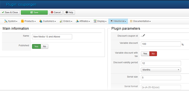

I hope you can help me, I took pictures of my settings. I did not show the AttachSerial plugin because the settings is the same as before. I was not able to shorten the URL. So, that's also a problem.

Why not using a short link with some explanations ?

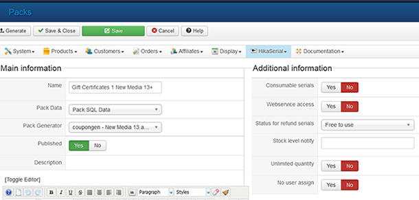

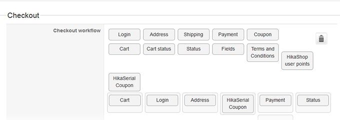

  • Posts: 11
12 years 2 months ago #160192
Hello Jerome,
I am still unable to make the gift certificates work properly although it's working better than before. Thanks for the suggestion to direct gift receivers to a separate page with instructions on how to consume the gift. A lot of extra work :( but many of my users will not be able to scan QRcodes.
Now, the problem is:
1. A new serial is generated each time a gift receiver consumes a serial.
2. The gift receiver gets a coupon with new code attached to his confirmation email.
3. The new serial status indicates "used" but someone else can still consume it.
4. The old serial status is set to "used" after the gift receiver consumes it but someone else is still able to reuse the code.

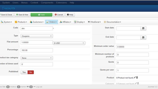

I think this is because I don't know how to set the template coupon, some of settings is wrong. Here's my attached screen shot of the template coupon.

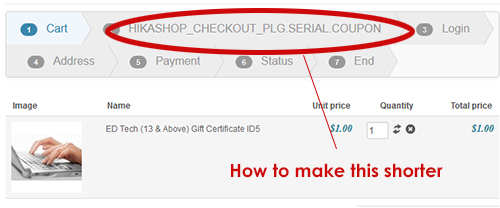

Then, I would like to know if I can make "HIKASHOP_CHECK_OUT_PLG.SERIAL.COUPON" much shorter to just "Coupon"
Thanks again.
  • Posts: 26381
12 years 2 months ago #160203
You have to change the "quota" and not the "quota per user". Otherwise everybody will be able to use it.
Please note that the coupon and the serials are separate. When you use a serial or when you use a coupon, it does not affect the other.
Using a coupon and consuming a serial are two things totally different.
About the "HIKASHOP_CHECKOUT_PLG.SERIAL_COUPON" there is a missing translation that you can add directlu in your language override.
HIKASHOP_CHECKOUT_PLG.SERIAL_COUPON="Coupon"
  • Posts: 11
12 years 2 months ago #160480
Hi Jerome,
Thanks the help. :) I've solved every problem except one.....
1. When a gift receiver consumes a serial, he receives a confirmation email with a new coupon and new serial number. This new coupon code can be used.
In the coupon or discount template, I set:
quota = 1
quota per user = 0
percentage = 100
number of times used = 0
Not sure if the coupon template setting is the problem. The gift receiver should not receive a new coupon with a new serial when he consumes a gift certificate. I use the classical method of consuming the gift via the check out process.
Everything else is working nicely.
Thanks again.
Ivy

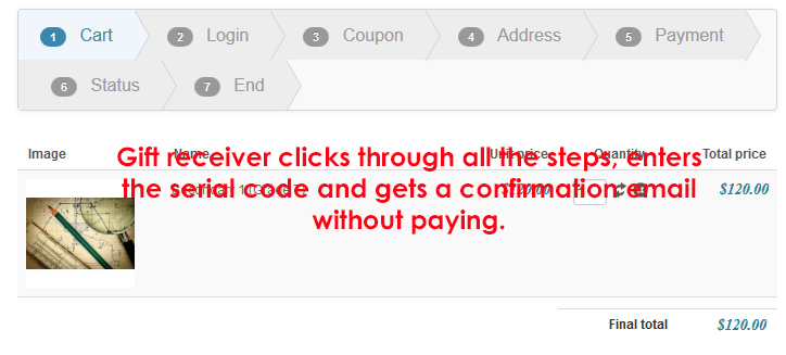

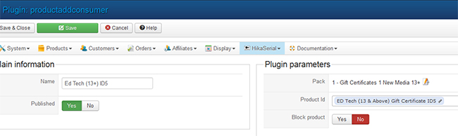

  • Posts: 11
12 years 1 month ago #160761
Hi Jerome, Good day to you :)

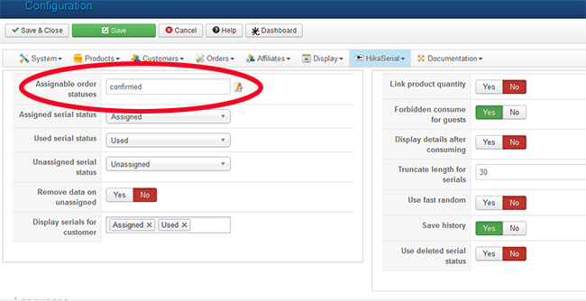

I did some self study. Based on the Hikaserial documentation, a serial is generated each time an order's status is changed to confirmed.
In my set up. the gift receiver enters the serial code in the checkout process for that specific cart, then he/she clicks through the check-out steps with 0 payment. In the end, a confirmation email is triggered. I believe it's this confirmation email that results in the generation of another new serial. Take note that the "Coupon" is Hikaserial Coupon (I renamed it), and not the usual Hikashop Coupon. Not sure if this is correct.
I use the plugin ProductAddConsumer but I am not sure what "Block Product" means, so I left it unchanged. I also did not do anything to connect this ProdcutAddConsumer to the check-out process. Basically, I just left it like this after creating it. Must I manually assign it to the check-out process or product?
If this does not help. I can give you access to my website's admin backend to take a look at the settings. Not sure how else this can be done. Alternatively, I can also take more screen shots.
Ivy

  • Posts: 26381
12 years 1 month ago #160766
So, someone buy a gift certificate which allow to buy a product which also generate a serial.
I guess the problem is just here.
Why the product "ED Tech (13 & Above) Gift Certificate IDS" also generate a serial ?
You giving a product which give a serial which give a product which give a serial which.... etc
Can you just remove the pack assignation for this "ED Tech (13 & Above) Gift Certificate IDS" product ?
Or give another product, which does not have a link with an HikaSerial pack ?
  • Posts: 11
12 years 1 month ago #160978
Jerome wrote: Hi,
:lol: :silly: :P I had a good laugh when I read that. It is now working.......thanks Jerome! :blush:
