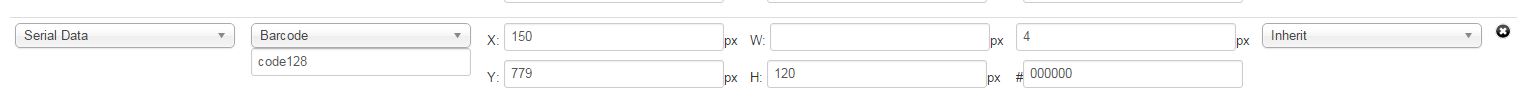

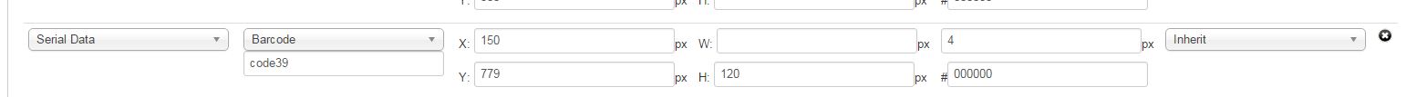

I am sorry but I have tried every parameter available in the back end under barcode including size, size(w&h) and the barcode width and height and nothing changes either the width of the barcode nor the width of the lines in the barcode that is why i posted this here. I promise you there is something wrong when using a code39 barcode.
The size parameter works when you use a code128 barcode, qr code, etc but when using a code39 barcode the size does not change when you use the size parameter. I even attached my settings for you. If you set the size parameter to 4 then with the code128 barcode then the lines get 4 times as wide, but when you set it to 4 for a code39 nothing changes at all. There has to be some sort of bug.

10 years 5 months ago #232650
My bad.
It looks like the library BarCode2 (from pear : pear.php.net/package/Image_Barcode2 ) does not support the setting "width" for some barcode formats.
You can find that lib in the folder "administrator/components/com_hikaserial/inc/barcode/Barcode2/".
In the file "Barcode2.php" we can find the code
if (!$obj instanceof Image_Barcode2_DualWidth) {
	$obj->setBarcodeWidth($width);
And the driver "Code39" is a "dual width" driver
class Image_Barcode2_Driver_Code39 extends Image_Barcode2_Common implements Image_Barcode2_Driver, Image_Barcode2_DualWidth
But not the driver Code128
class Image_Barcode2_Driver_Code128 extends Image_Barcode2_Common implements Image_Barcode2_Driver
So I think it would require some modifications directly in the lib in order to support that "dual width" and allow you to change it.
Like
} elseif ($width > 1) {
	$thin = $obj->getBarcodeWidthThin() * $width;
	$obj->setBarcodeWidthThin($thin);
	$thick = $obj->getBarcodeWidthThick() * $width;
	$obj->setBarcodeWidthThick($thick);
Let me know if it helps.
