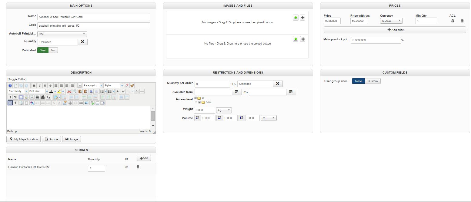

I have hikaserial installed and the packs and serials are assigned to my variants in my products but when I complete an order no serial is attached to the order in the backend of hikashop. I am getting frustrated at this point as I have tried every setting available and nothing works. I wanted to mention as well that I am manually importing serials.
How, do I fix this? Also, I have serial attach enbabled in the email, but nothing is being sent when an order is placed? Orders are automatically set as confirmed and the pack data is set to sql.

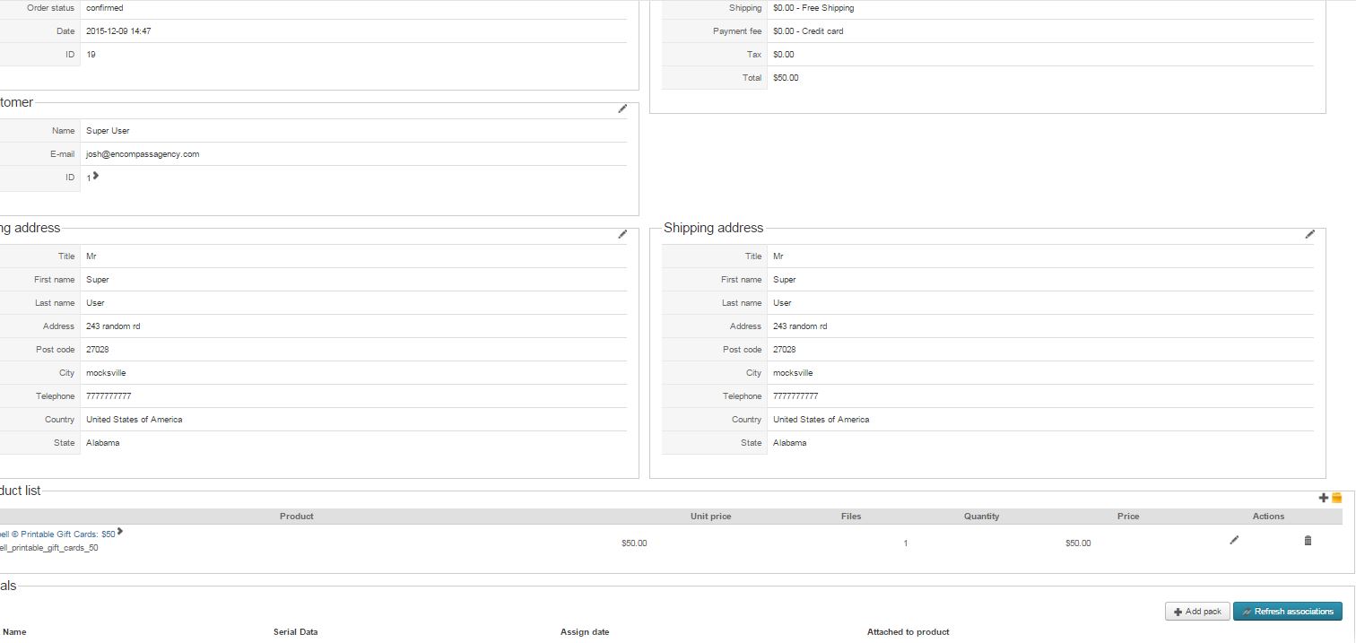

- If all is okay, you can go in the HikaShop order edition in the backend and click on the button "refresh association".
I'm not telling you that it is the solution and you need to click on that button for each order.
I'm asking you to perform that action ; so I need you to do that and tell me if the button "refresh association" fix the issue.
Depending that result, we will be able to go forward on more checks.

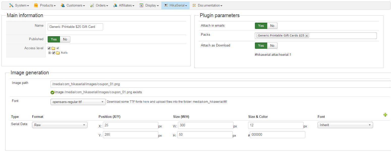

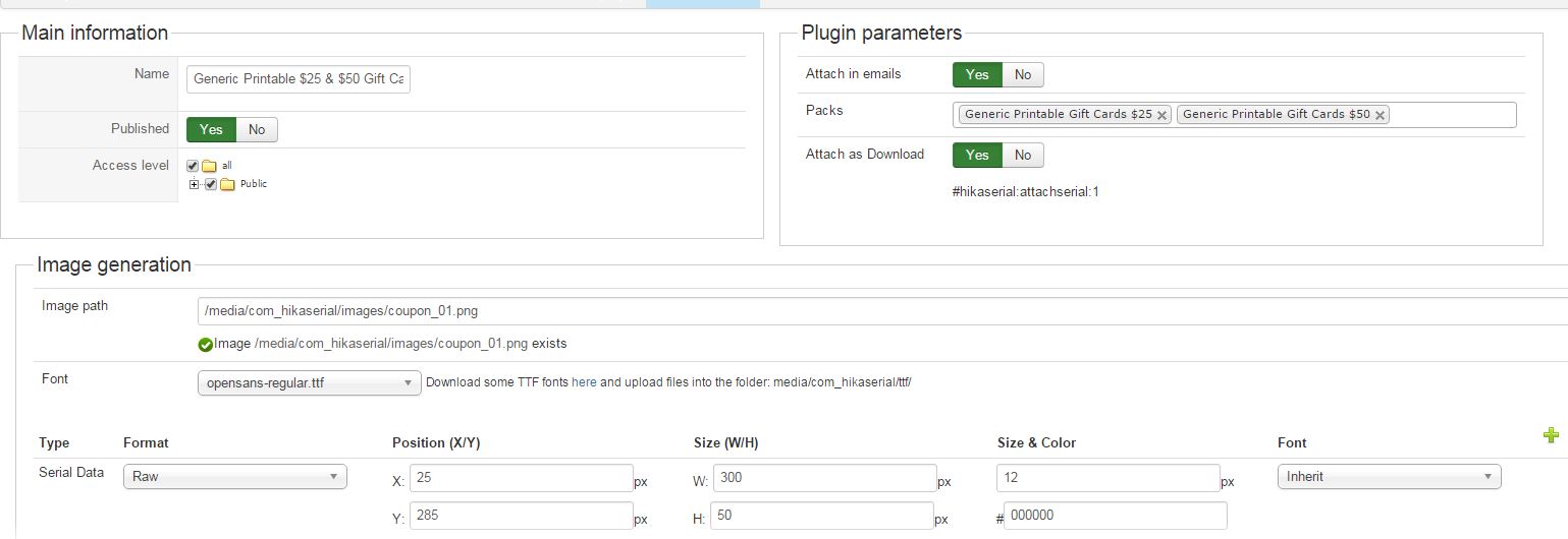

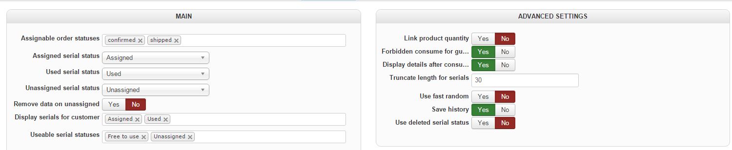

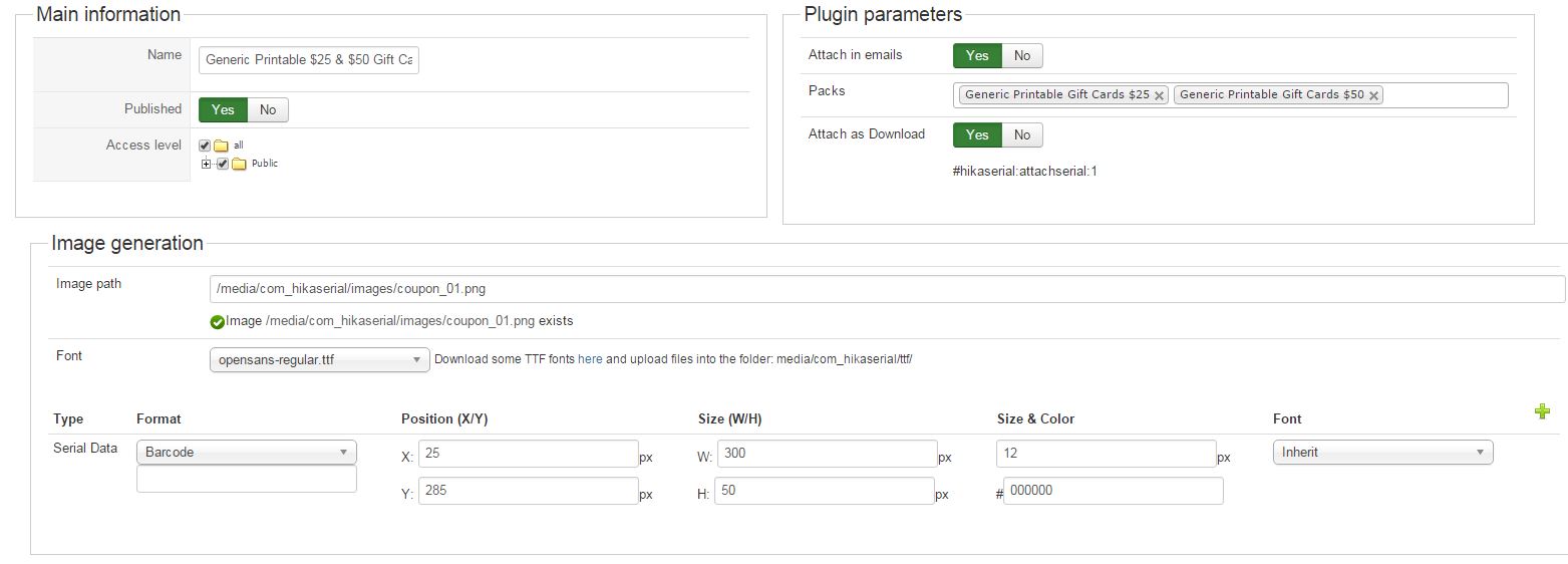

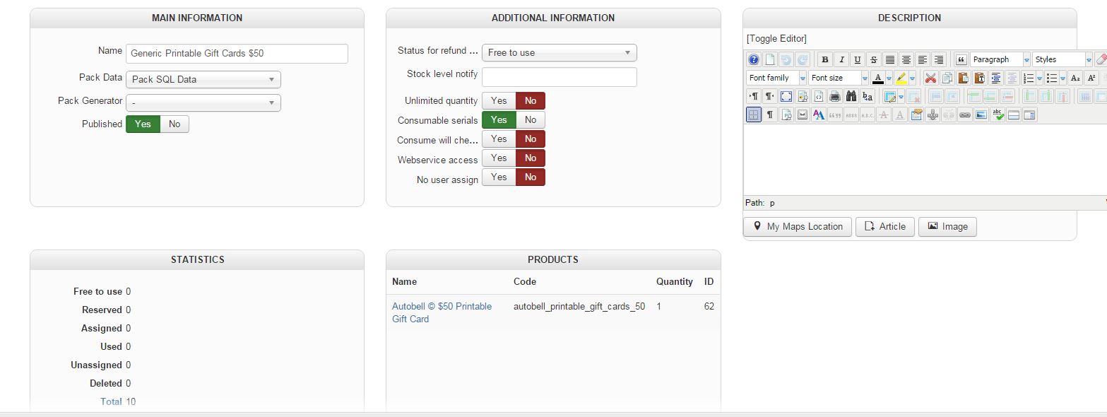

I am using the latest version of hikaserial HikaSerial 1.10.1 as I am the same person who had you add the button to not allow duplicate serials during a csv upload.
I uploaded a screenshot of the hikaserial configuration settings, hikashop product variant settings with the pack attached, the order which default is set to confirmed., pack settings, serial settings, and serial attach settings.
Please let me know if you need anything else.
Last edit: 10 years 8 months ago by jschroeder.
  • Posts: 165
10 years 8 months ago #223648
Sorry I sent the wrong screenshot of the serial attach settings this is the correct one!

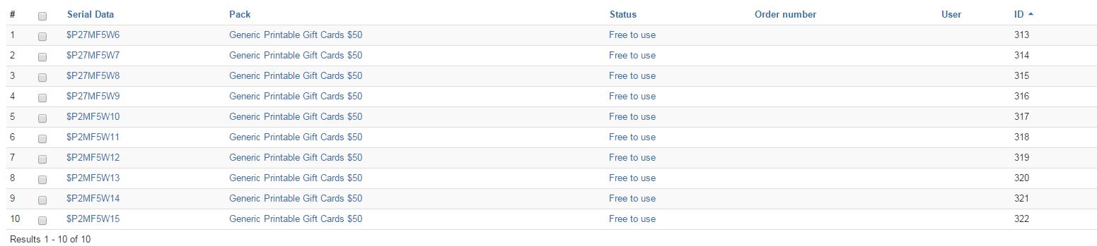

10 years 8 months ago #223649
If you look at your screenshot "pack-settings", you will see that the statistic indicates that there is no "free to use" serials.
But there is a total of 10 serials.
www.hikashop.com/media/kunena/attachment...61/pack-settings.jpg
So your imported serials does not have the right serial status.
I suppose that you set "Free to use" which is the translated text and you didn't use the namekey which is just "free".
I will see to update the HikaSerial documentation in order to talk more about that specific point.
So, for the moment HikaSerial does not have any serial available for the assignation.
You can see to edit your serials and change they order status and use "free" next times for your impots.

The plugin "attach serial" only accept barcodes with the format "ean13".
If the serial is not compatible with the format, the result is a blank image.
The support of the other format (for barcode and qrcode) in the plugin has been implemented few days ago and is already ready for the next release.
For the moment, you can just edit the "attach serial" plugin and change the default format in the function "generateImageBarCode".

I figured everything out now, but how do I increase the size of the barcode? I changed the width but it does not seem to increase size. I really think this should be a setting of some sort in the back end of the site. Currently the barcode is way to small and needs to be about 3 times the size it is currently.
  • Posts: 26381
10 years 8 months ago #223962
www.hikashop.com/support/documentation/1...ns-attachserial.html
The size settings "width" and "height" allow to change the "line width" and "height" into the barcode generator library.
By default the width is "1px" and the height is "60px".
By setting "3px" and "180px", the lines will became 3 times larger and the line height will be also 3 times bigger.
