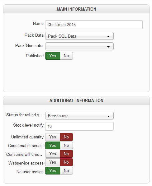

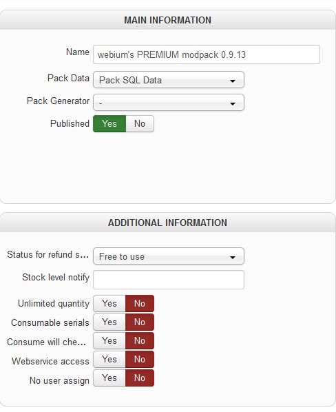

  • Posts: 3
10 years 8 months ago #223755
Configuration:
1. Serial pack (should be NOT consumable)
2. Serial pack (this one is consumable, and the user is assigned after order confirmation)
pls. let me know if you need more
thank you
Last edit: 10 years 8 months ago by webium.
  • Posts: 26381
10 years 8 months ago #223761
The setting "consume will check/assign user" is made to also perform the user assignation during the consumption.
If there is already a user assign, it will just check but if there is no assignation, it will perform it.
The following user(s) said Thank You: webium, Ron
