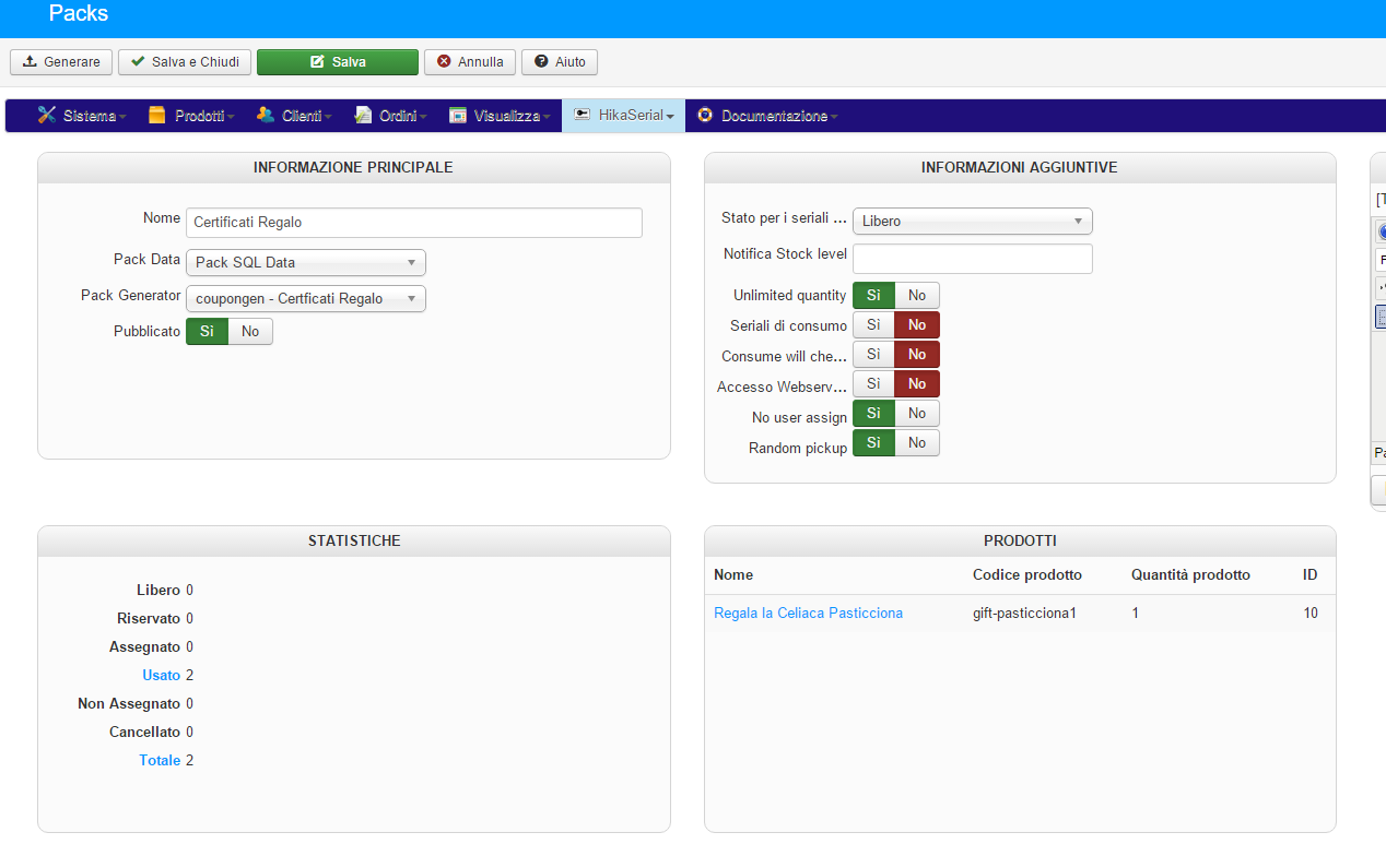

1. i create generator with coupongen plugin
2. i create a pack having 'pack generator' = the value create in step1, and in 'product' i add a product having his price.
Now happens that a user can buy the product 'gift card', the order is created, in the email order there is a serial on its foot.
On hikaserial, serial, i see a new serial create with 'used' status.
if an other user try to use this serial on 'coupon' field during a purchase an error says that the coupon is invald.
Certainly i not do some config step or i don't understand the hikashop functioning .

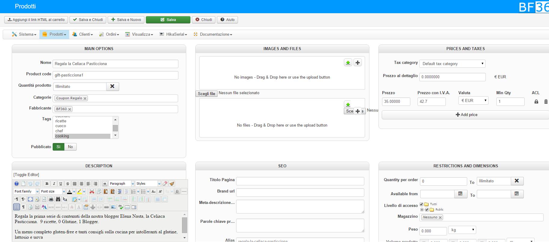

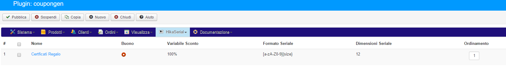

I attach the screenshot of coupongen, of pack and product

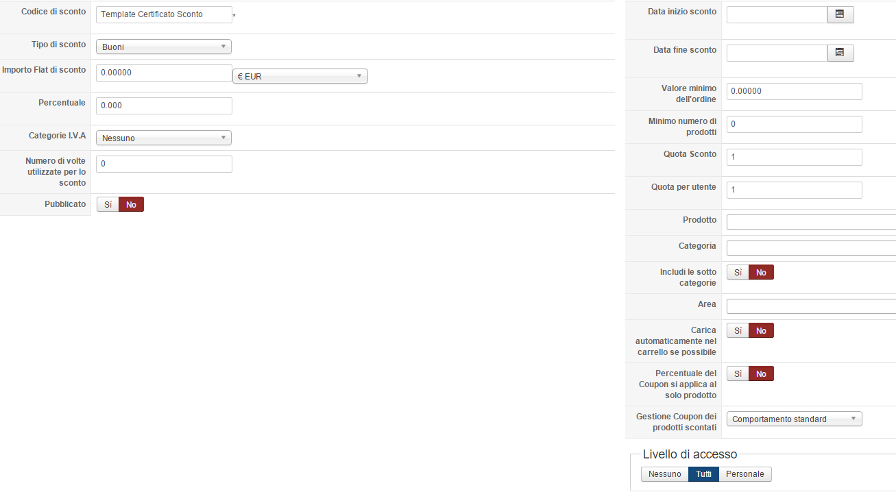

UPDATE: i create a coupon on hikashop as template to link it on coupongen, but issue remain.

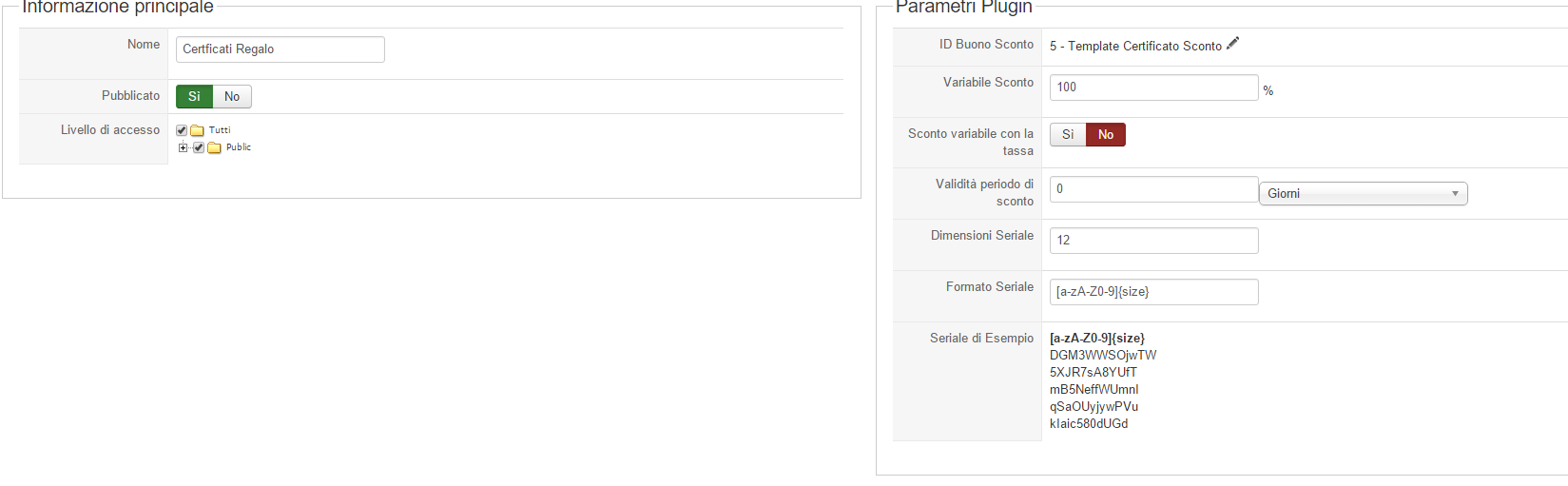

Please note that the "coupongen" plugin requires a valid coupon template in order to work properly ; as it is explained in his documentation :
www.hikashop.com/support/documentation/1...ugins-coupongen.html
With your message update ; you said that you added a template.
If you didn't have a coupon template ; the plugin can't work at all. So the issue is totally logical because the plugin will just generate a serial and not a coupon.
So ; please provide details of your coupon gen plugin configuration and about your coupon template configuration.
Then, you'll need to check your HikaShop coupons in order to see what your "coupon generator" created.
More than that, the screenshot of your product configuration is currently not useful but it show that you have a javascript error in the website (the inputs for the upload) ; I think that you have a Joomla popup issue.
CF : hikashop.com/forum/install-update/879271...to-3-4-4.html#214269
(Please check the edited part in pointed message)

HI! tnx for your help...here i attach a screenshot of the configuration of coupongen plugin and of the coupon template.

Jerome! i dont know how, but i wrong something yesterday.
Adding a coupon template and link it to at coupongen the system works correctly
Sorry for my oversight
