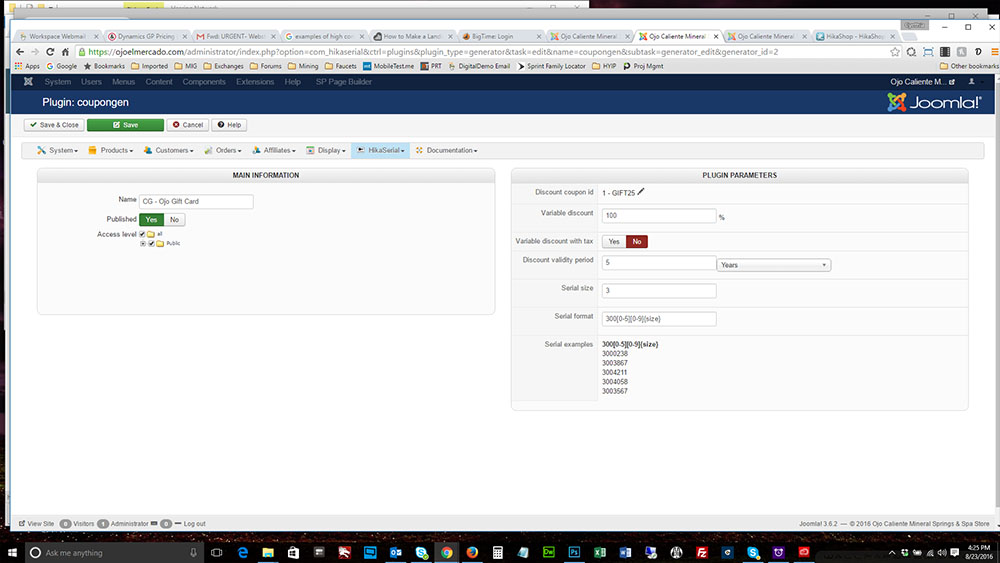

Good afternoon,
I just got an email from a client. It seems that the coupon gen plugin for HikaSerial that we are using to create gift cards is generating duplicate serials. It has only happened once so far. How do I prevent this from happening? I looked at the two orders to make sure it wasn't a typo on the client's part, but no - they truly are duplicate serials on two separate orders.
Any help would be much appreciated. I have attached the config screen for the coupon gen plugin in case you need it.
Many thanks,
Leslie
  • Posts: 26381
9 years 11 months ago #248321
Regarding the configuration of your generator ; it is logical.
You have only 999 possibilities and because it is do it randomly, the chances to generate a number twice increase rapidly with the number of serials.
I warmly recommend you to change your coupon generator configuration in order to introduce a bigger range.
