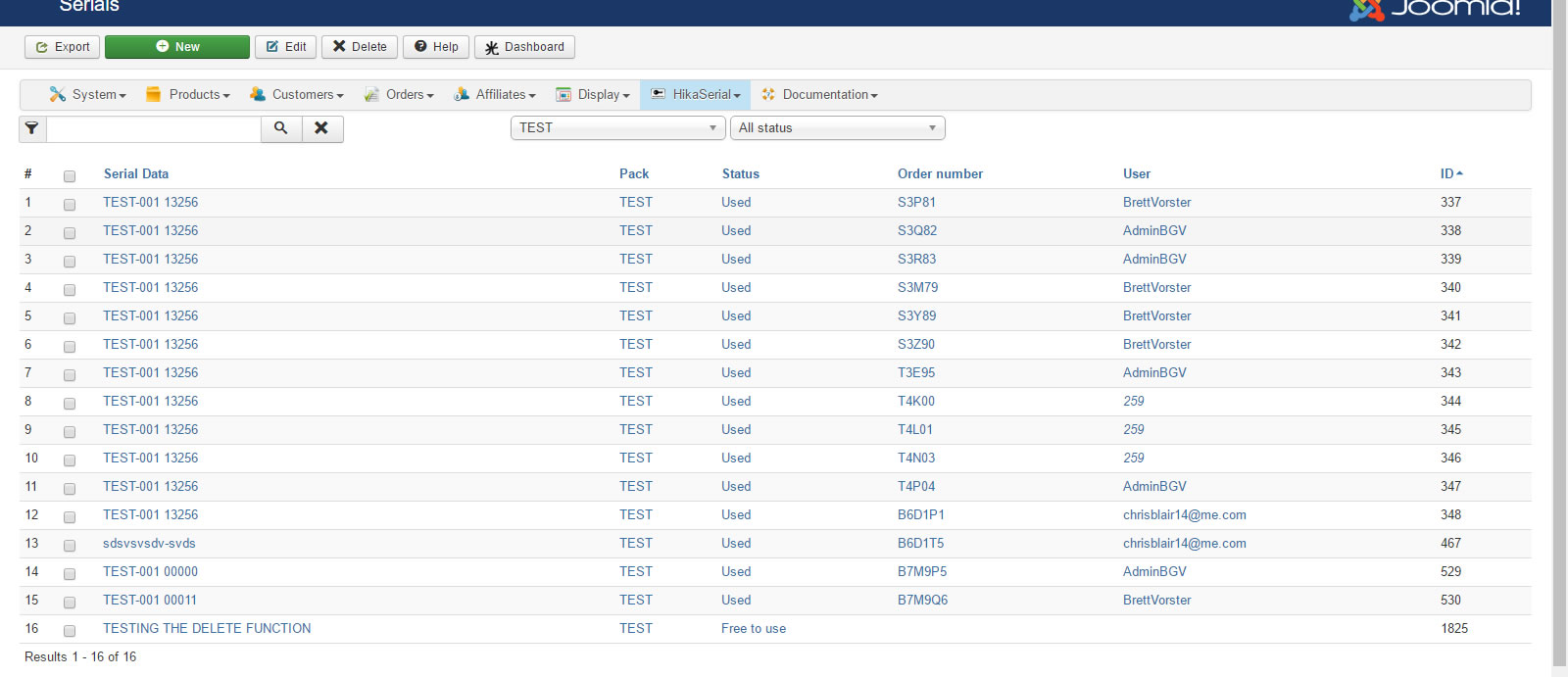

I did read about the 2 step delete thing... But its odd because now I set that to YES... or whatever and then deleted the serial once and found it in deleted where I deleted it again... But I get this error:
You have an error in your SQL syntax; check the manual that corresponds to your MySQL server version for the right syntax to use near ') AND serial_status = 'deleted'' at line 1 SQL=DELETE FROM #__hikaserial_serial WHERE serial_id IN () AND serial_status = 'deleted'

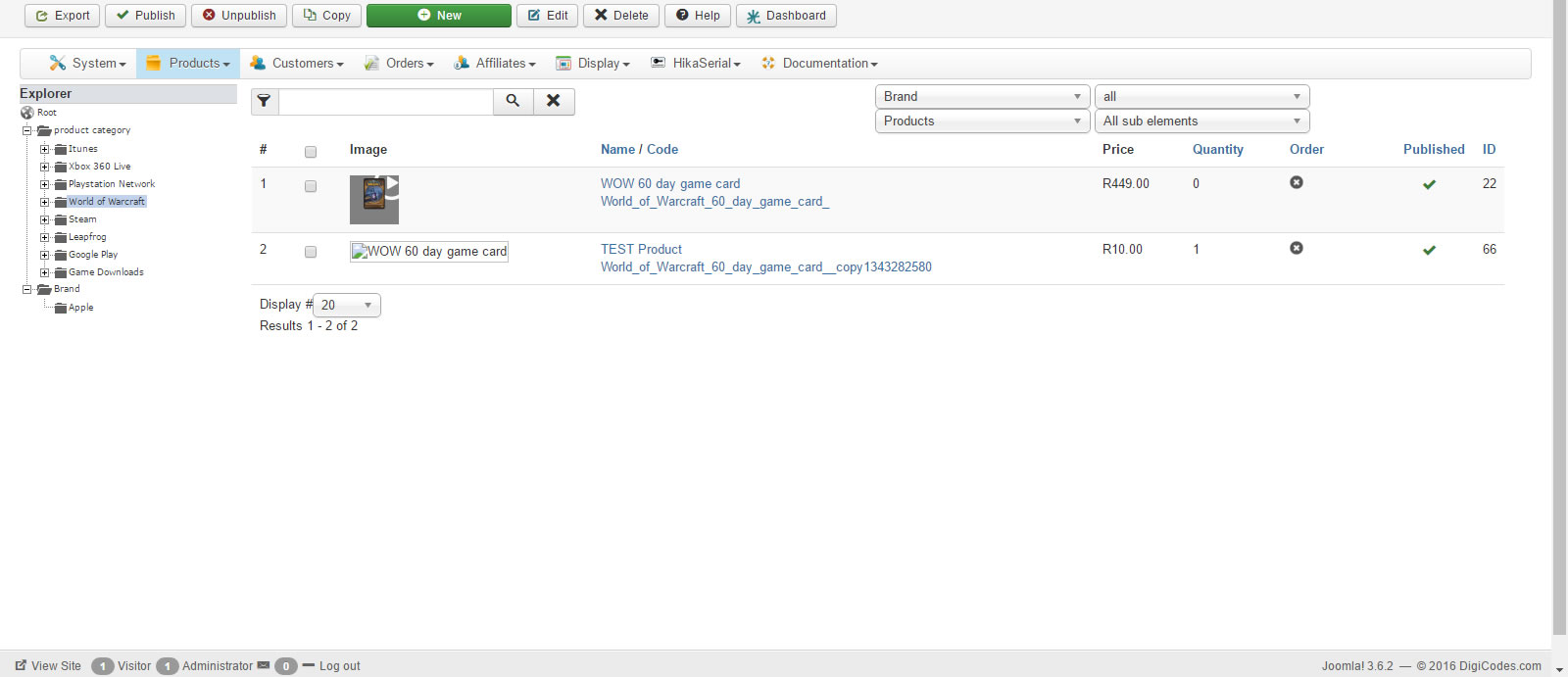

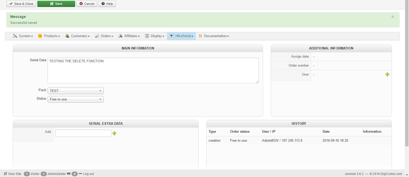

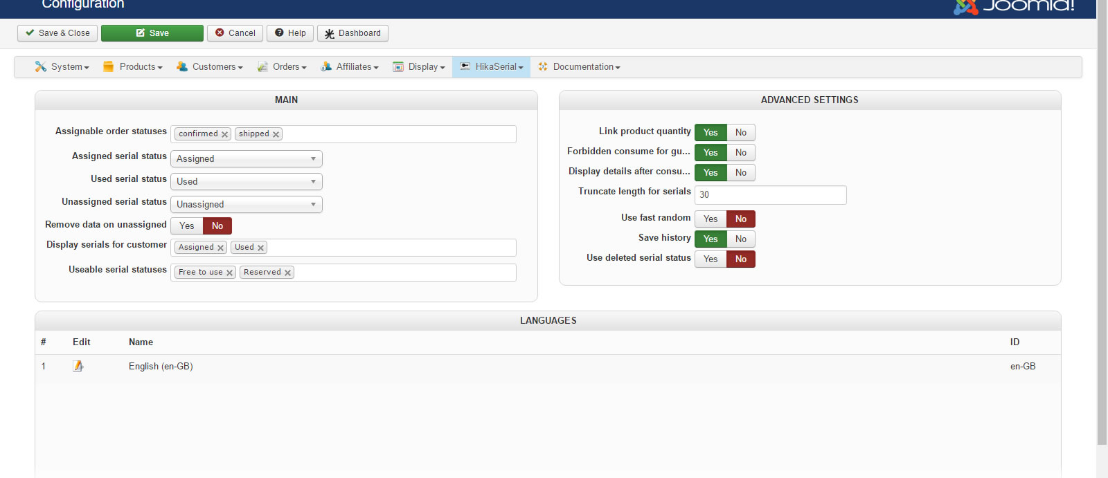

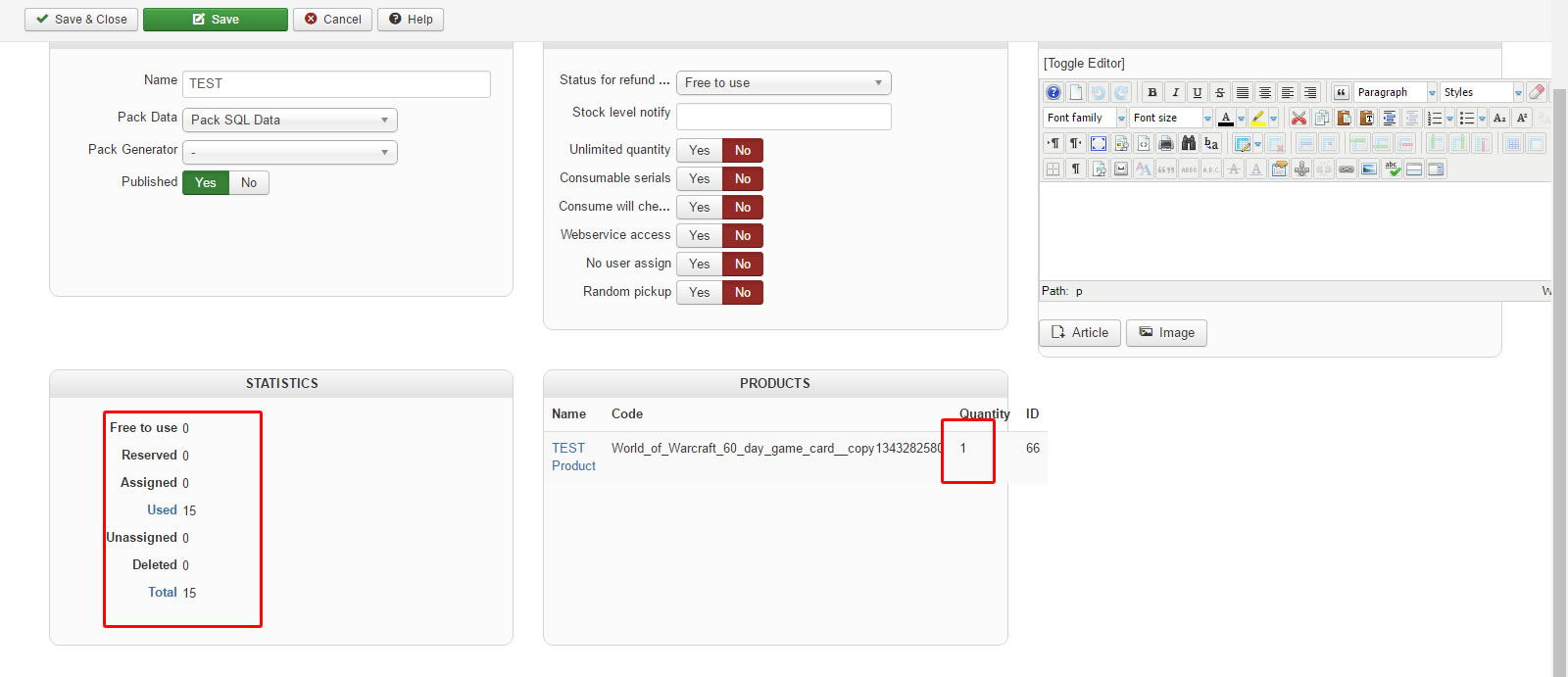

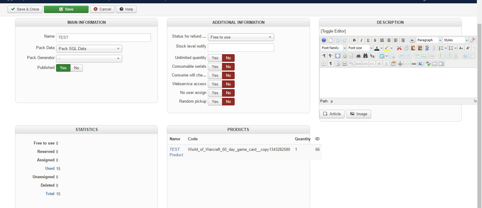

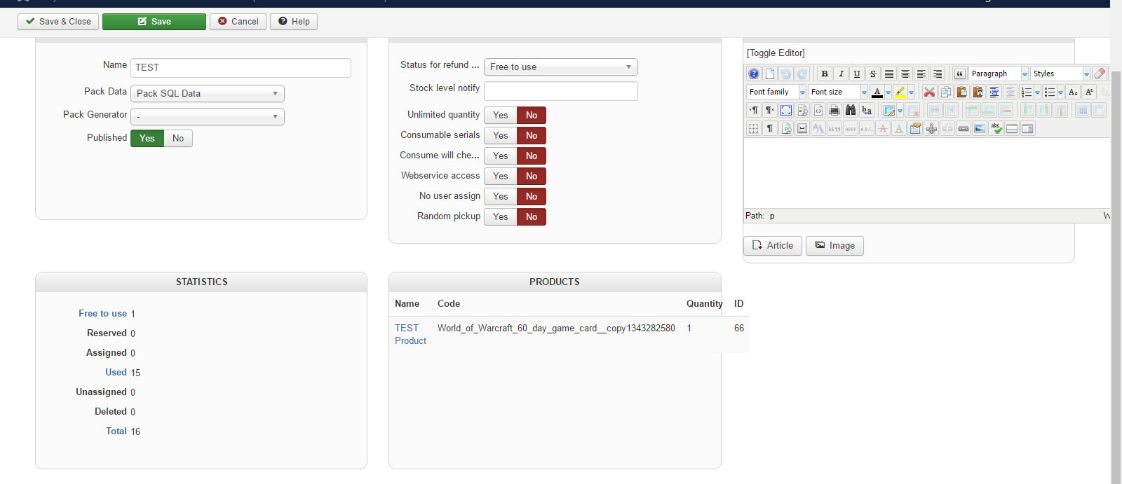

Sure, thank you for gettign back to me... Okay so I can confirm those 2 lines in my serial class... Which is strange. I've attached screenshots of my serial config, my pack config and my product config.... They are all doing the same thing though....
I have added and then deleted a serial to a test pack. We are manually adding the serial code. Then using the delete button to remove it.

* I created two serials in the backend (for the pack "TEST")
* I displayed the test product in your backend : The product quantity was 2.
* I deleted one test serial
* I refresh the test product in your backend : The product quantity was 1.

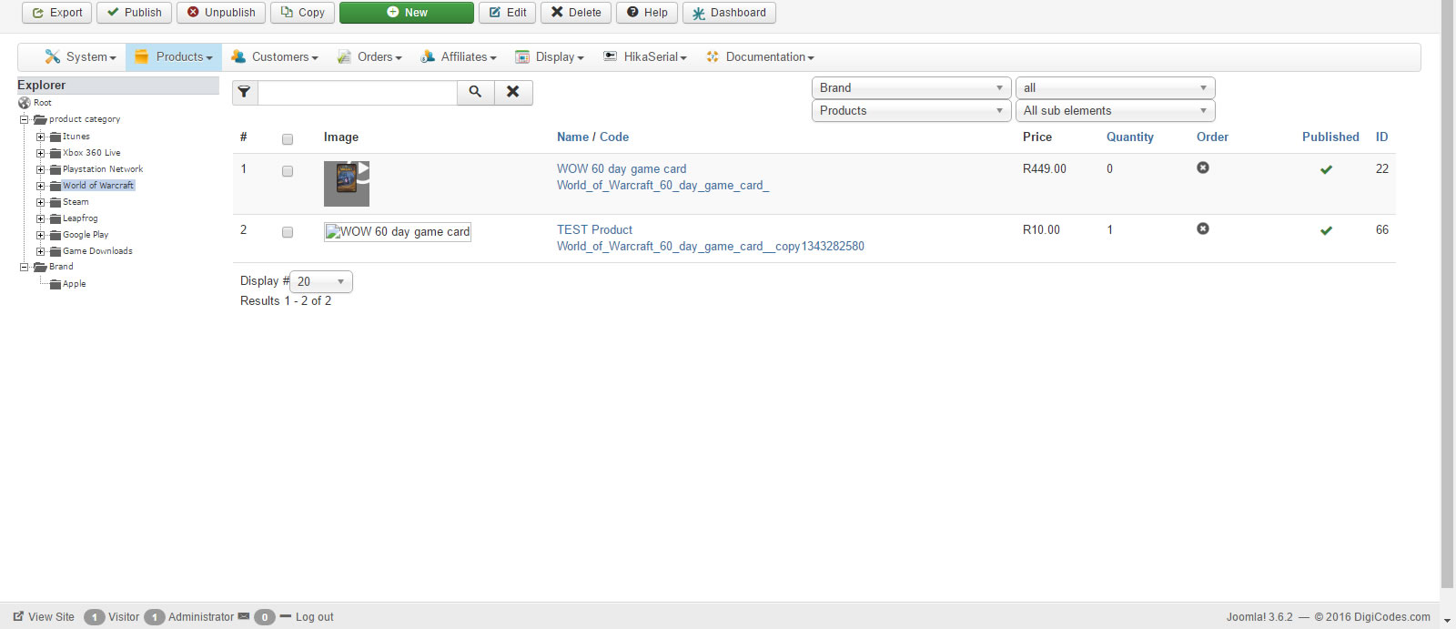

I dunno, something is not right here... You see I have now manually deleted that one that was left and I still see one as stock... on the backend when I view the product and on the frontend.... But in the serial pack there is nothing available...
So its the same really... still doing that..
Take a look - Warcraft test product

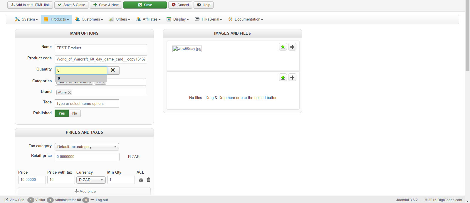

Yup, just ran another test to check... manually deleted the count from the Hikashop product count - reset to Zero. No Serials in the pack - no count on the product. Then I created a new serial in the pack - refreshed and the product now showed the count of 1 (1 added) great.... But then deleted the serial code - refreshed and still shows a count of one on the product fronend and backend - but zero available in the pack or under the serial filter.... so not picking up the actual count....

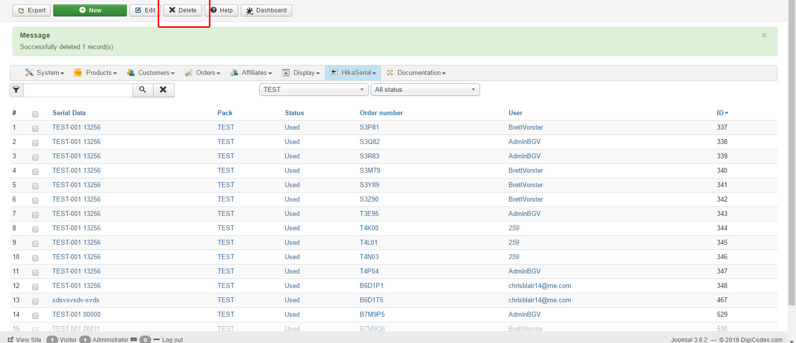

I deleted it with the button that says delete in the serial list view - Like on the screengrabs I sent you...
So for your testing, please I have added one serial and deleted it. Its still showing stock - how do you explain that? (When there is nothing there in the serial list?)

First point - your issue was just when the serial quantity step down to "0".
Second point - I don't know what the hell with MySQL which return some completely incoherent results.
The query gave me a list of products and corresponding number of serials ; some with a "0" quantity (like it should) but, not all products where listed... Just incoherent.
I don't want to know if it coming from some weird and insane optimizations in the MySQL engine but the fact is that, it was returning uncompleted data. So I modified the original query in order to force him to not cut the result data and return ALL products.
While I don't have any kind of weird results in the test server ; your server gave me variant results (and something different results with the same query and the same content in the database).
But the good news is that the new query will force MySQL to not do some optimization job and return all the asked data.
So HikaSerial can know the quantity of serials for the product "66" and update it afterwards.
