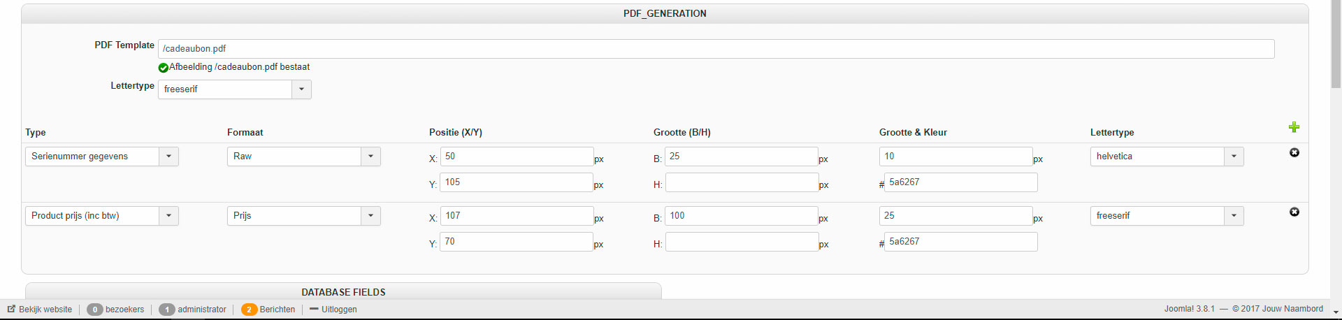

Yes the fonts show up now and can be used. But still I don't get the eurosign to get placed properly into the pdf. See attachement, the font used for the price is the freeserif UTF-8 font. As far as I know Arial should show the € sign as well. The same lib is used for the "Attachinvoice" plugin, isn't it? In that plugin I don't have any problem with the eurosign.
It looks like the html code used in Hikashop for the price is not the correct code for the pdf generator. This looks like a technical issue?

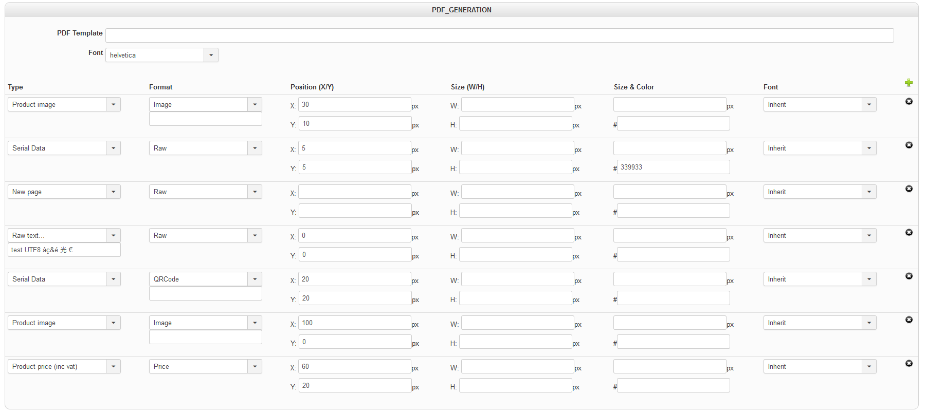

I'm sorry but I do not have your issues in my end.
I'm using Helvetica font and I can display € manually of via the "price" format.
Afterwards, there is no support of extended UTF8 (for the Japanese character for example).
And in the HikaSerial configuration, It's TCPDF which is used.
I also perform a test using a PDF template (to use FPDFi) and it worked the same.

I can't open your test pdf (error: can't open). It's strange that it works well on your side, why should't it on mine? My config for the pdf doesn't differ much from yours. When entering RAW code the € shows well, but no success with the € sign in the productprice. See screenshots.

Why not simply configuring your currency to right use the € character and not it HTML version ?
www.hikashop.com/support/documentation/1...p-currency-form.html
The following user(s) said Thank You: jouwnaambord.nl
  • Posts: 515
  • Thank you received: 22
8 years 10 months ago #279939
Never saw that one coming... :) I use Hikashop since 2011 and never changed the Currency settings. Attachinvoice always worked fine, so didn't think about that! Thanks, that was the solution.

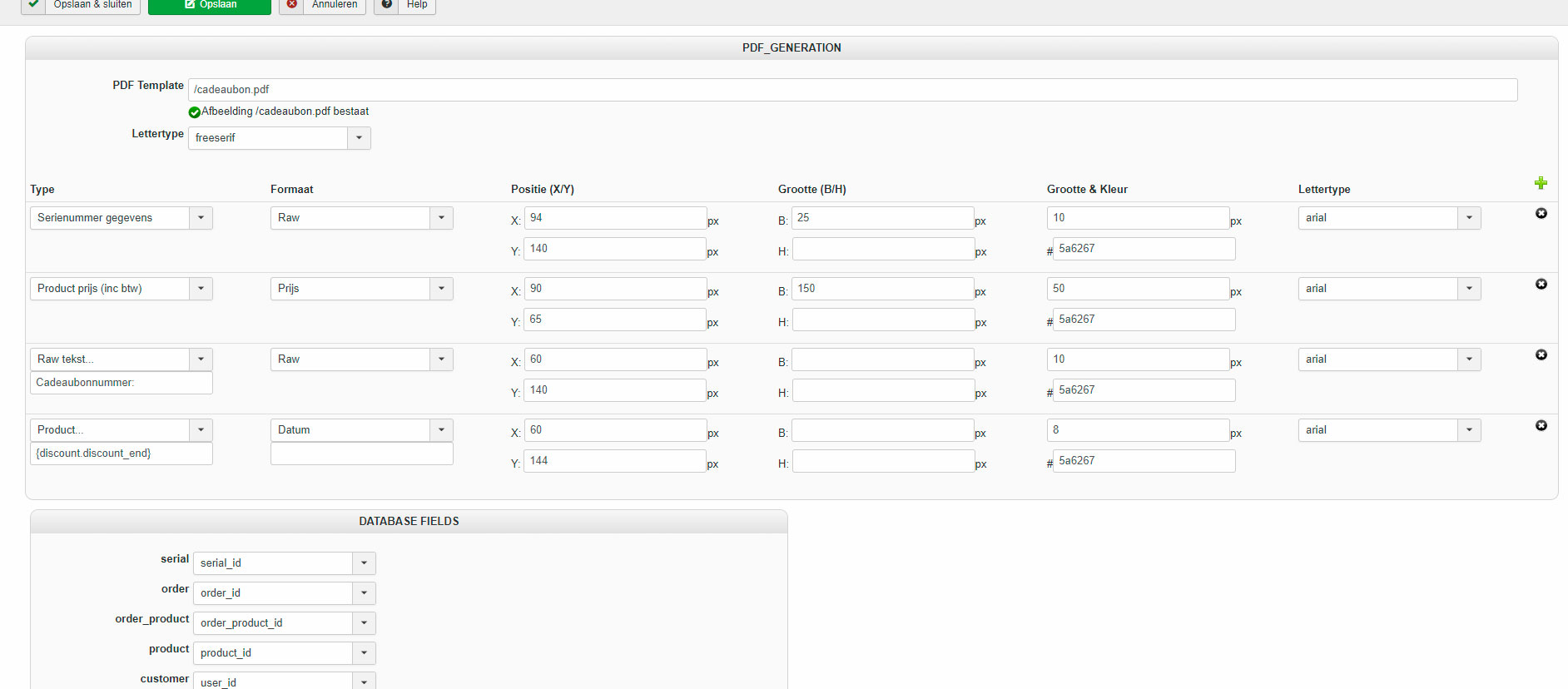

One other thing, I'm trying to add the "end date" on the pdf so the user knows when the coupon will expire. I used all kind of codes but can't find the right one.
The column where the date is stored is {hikashop_mpw_discount.discount_end}, but I get no data on the pdf. What am I doing wrong?
  • Posts: 26381
8 years 10 months ago #279976
You can't access to the discount via the "Product..." since "Product..." is accessing to the product table.
But if you're using the Coupon generator ; you will see that the generated serial got some "extra data".
In these data, you'll find the discount end date ; named "validity_end".

Ok and how do I attach this data to the pdf? I used the "Serialnumber..." table in the TYPE field of the pdf, but no data shows up. Do I have to use brackets for the fieldname "validity_end"? And do I have to add a path or just the fieldname? I can't find any info on this...
  • Posts: 26381
8 years 10 months ago #280180
CF : pasteboard.co/GOhIm8M.png
When using the coupon generator :
Serial...
extradata.discount_end
When using the time limited generator :
Serial...
extradata.validity_end
  • Posts: 515

8 years 10 months ago #280233
