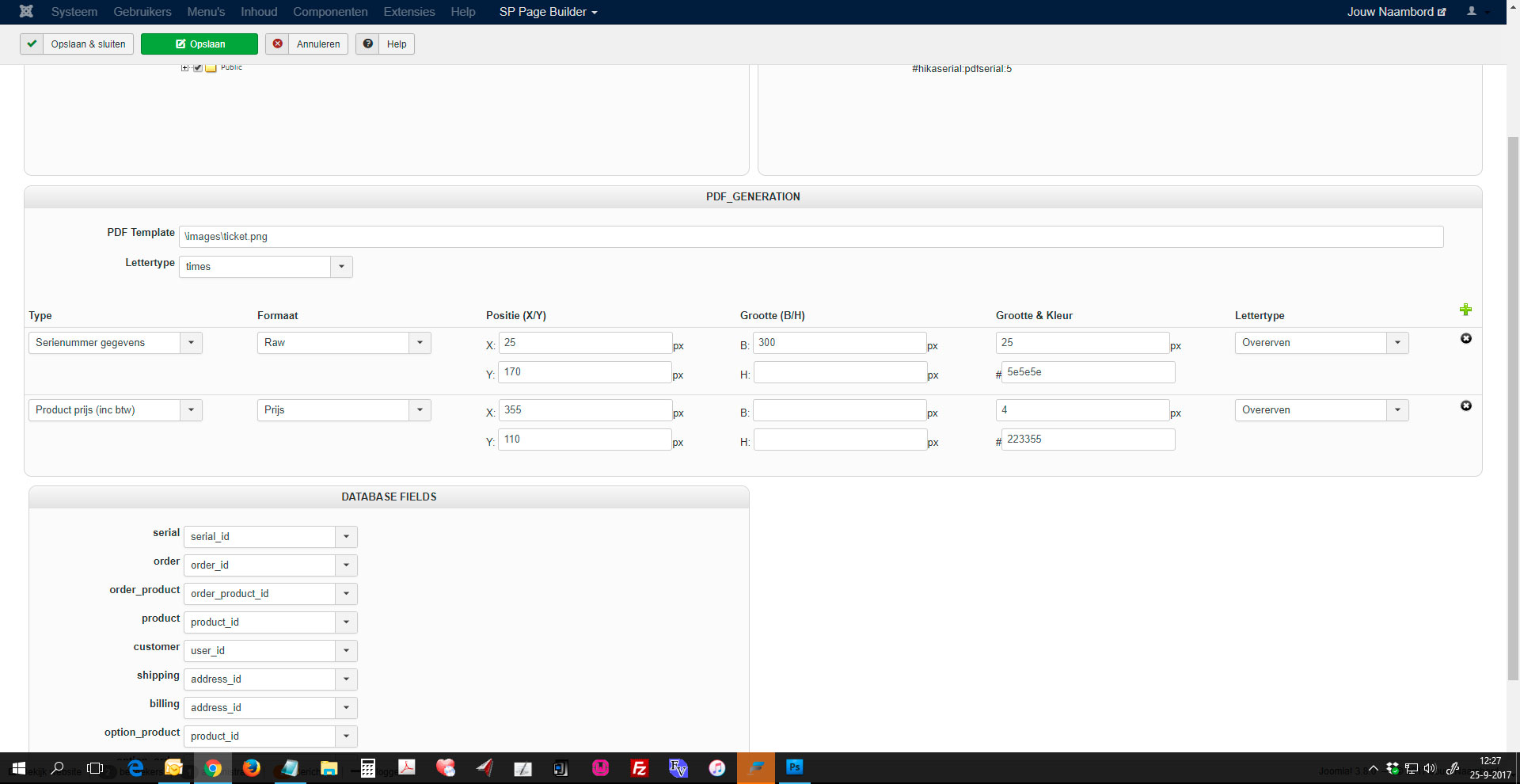

Just purchased Hikaserial. Took some time to figure it all out, but now it's working. But I can't get the pdf-plugin to generate a coupon with my own background. Tried a test with the "ticket.png", but that doesn't work too. The PNG coupon is fine, but the pdf gives a empty background as if it can't find the base-image. I used the same path as in the png (attachserial) plugin, but it's not working. What could I do wrong?
  • Posts: 26381
8 years 10 months ago #279075
The "PDF template" setting do not accept images ; it requires a PDF file which will be used as a template.
If you want to use a PNG ; you have to use the plugin "attach serial" which is meant to generate images (and not PDF)

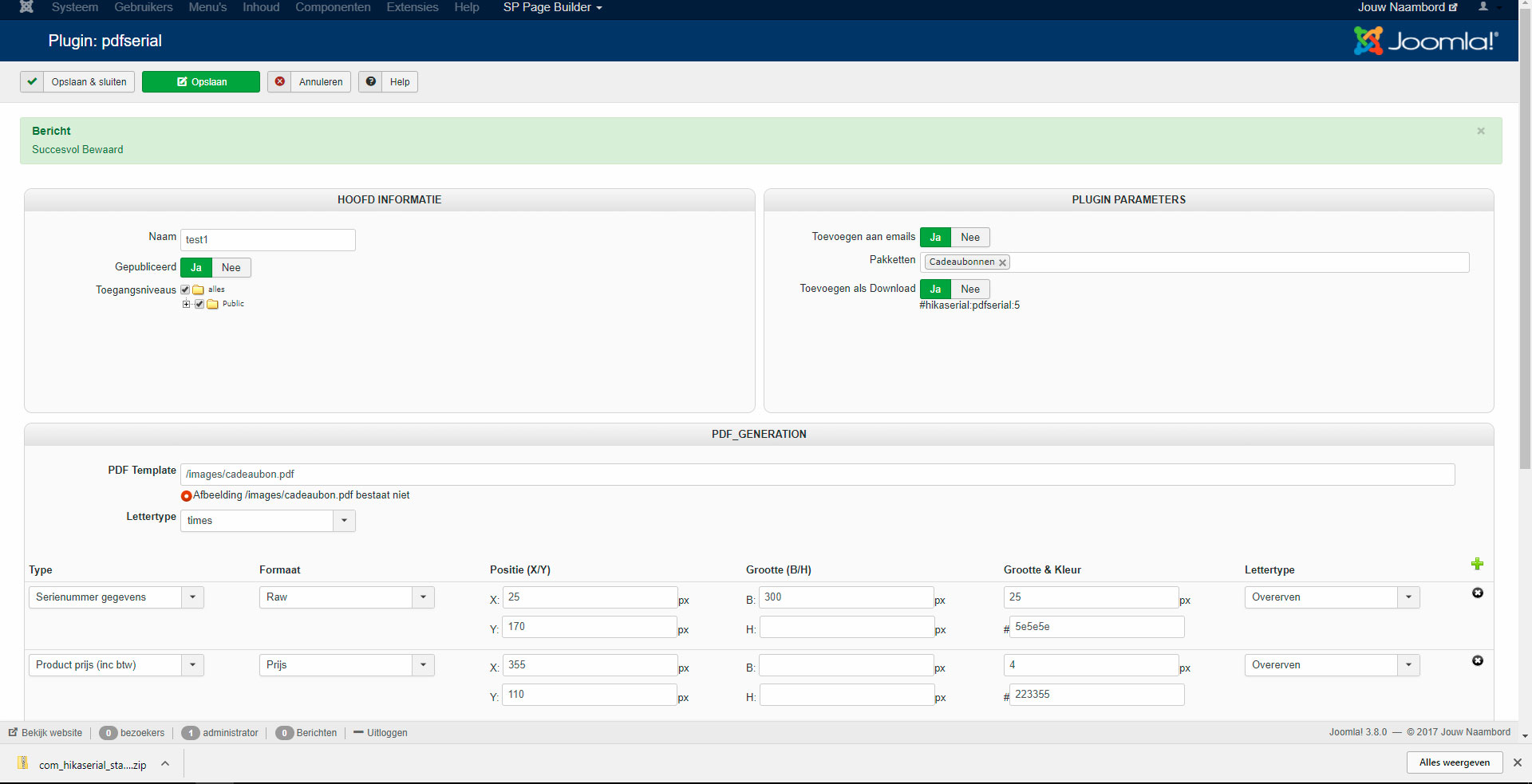

Hi Jerome,
Thank you. Unfortunately the indicators message is "image doesn't exist", but it does and is in the right folder.
  • Posts: 26381
8 years 10 months ago #279250
My previous message was there to indicate you that your setting is not correct.
Please read it carefully and change the setting to just put the relative path.
Thanks to the patch you will know when it's right ; in your case you just need to remove the folder (which is not required and invalid at the end).
  • Posts: 515
  • Thank you received: 22
8 years 10 months ago #279309

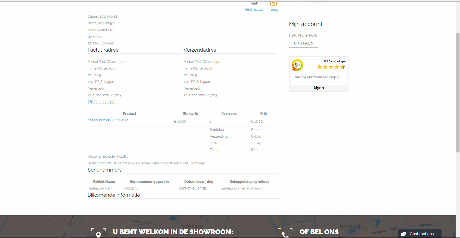

Sorry, my mistake, usually a relative path starts at the root. That's solved, thanks.
The pdf is send to the customer as attachement in the email, but it doesn't show on the orderdetails in the frontend for the customer. The serial info is shown, but no download is available (see screenshot).
  • Posts: 26381
8 years 10 months ago #279316
If you want to provide a downloadable file ; you need to add a "file" to your product.
And instead of providing an URL, you give the code that the plugin indicates you in the configuration (just below the "yes/no" of the attach as download setting).

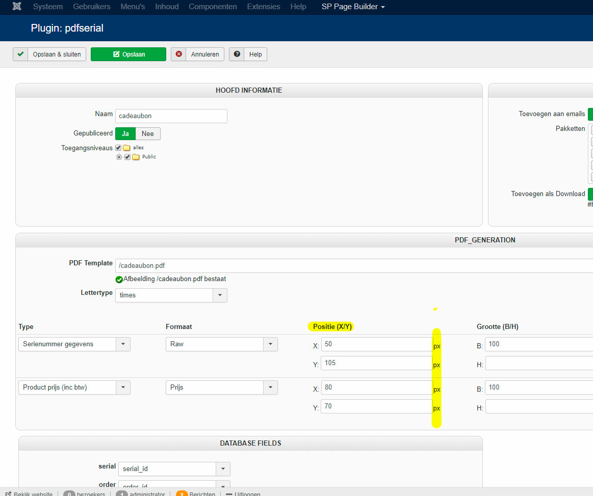

8 years 10 months ago #279556
Thank you! Could it be that I was somewhat misguided as the pdf layoutsheet has pixels as input instead of mm (see screenshot)?
I want to add the price to the giftcard, but none of the fonts accept the standard € (eurosign), see screenshot.
Last edit: 8 years 10 months ago by jouwnaambord.nl. Reason: added generated pdf
  • Posts: 26381
8 years 10 months ago #279598
My bad !
Because I forked the "attach serial" plugin to create the "pdf serial" plugin, the configuration view did not evolve a lot.
I'll change that.

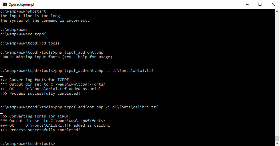

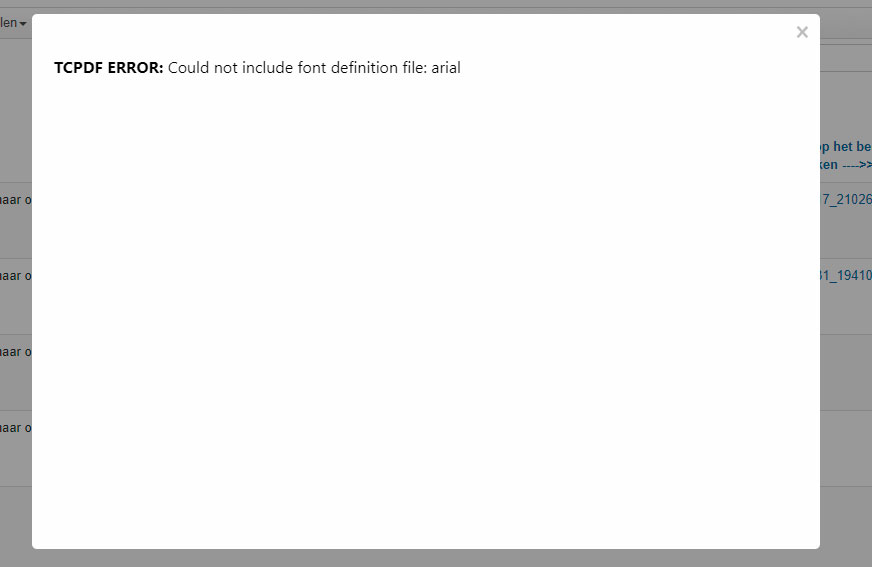

8 years 10 months ago #279640
Ok, I did understand and tried that earlier, but I get an error, see screenshot. I placed Arial.ttf in all 3 the folders to be sure, but no success.
  • Posts: 26381
8 years 10 months ago #279642
You have to put fonts from the TCPDF lib itself.
Unfortunately, it does not work with TTF files ; it needs special converted files.
So please download TCPDF to get the fonts from it.
As I told you the fonts of that lib are huge and I can't include it into HikaSerial.
  • Posts: 515
8 years 10 months ago #279741
Sorry, I think I need some more help by that. Downloaded the package, used the tcpdf_addfont.php to generate pdf font. I get 3 different files (calibri.php; calibri.ctg.z ; calibri.z) wich I copied to media/com_hikaserial/fonts/ . But the new font is still not recognized. The font files are quite small, so maybe I'm doing somtehing wrong?
Please let me know the procedure how to get the correct large files your talking about?
