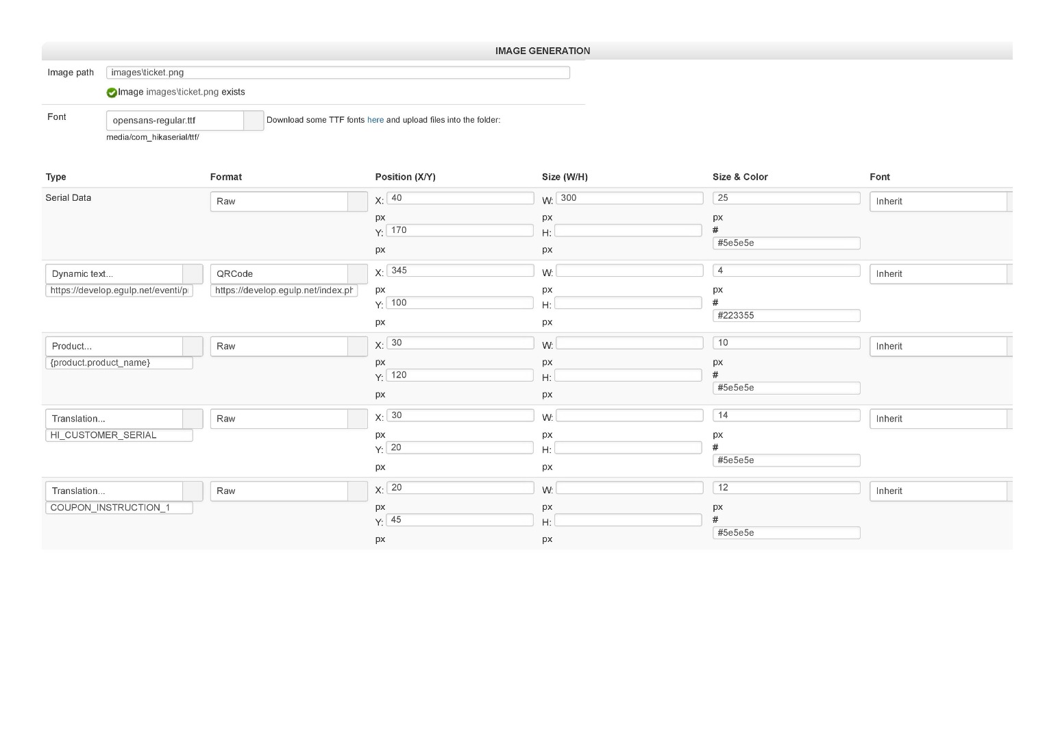

3 - I configured the Attach Serial plugin following a little bit the example the example;
Now, as far as I understood the most important line in the image generation is:
Type: Dynamic text = don't understanding where is the error I added directly te product URL like: https://YOUR_WEBSITE_URL/...
Format: QR Code = I added the URL https://YOUR_WEBSITE_URL/index.php?option=com_hikaserial&ctrl=serial&task=consume&hikaserial[serial_data]={serial.serial_data}&hikaserial[format]=html

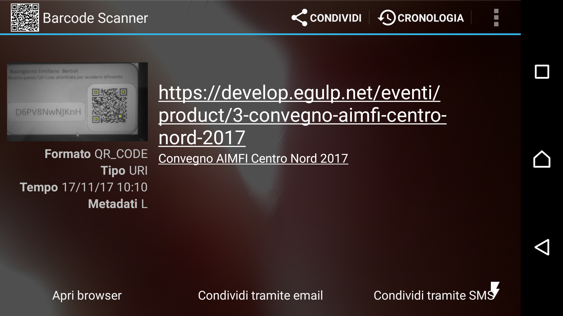

--- I scan with the Barcode Scanner App the QR Code and I click on the shown link
The Event product page is opened, but no "consume" messages and the Serial Status is always "Assigned"

Here the "Attach Serial" screenshot and the Barcode Scanner App screenshot I have back when I scan the QR Code

You missed the last part of the tutorial documentation regarding the configuration of the "attach serial" plugin :
www.hikashop.com/support/documentation/2...ticket-tutorial.html
You are using an URL to the product page ; not a consumption URL as describe in that tutorial.
(And please do not put any setting under the "format" of QRCode ; all you need is to put the URL in the "type" column to specify your value of dynamic text)

2 - Before to change the second entry "Dynamic Text" the third entry "Product" (shown in the attached image) was shown in the Barcode Scanner reading the QR Code.
Made the correction to the second entry "Dynamic Text" the third entry "Product" is not shown anymore.
I'd like to add also the event name in the image,but I don't understand How tohaveit back...

Because the configuration that you posted cannot work for the third entry since you're using "Product..." and afterwards you enter a value for "Dynamic text" ; when you're using "Product..." you just need to put the name of the field you want to display.
As far as I can see regarding your screenshot, it did not work before.
3 - Please read my messages very carefully. Even text in parentheses.
If you take a look at your screenshot you will see that you put text in a lot of inputs, even the wrong ones.
Instead of that incorrect content which would generate more issues than other thing ; you need to enter the real parameters for the QRCode.
