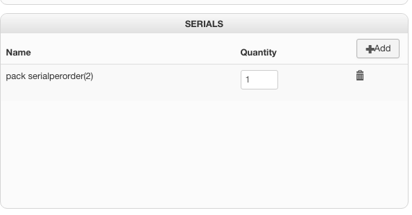

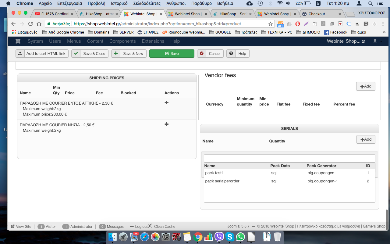

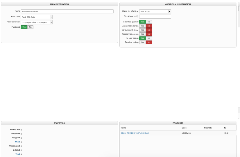

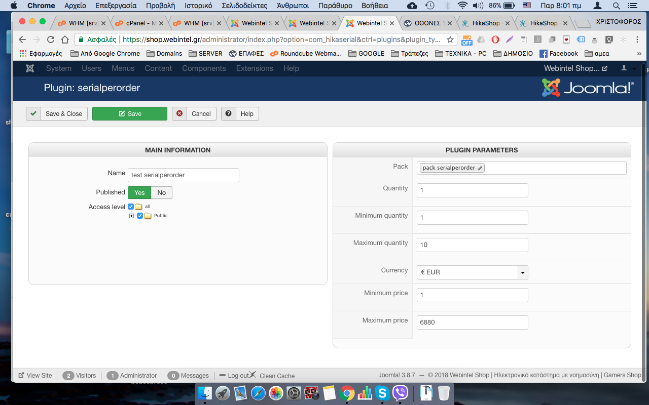

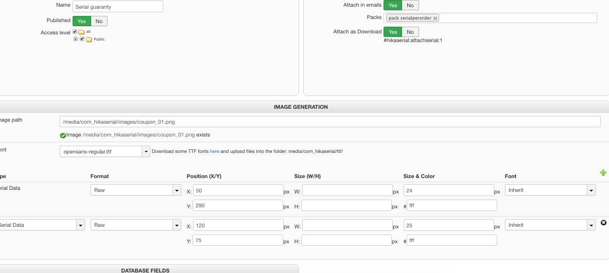

I managed to add a pack in the product. An older hikamarket version was causing the problem.
But still I can t create a serial per product. If you can see the printscreens I ve done what you told me. I really don t care to create a serial with the order. But If there isnt another way, its ok. I d prefer to have a serial number for guarantee purposes for every item in the stock of every product.
Please advice.
Last edit: 7 years 11 months ago by verzevoul.

Regarding your screenshot, I do not see a pack assigned to your product ; the last screenshot show the selection but there is nothing in the table, so no assignation.
Which old HikaMarket version are you using ? Maybe we can find a way to avoid the overlap of the JS lib.
