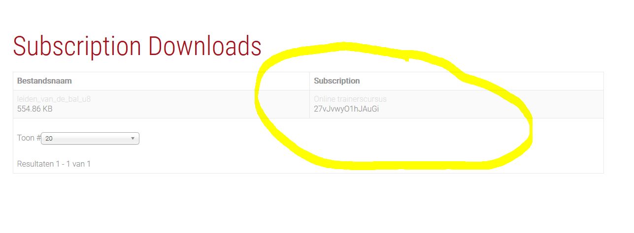

I want to offer an online course for football training. I want that people pay an amount per year. And every week there will be an item available for those who paid for the subscription.
I made a product for the subscription.
I have created a plan called online course. After the customer paid the subscription fee I will upload a file each week.
I created a download area where the customer (after having logged in) can see the courses.
So far so good.
When the customer goes to this area he sees the uploaded files but also the subscription. See attached. Is it possible to delete this marked in yellow?
Many thx

The best way to remove that content would be to perform a view override.
You have to customize the view "subscription / downloads" in order to remove the second column of the table (or to display something else).
More about customization of view : www.hikashop.com/support/documentation/1...-display.html#layout
