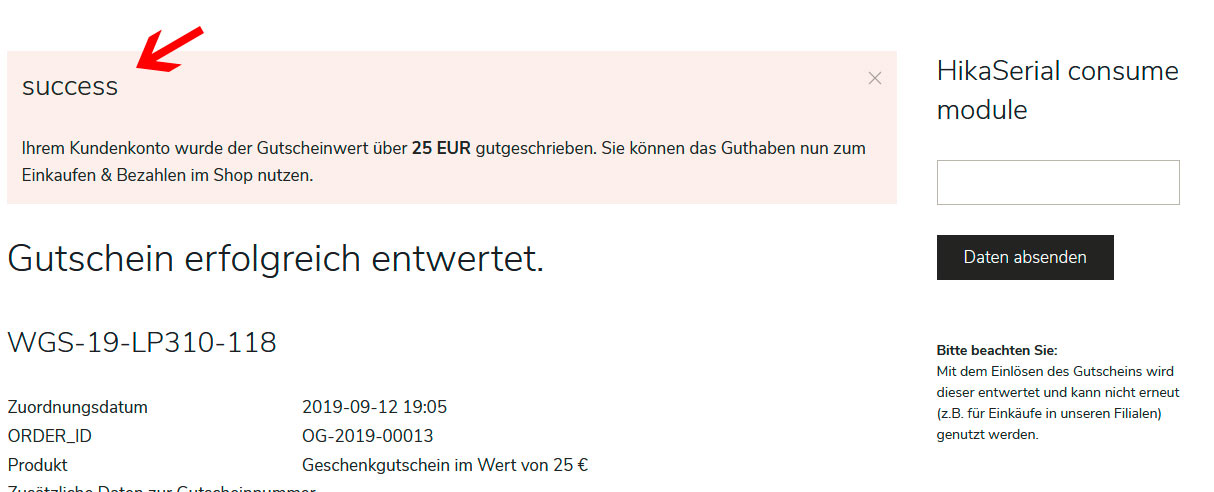

we set up the module for serial consumtion. Everything works fine and we got a result page. There (as shown on the image) is the word "success" in the alert box. We need to change this - but even though we searched in the hikaserial language file as also in the hikashop we didn´t find it. Anyone know where to change this?

yes, sorry for the missing information. We customized the output allready. We use the points consumer plugin. The translated text below was in the language files, but the word "success" isn´t there at least as far as I can see.

In the pointsconsumer plugin, you will the line
$app->enqueueMessage(JText::sprintf('HIKAPOINTS_EARN_X_POINTS', $points), 'success');
You can replace it with
$app->enqueueMessage(JText::sprintf('HIKAPOINTS_EARN_X_POINTS', $points));
In order to not use the type "success" ; that type is handle by Joomla backend but not by the front-end templates.
