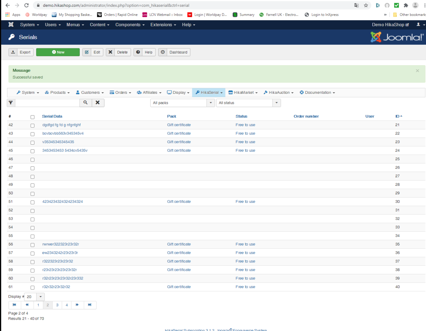

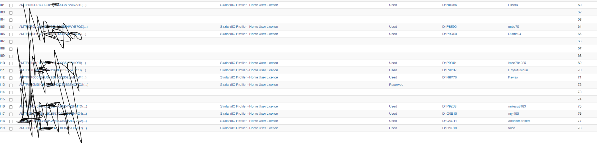

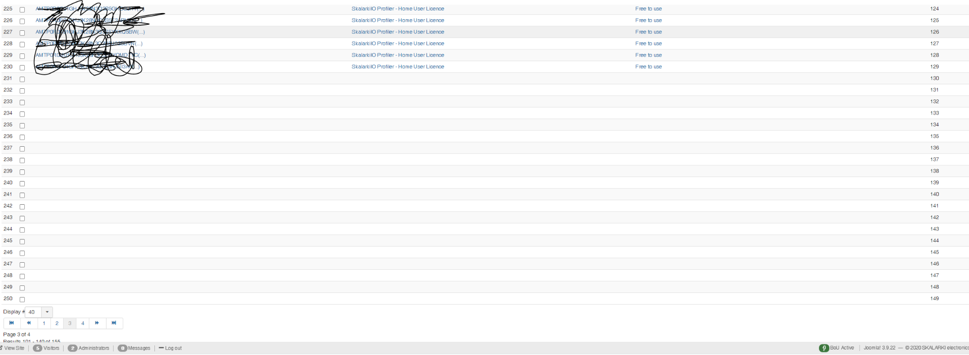

I have noticed today, strange behaviour.
I was adding manually serials to the list. At some point I have noticed empty lines between other lines. As I have 7 pages of serials I was checking on other pages if I can find more empty lines. I was very surprised when I found that by doing that empty lines were added to the list. So, every time I changed page empty lines were added.

Yes, on demo page it is wrong as well. Very easy to reproduce:
1. Add to the pack more then 40 lines, then you will see 3 pages in the page navigation.
2. Now jumping from page to page, each time system is adding two empty lines.

Please go now to the demo HikaSerial and try. I have created 25 serials. There is two pages of serials now. Every time you jump from one page to another empty lines are added to the list.

When you look at your screenshot, we can see a "successful saved" which means that a form as been posted in order to save some data.
So, with your last information, I suppose that you're using the pagination just after performing a serial creation and that the "task" is being kept.
In order to avoid the issue before a fix, use the "save" and "cancel" buttons instead of the "save & close". If you do use the "save & close" and you want to change the pagination, click on the heading "Serials" (which is also a link) in order to reload the page without the "task".
