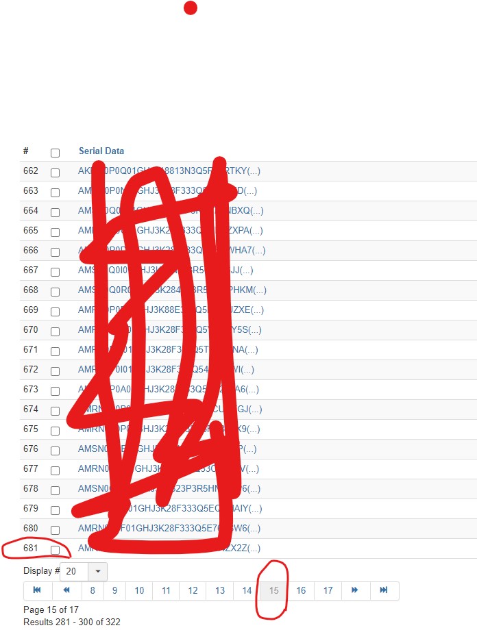

I reported some time ago issue with creating new serials, where after saving another empty lines were added. This problem was not fixed since then. Just reminder.
Today I have discovered another issue.
Lost serials or line numbers.

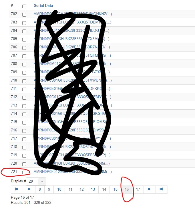

If you look on the page number and line number on both screens you will see that numbers from 682 to 701 are missing. This happens if you compare every two following pages. always between them 20 rows is missing. I think numbering lines routine is wrong somehow....
Is there any reason behind?

The first reported issue has been fixed but we did not release the new version yet.
Regarding your new issue, I can see that the end of the report listed 322 items ; which give 17 pages of 20 items.
So, the display of the # seems to be the correct one.
If you're talking about the HikaSerial serial listing in the backend, that display is perform via the Joomla pagination system :
echo $this->pagination->getRowOffset($i);
Since I can see the same kind of display issue in the demo website ( demo.hikashop.com/administrator/index.ph...kaserial&ctrl=serial ) ; I do suppose that there is something misconfigured in the Joomla pagination which make the counter inaccurate.
I'll look at the issue as soon as possible.
