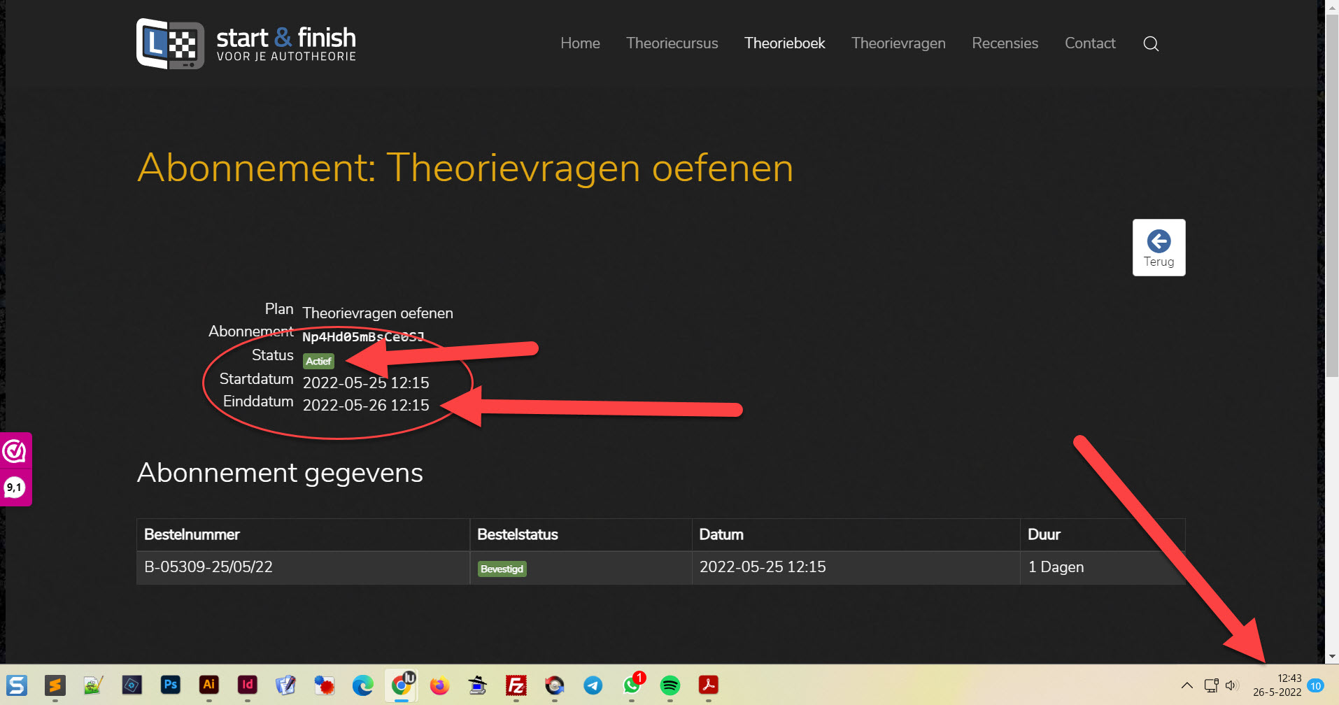

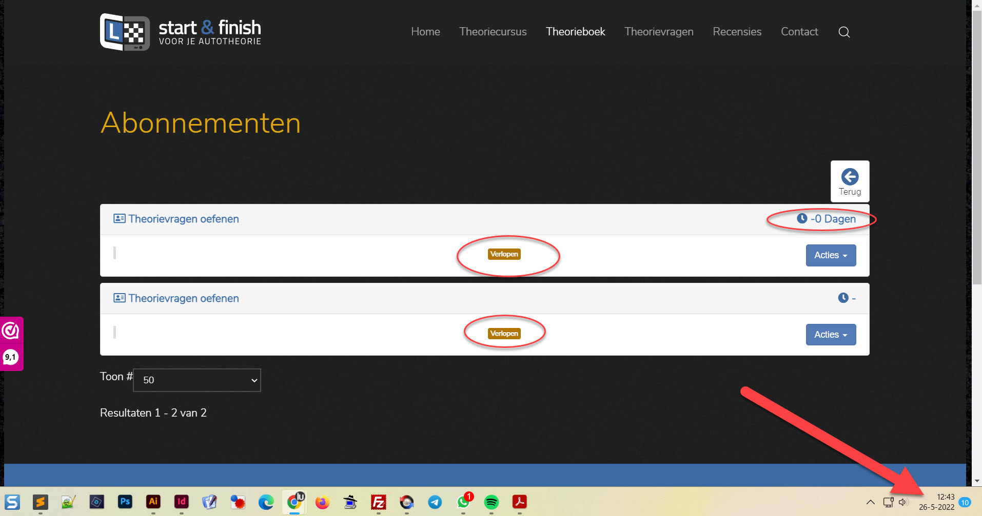

When you go to subscriptions it shows Expired (Verlopen translate to Dutch)
So that looks fine, but still we can see al the subscriptions pages and after a expired subscription that's not desirable
When we click on the subscription we see that the subscription is ACTIVE. How is that possible?

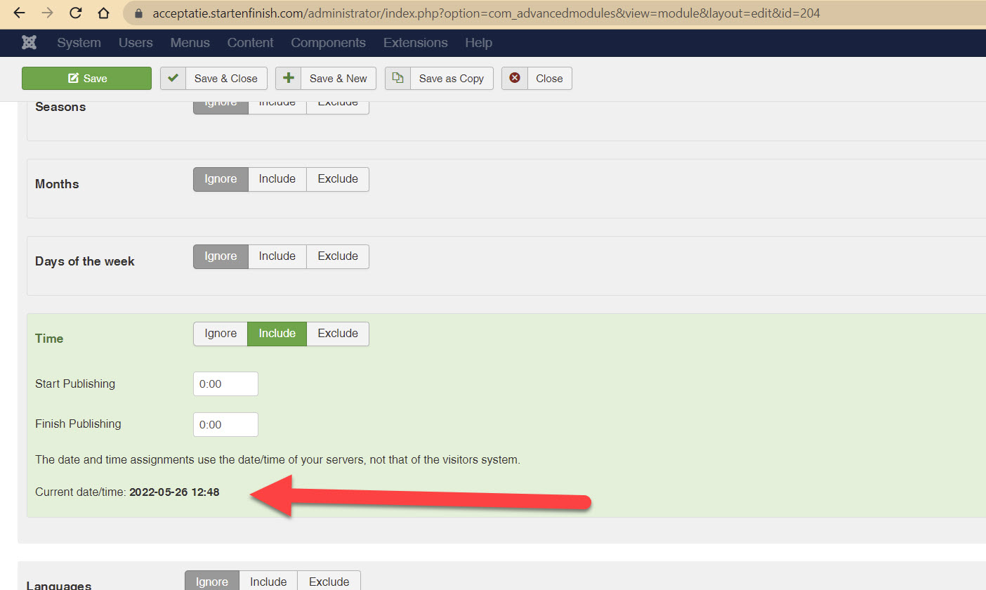

We checked our server time and that's correct.
Hope you can find out what's wrong here!
