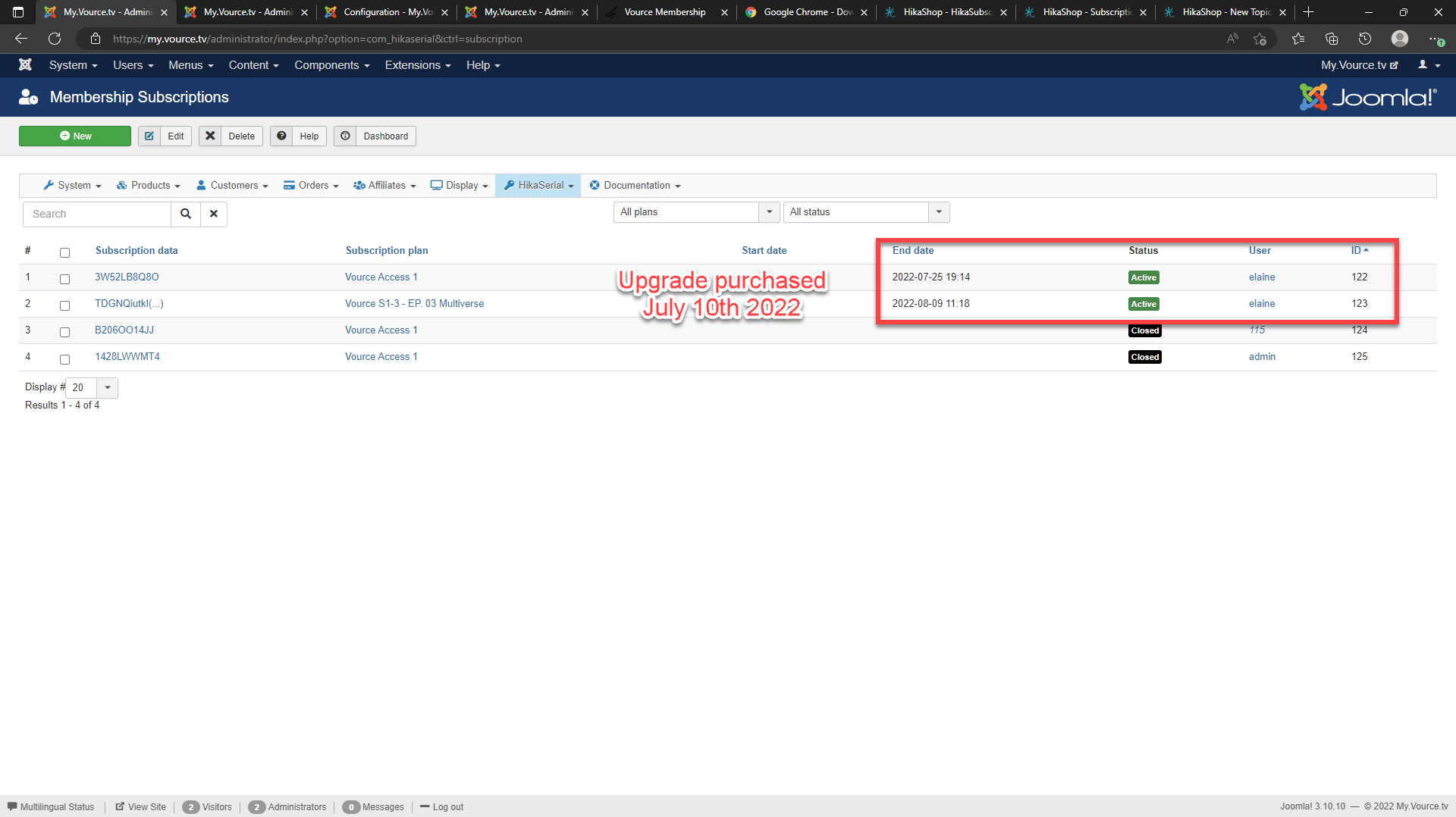

Please see image
Elaine, my example user, purchased a subscription 15 days ago, for 30-days at $14.
she still has 15-days left on her current subscription.
The user wishes to upgrade, so she purchases an upgrade to her subscription for $18 for an additional 30-days.
The new purchase only adds an addition 15-days to her current subscription.

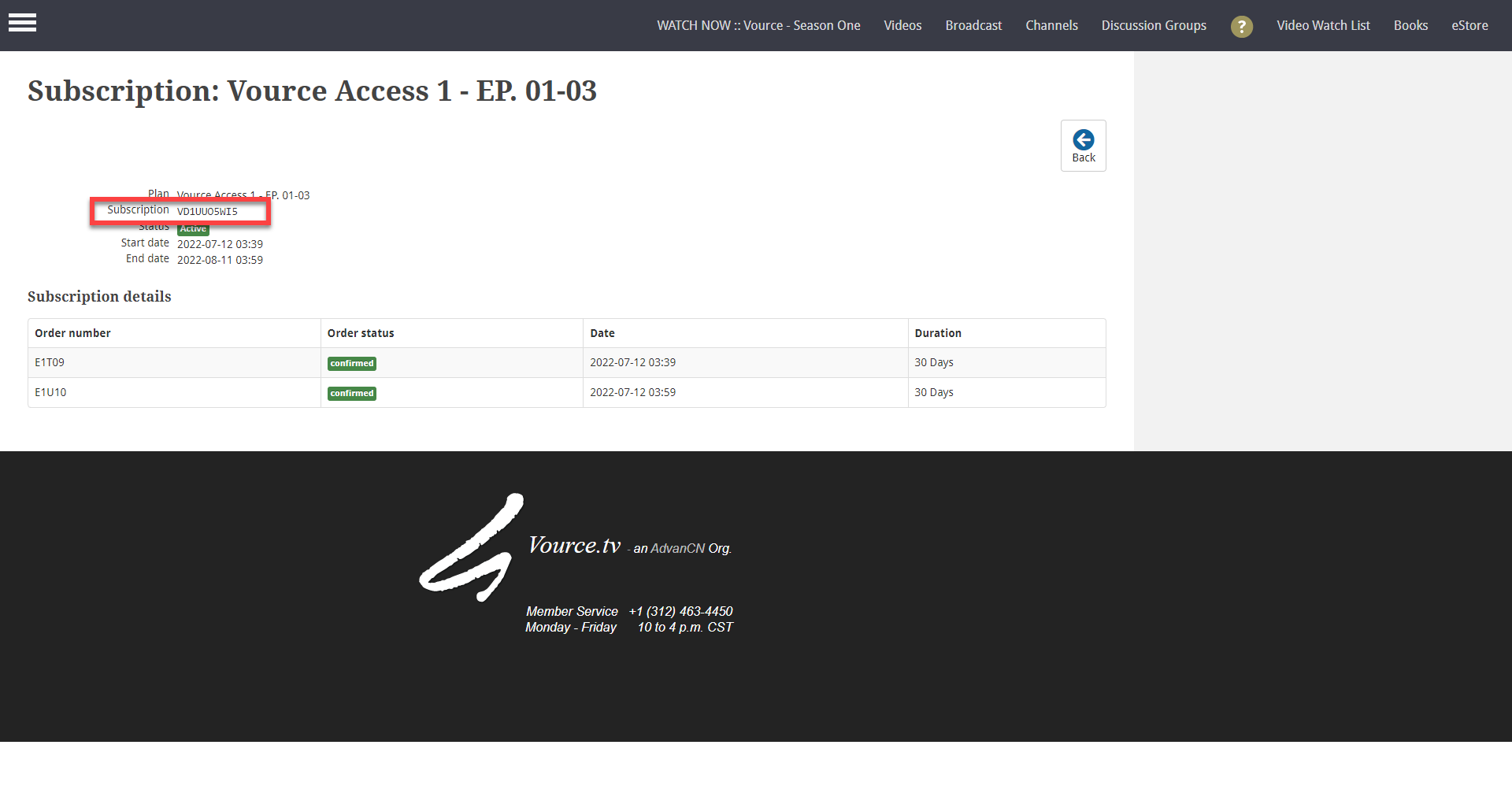

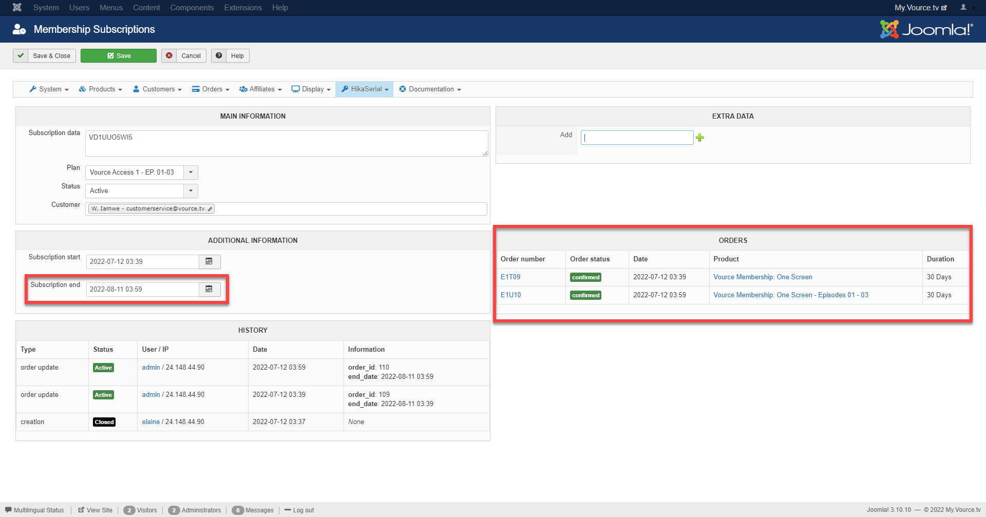

Hello Jerome,
Please view the attached images.
I created a new subscription see image: Membership Subscription Detail :: order id 109
20 minutes later I upgraded my subscription. No time was added to the previous order (id 109).
Last edit: 3 years 11 months ago by wrina iamwe. Reason: added images

3 years 11 months ago #343170
My apologies.
During the application of the upgrade, the "end date" is processed using the current time and the upgrade duration.
Then, the subscription is extended by the difference.
It means that if you upgrade 20min later the creation of your subscription, you will earn 20min of subscription.
I'm working on new "upgrade modes" to provides other ways to extend the end date while upgrading.
The other mode would be a classical extension, like it's done with a renewal.
If you think about other modes, please let us know.
