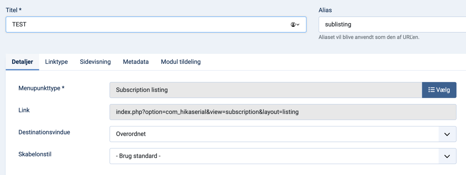

When creating a menu link to Hikaserial subscription listing, I get a 404 in the frontend.
I created the link with the alias: sub-listing, but the SEF url leads to: sub-listing/subscription/listing
If I remove /subscription/listing then the view works.
Looks like an issue with the routing of the view.
The non SEF URL is: index.php?option=com_hikaserial&view=subscription&layout=listing

  • Posts: 88
  • Thank you received: 20
3 years 10 months ago #343631
Maybe I didn't explain well enough. The non SEF URL was just the link you see in the backend. It was just for reference so you would know what view was causing the issue. There are no ItemId in the SEF URLs.
The point is, I have created a menu item link to Hikaserial subscription listing - but when I do, the URL gets redirected from /sub-listing to /sub-listing/subscription/listing and this creates a 404.

3 years 10 months ago #343649
Thank you for the screenshot, we will reproduce your setting in a test website.
