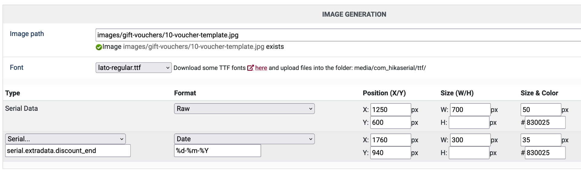

1. The HikaShop system has products that allow customers to purchase money off gift vouchers with a unique code generated by HikaSerial and attached to the email as a JPG voucher. I can print the code onto the voucher template and I also need to add the expire date. From the attached screenshot I tried to follow other forum posts but it is not entering anything on the JPG file. What do I need to change to have the expire date printed (which is 12 months form the created date).

1 - The configuration is a bit tricky sometimes.
Because you selected "Serial..." you are already in the "serial." section ; so in the input box below, you just need to enter "extradata.discount_end".
That value in the serial extradata is available if you're using the HikaSerial coupon generator.
If you're using the "time limited" generator, the extradata field would be different.
The best is to open a serial in the backend in order to see the extradata (which would be a timestamp for the value, so it's normal to see a "big" number).
