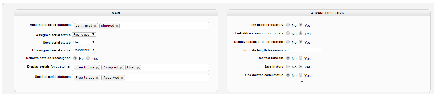

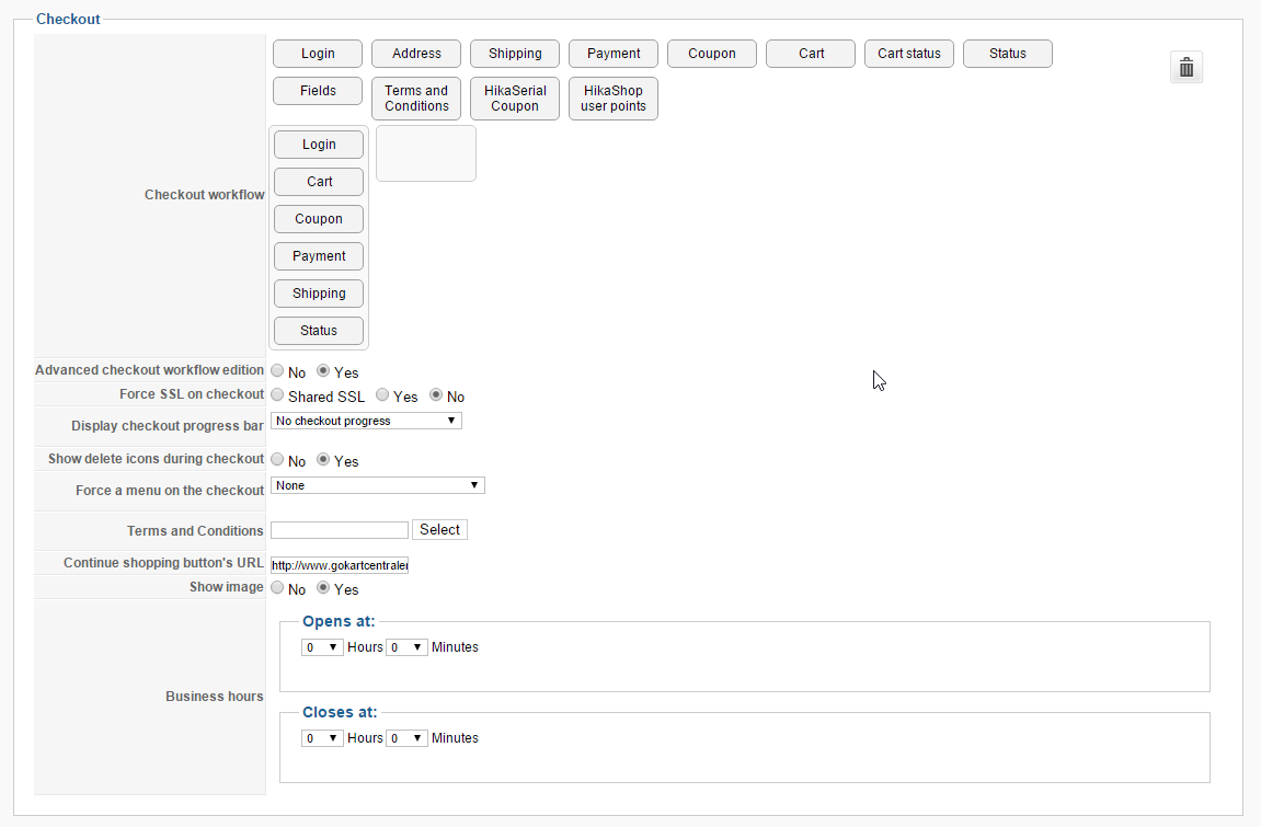

here is the hikaserial configuration
hikaserial
Pack
Checkout

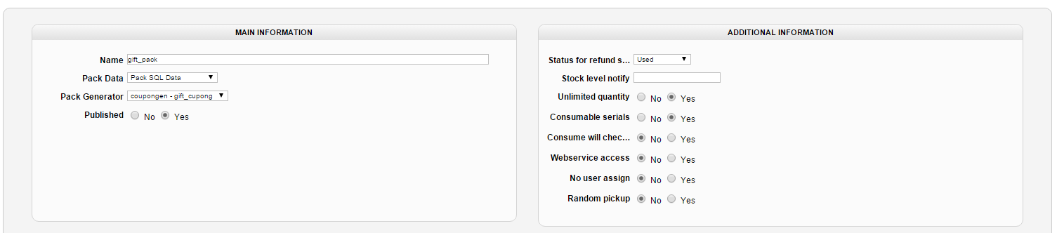

  • Posts: 26381
10 years 7 months ago #225177
Thanks for the screenshots.
The HikaSerial and the pack configuration looks good.
The HikaShop checkout looks good too but it has no influence on the serial generation.
I think that for the rest, best will be to have an access to your backend.
So we will be able to see directly the rest of the important elements to check, like your products, the coupon generator, and some of your sample orders.
You can use the "contact us" form to send us such kind of private information (with a link to that forum thread so the support team will assign me the message).

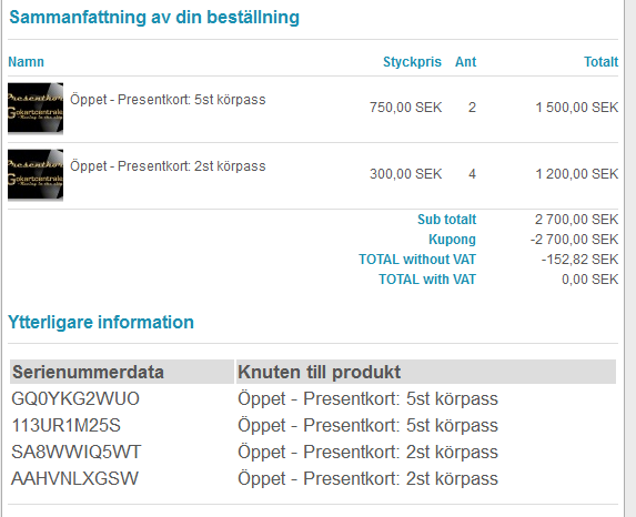

pasteboard.co/nG2Tiuk.png
Would it be possible to have some order number in your website or a clear explanation on how reproduce the exact issue ?
Please use "ID" as much as possible (product id), it will be easier for us than searching for names.

Deleted the serial pack from the variants of "Drop-in_pass" ( sorry that is the SKU the Client uses)
And created an order S3W87 you can also look at order S3X88
But still the same.
I think the reason it worked for you during testing is the total amount of serials to be created needs to be greater than 4 to reproduce the error.
Try again with 4 of one variant and 2 of the other and i think you will get a total of 4 serials instead of 6.
It seams to only generat the amount of serials of the greatest order so if I order 5 of variant A and 2 of variant B i will get 5 serials not 7 as in order S3X88.
