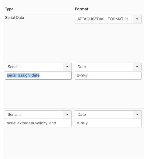

6 years 6 months ago #315730
I am making use of the "time limited" generator which generates serials with an expiration date, which I believe is is stored in serialdata validity_end. I made use serial.extradata.validity_end as seen in the attached image but it doesn't displays the date. The serial data and assigned dates are both working correctly .
Please assist!
  • Posts: 26381
6 years 6 months ago #315740
serial.extradata.discount_end
Is the code to access the value ; you can use that string if you do use "dynamic text".
But if you do use "Serial..." then you're already in the "serial" object so you do not need to specify it in the text field.
CF : www.hikashop.com/forum/14-hikaserial/892...html?start=20#280180
  • Posts: 2
6 years 6 months ago #315741
It works. Thanks.
