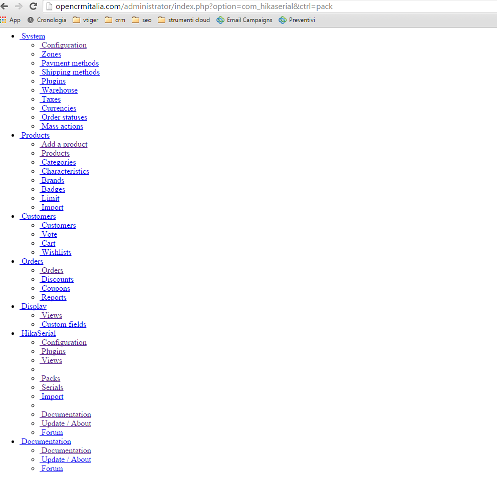

  • Posts: 9
10 years 10 months ago #216158
About packs I attach screeshot of what I see if click on paks.

  • Posts: 26381
10 years 10 months ago #216161
It looks like you have a PHP Fatal error in your pack listing page ; but I don't reproduce the issue in my local website or in the demo website.
Can you please check your PHP Error log or set the "error reporting level" to "maximum" in your Joomla global configuration in order to see the error message ? (which will be display at the bottom of the page).
About the serial ; it should be in a pack but if you don't have some, it could explain the issue.
I'll made a patch in order to fix that.
  • Posts: 9
10 years 10 months ago #216163
[Sat Oct 03 14:34:29.751515 2015] [:error] [pid 10776:tid 140378229327616] [client 88.147.8.217:51450] PHP Fatal error: Class 'hikamarket' not found in /home/opencrmita/domains/opencrmitalia.com/public_html/administrator/components/com_hikaserial/views/pack/view.html.php on line 184, referer: opencrmitalia.com/administrator/index.ph...hikaserial&ctrl=pack
