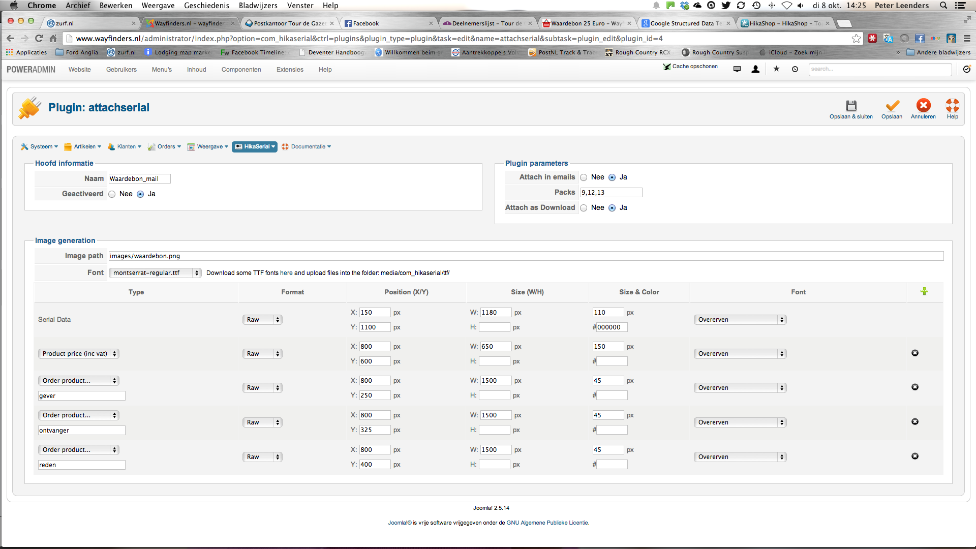

I like to use different fonts with SerialAttach. But wen I select an other font, SerialAttach will not use it.

12 years 10 months ago #126965
Please provide a screenshot of your attach serial configuration.

12 years 10 months ago #126969
Add a screenshot.

12 years 10 months ago #126974
Thanks.
I reproduce your problem and I will update the HikaSerial package as soon as possible.
Before that, you can fix the attach serial plugin manually.
Please edit the file "plugins/hikaserial/attachserial/attachserial_configuration.php" and replace the code
				$fonts = JFolder::files(HIKASERIAL_MEDIA . 'ttf' . DS, '.ttf');
				$default_font = @$this->element->plugin_params->default_font;
By:
				$fonts = array_combine($fonts, $fonts);
You will have to re-save your attach serial configuration with your right default font.

12 years 10 months ago #126995
Thanks, this works.
