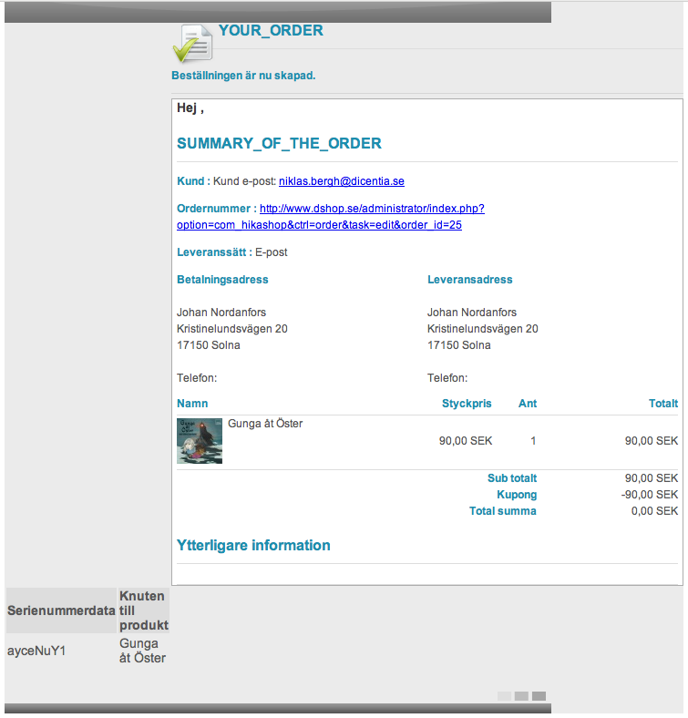

-- url of the page with the problem -- : www.dshop.se
-- Hikaserial version -- : 1.7.4
-- Joomla version -- : 3.1.0
-- PHP version -- : 5.4.6
The confirmation mail that is sent out to a customer when an order is confirmed looks strange at the part where the serialnumber (from Hikaserial) is attached at the bottom. Look at the screenshot for reference - bottom left corner. My question is, how can I fix it so that it gets the correct position and the same look as the rest of the mail?

The two text fields in the top section of the mail:
YOUR_ORDER and SUMMARY_OF_THE_ORDER I can not override because they can not be found according to joomla. Something seems to be wrong with my installation or configuration.
12 years 9 months ago #132287
For your HikaSerial question, please use the HikaSerial forum section.
Otherwise I won't be noticed that there is a question for me. The rest of the support team won't be able to answer to HikaSerial question because it is a product only supported by me.
The template in HikaSerial 1.7.4 is not more valid with the new emails for HikaShop 2.2.2
I am currently travelling for the Joomla World Conference so I can't update HikaSerial, as you can image.
For the moment you have to override the view "orderserial | show_email_notification_html " and remove
  <tr>
    <td>
and the begging and also
    </td>
  </tr>
  <tr>
    <td height="10"></td>
  </tr>
at the end of the view.
For the translations (which are at this moment HikaShop related questions), please check your translation file, I guess that the translations for "YOUR_ORDER" and "SUMMARY_OF_YOUR_ORDER" are missing.

Yes, this solved most of the layout issues, thanks!
I still have the text "HIKASHOP_MAIL_HEADER" at the very top of the mail. Any chance you could help me with that?
12 years 9 months ago #132452
It is a missing translation in your HikaShop language file.
