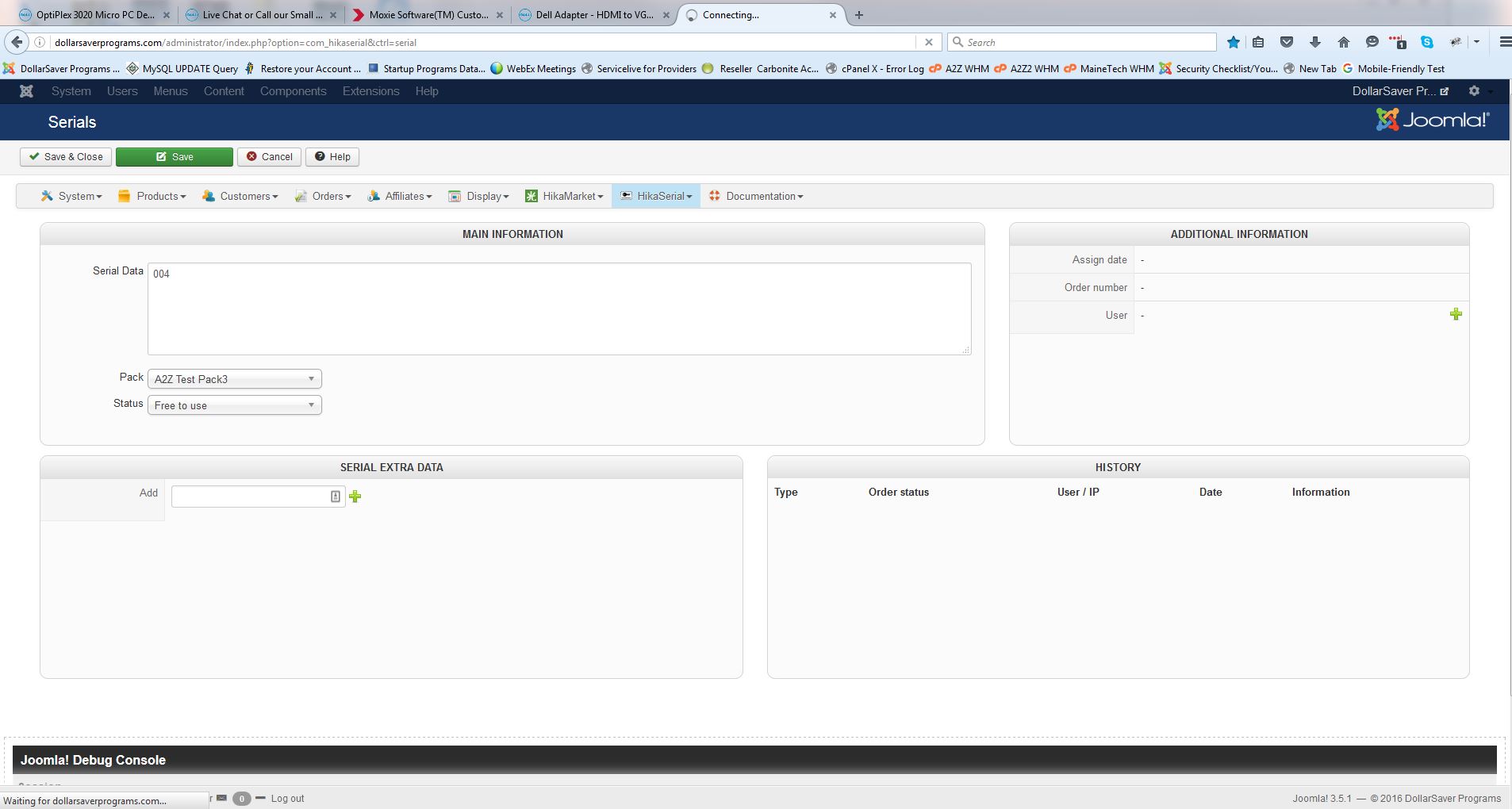

Ok, step by step, what I'm doing:
1. login to the Administrator
2. Went to Components/HikaSerial/Packs
3. Clicked "New" and added a new pack.. Using "No Pack Data Provider" & an available Vendor. Left all other settings alone
4. Went to Components/HikaSerial/Serials
5. Clicked "New" and added/typed a serial number (004) in "Serial Data", Chose new Pack from drop down, then Save & Close
6. At this point the system hangs and the wheel just keeps spinning and status sits on "Waiting for (site)
Please see attached image
10 years 4 months ago #238282
